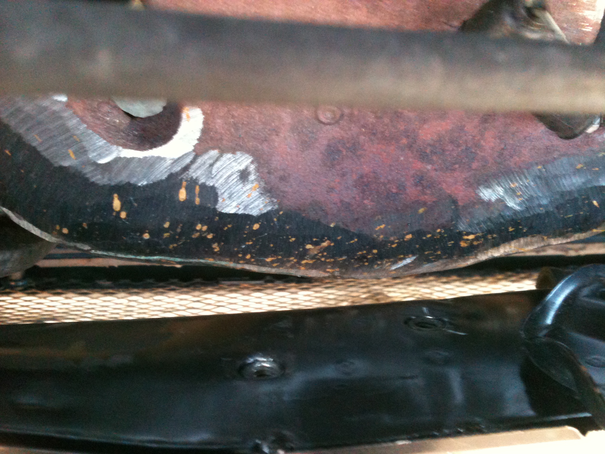

Ecu turned up on tuesday but not had time to get anything done apart from taking the manicat into work and grinding loads more off the front off it due to it being so close to the front panel and when it is in place its exactly where the mounting bracket for the radiator bolts to the front panel so needed more clearance and didnt care if i screwed the manifold up as its only being used just to get it running and not too loud to annoy the neighbours!!!:rolleyes:

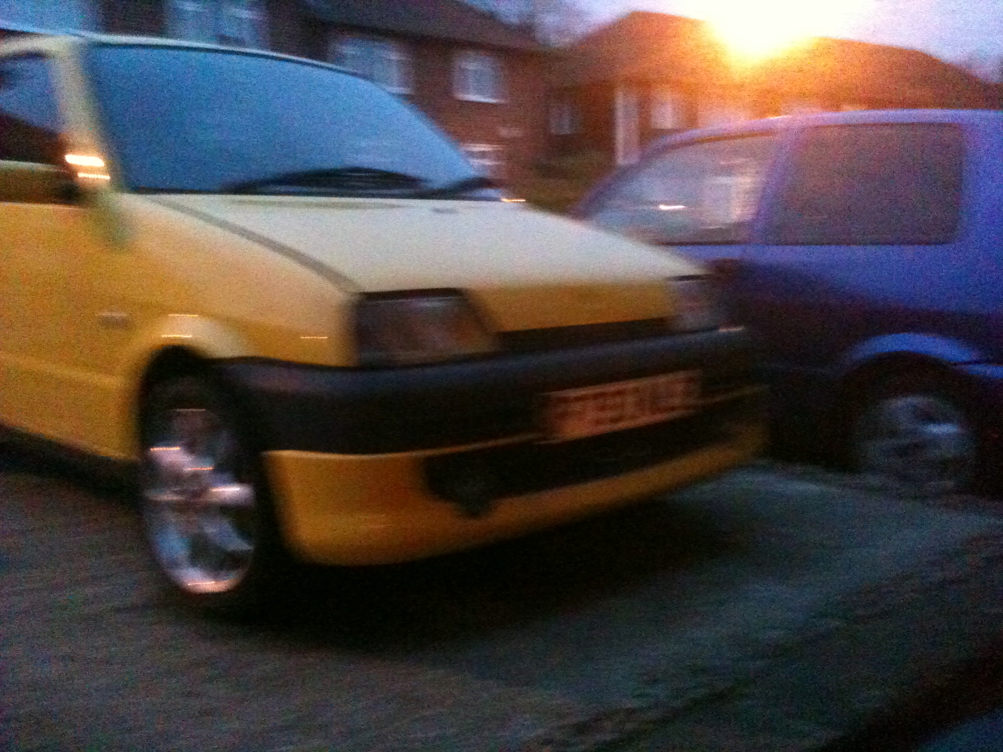

This is how the cinq stands at the moment but its only put in place loosely :p

on the up side i have gained the clearance with the manicat to front panel,just shows how much excess metal is on there (y)
