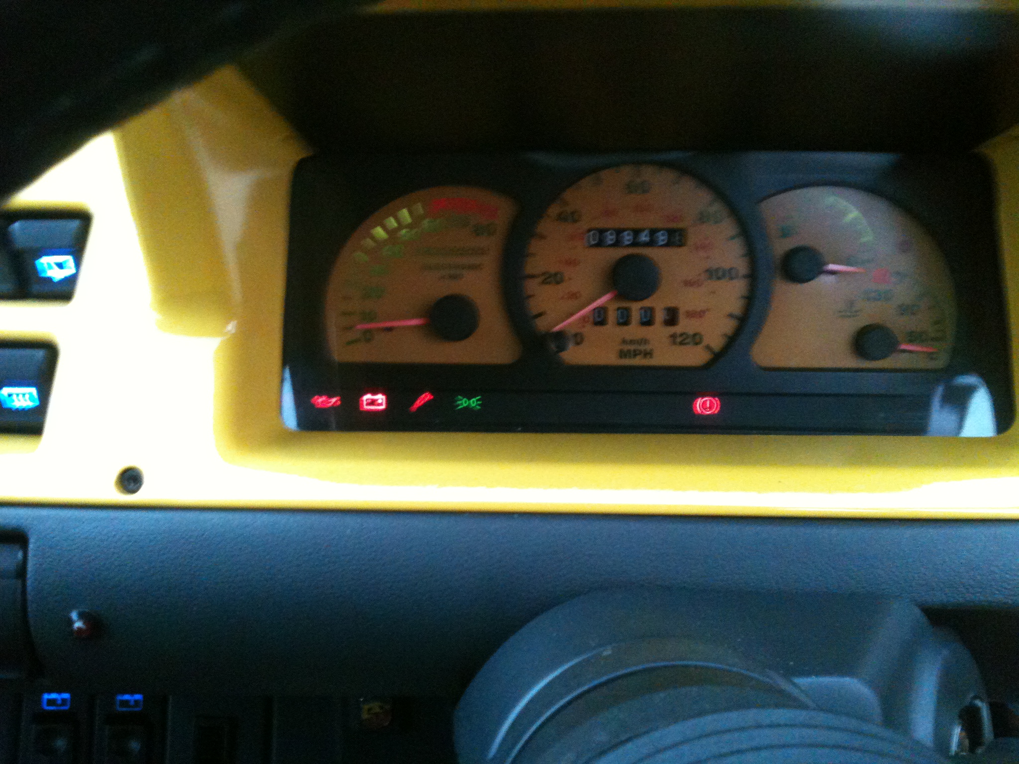

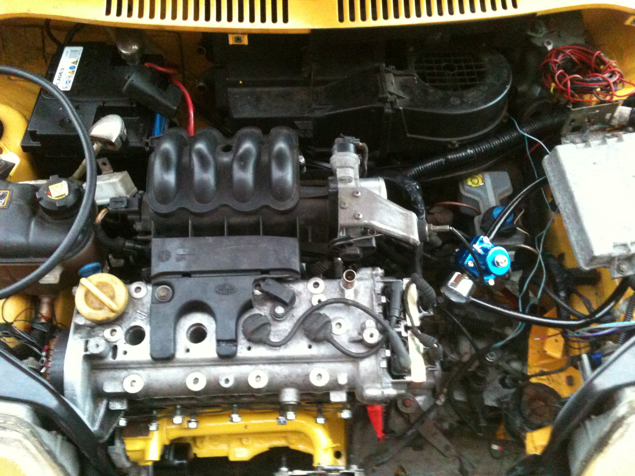

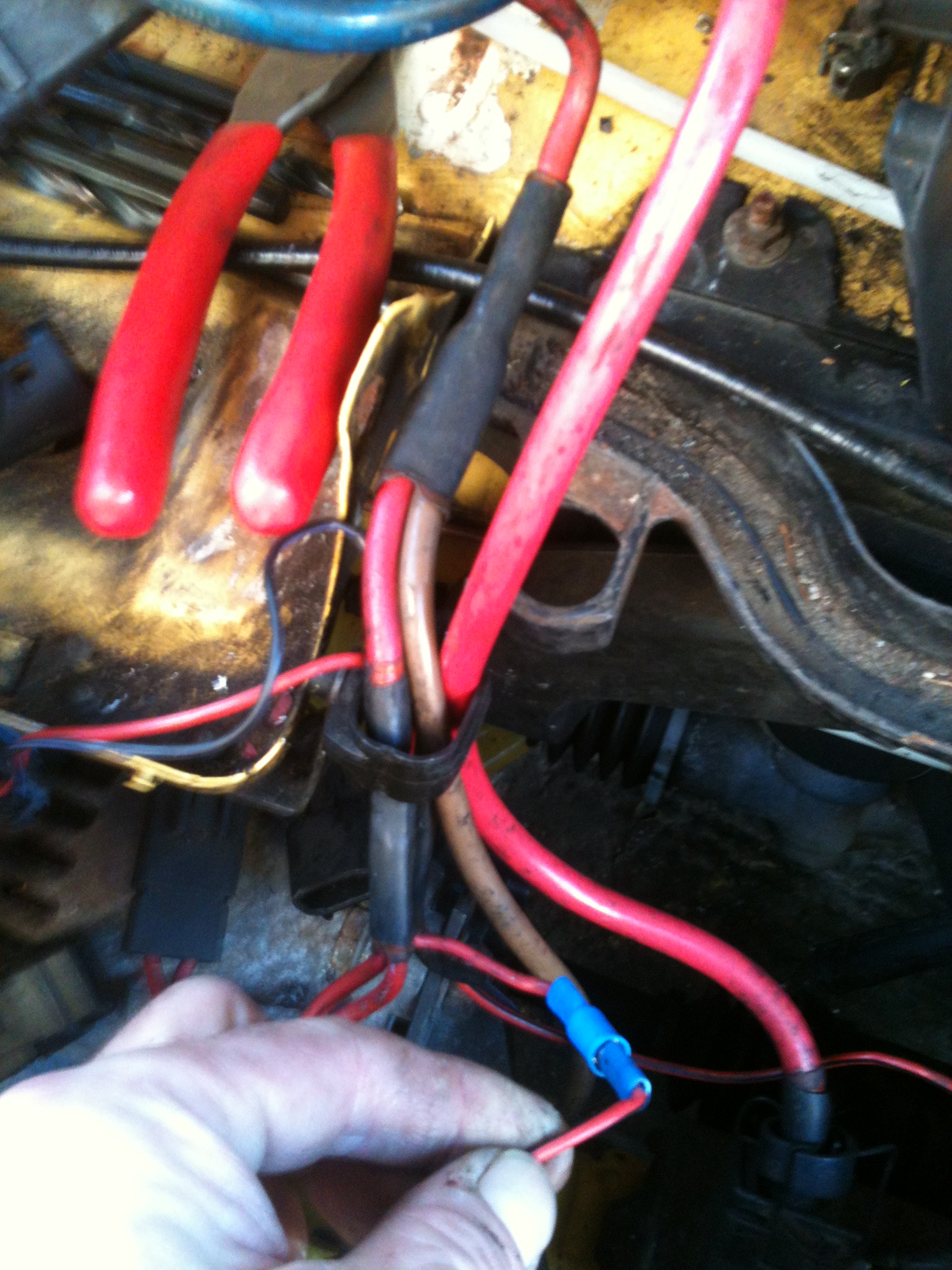

as per other threads i connected it to the thin red lead that goes to the battery and now u can see i have all electrics in the car now and i have just got the inlet bolted in place and tomorrows plans are getting the cooling system sorted and make any hoses that are required and any other silly bits i can find when i out there :D:D
the last pic is where i attached the punto red/black wire to which goes into the battery loom(y)

am glad, so all the dash light is working as it should :).
Be worth while starting the car before you put water in there! Is much easy to work on it without all the radiator hoses!

Dont worry ming thats going to be done first but i still have to drill out the bolt for the gearbox earth on the inner wing!!!! and got to get the correct fuel line connection from the scrappy otherwise i cant connect the fuel line as its got a push in connection not just put the fuel line on like with the spi;)

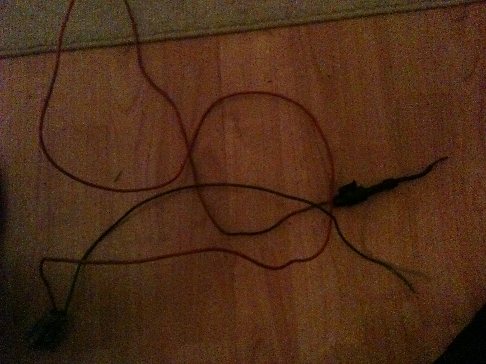

@ ming OK I have finally figured out where the missing bullet connector has gone to i had already cut it off the cinq alt/starter loom as it said punto red/black to cinq red bullet under the battery tray..... well i just checked on the imola blue cinq and the bullet is actually under the back left of the inlet manifold and goes into alt/starter loom so is exactly the same as how i have wired it just without the actual bullet connector so all cinqs do have them:eek::eek::eek:
here is my bullet connector on the lounge floor at this min lol

am glad you found it, i would keep the bullet connector tho ? So you can remove the loom quickly if you ever need to instead of cutting the wire up!

have a look at the last pic in post 322 and the blue connector i put in cause soldering iron packed up is the point where the bullet connector should be so its still a bullet connector but of my own making(y) when i didnt really need to cut the original off:bang:
