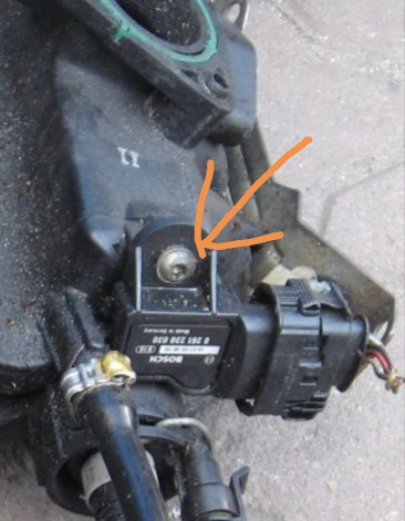

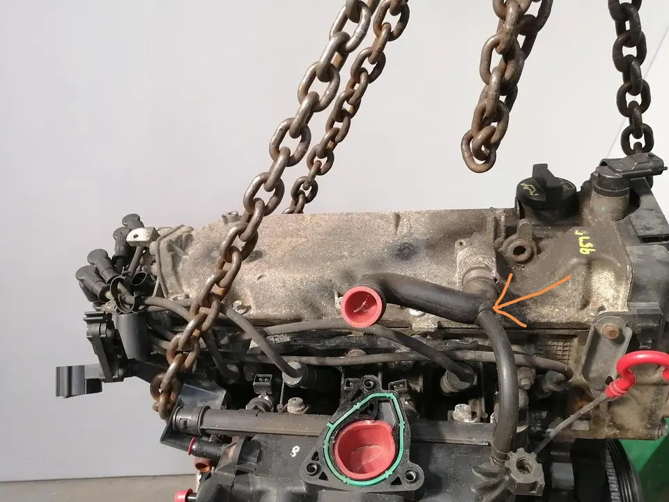

I would try carefully cleaning the MAP sensor and inside the inlet manifold. We have episodes with our 169 and this is teh biggest factor in the cure. Check the larger bore crank case breather pipe too . It has a flame resitor in it that blocks and this wont help. Mine is a 1.2 so not quite the same but the issue is likely similar. If you could get a diagnosis with MES it might help
I'm not sure what those parts are and can't find much online to figure out where they are. But if I appreciate the help and I'll see if it works

Breather pipe
MAP sensor
I am not sure which black inlet manifold is fitted to your engine
The part is identical but some are fitted to the right hand end, some on the left
I think all cable throttles are to the right of the throttle body,
