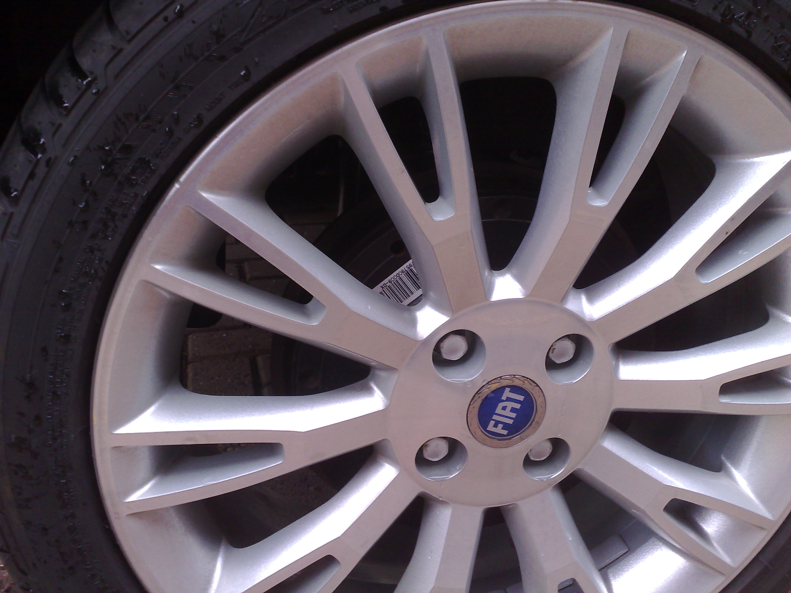

I think its def a sporting, maybe it was just mis manufactured, and thats why its got drums and not discs. I dont really care about the seatbelt cos i just wont carry 5 ppl :p I will be asking the dealer about the drums for sure, if possible i will ask to get them changed to discs. The front dicks are the big sporting ones and not teh ones of the lower models! i have attached some pics below

I wouldn't worry too much then if your not fussed, maybe you could just ask motorpoint to pay or contribute to rear discs been fitted, worth a go anyway. Could get a letter from a dealer saying it should have them and show it motorpoint. Looks very nice in the photos.enjoy!

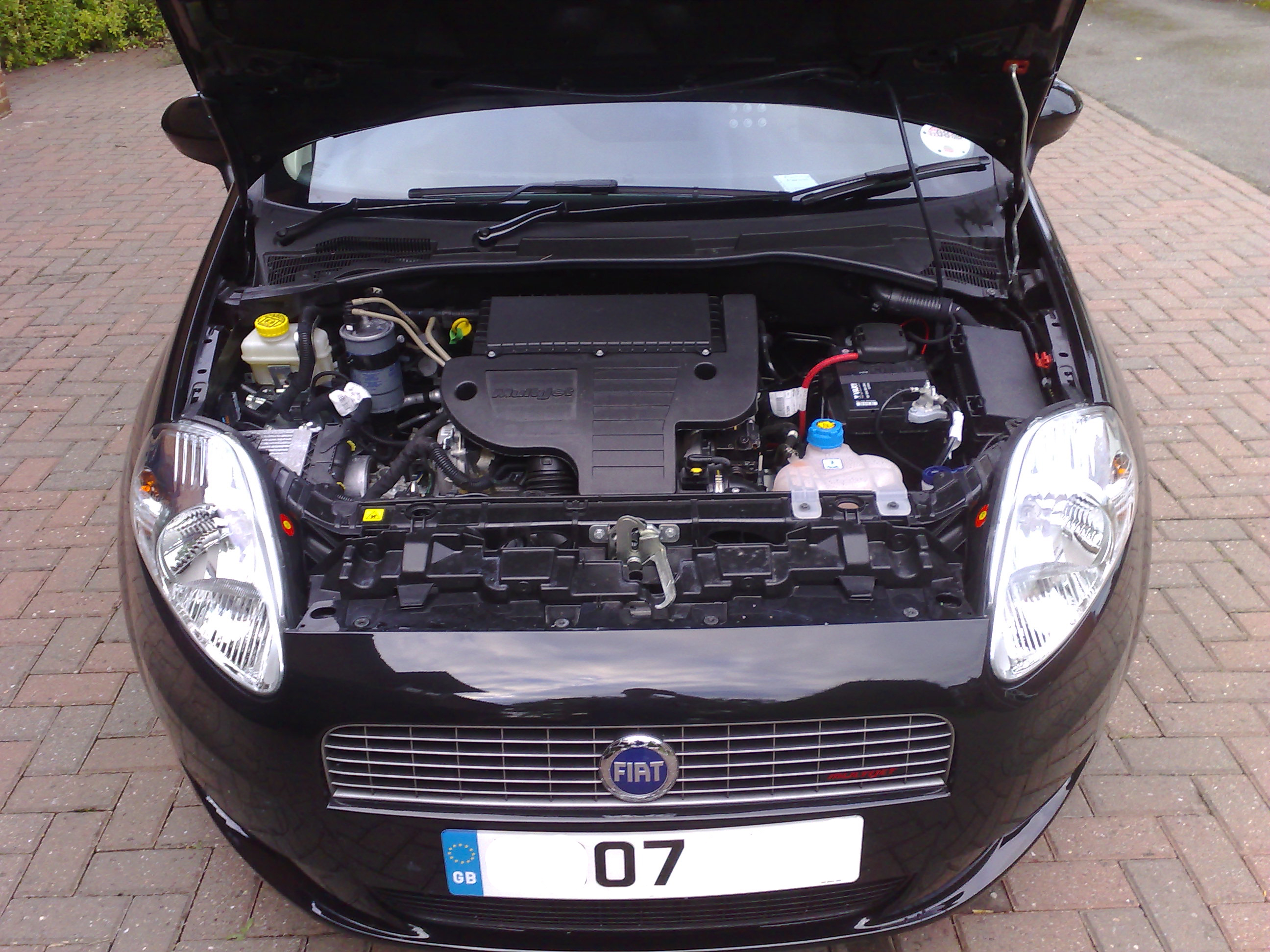

that is not the same engine as the one under the bonnet of my 1.9 sporting! The ECU is in the wrong place (should be on the bulkhead behind the engine, not to the front left) the dipstick is in the wrong place, so its definately a different block to the 1.9...It also doesn't have the 'bosche' (spelled wrong?) ESP unit under there either..... so no ESP, So I don't believe its a UK model........ Take it to a dealer and get it checked out... so 100% sure this is not a UK spec 1.9 sporting..... maybe an Irish spec 1.3 sporting...... certainly needs defining..... very interesting problem..... keep us updated let us know when you eventually find out what it is!

could you post up a pic of your engine bay for me please! and yes it has a 6 speed, and it has asr off button on dash plus hill holder works!
you can see the air box and airflow meter on the front left (where your ECU is)
my ECU on the rear bulkhead behind the engine, my dipstick at the front (yours is at top left) and the ESP unit behind the battery with the bosche sticker on (metal cylinder) ....
hope this helps, completely different engines.... defined beyond doubt by the different place for the dipstick, this means a different block and cylinder head....

sdit to my above post about ESP.... I can't actually see behind the battery pic you have put up... but still never heard of ESP on a car with drums on the back, didn't think it was possible, but it may have, if like you say, it was a mismanufactured car..... or an import....

OK so I've got it.......if you look at a picture of the metal plate and look at the 'engine code'......then go to your handbook to page 214.....you will see that
engine code 199A3000 is for a 1.3 90bhp diesel unit.

looks like you have a unique car fella, a 1.3 90bhp sporting! quite cool if you want to be unique ;) if you remap it, it will go to 120bhp, so be as close as makes no difference in performance to the 1.9 diesel (y)

this is my idea... I believe they have sorced a punto sporting diesel from Ireland (which only comes in 1.3 m/jet flavour) and registered it , and sold it, as a 1.9 sporting, (as sporting diesels in this country are only available as a 1.9 m/jet) ..
I believe it is a genuine car, no mistakes ect in manufacture, but it is an Ireland spec car, not a UK spec car, but has been registered as a UK spec car......
