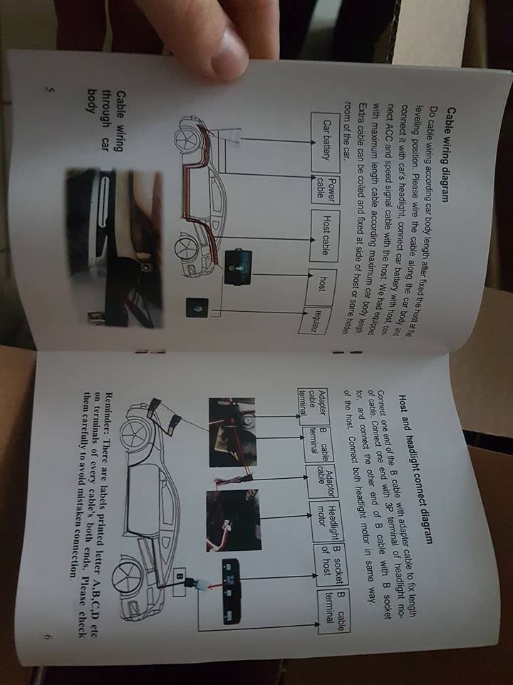

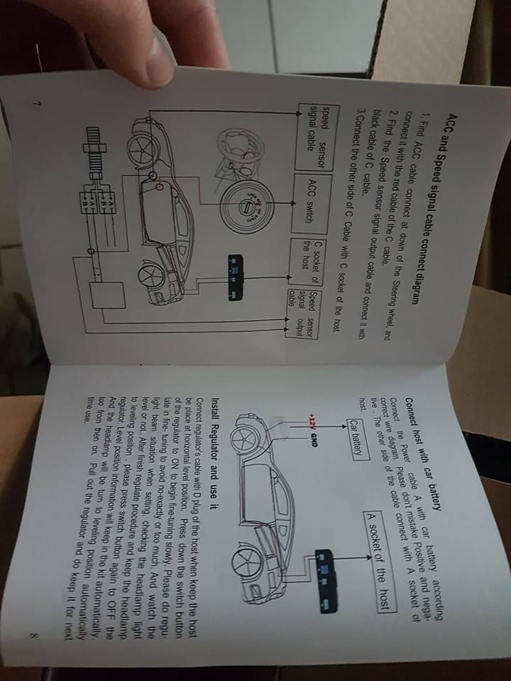

Hello,
I come to you because I acquired a kit bi xenon homologated (ie with automatic leveling, washing headlight and the reflector for xenon)
I have a problem with the corrector, he asks me to connect it to the speed signal wire "Speed sensor signal cable". Where to find it? On the ECU?
I take a parallel abs sensors? (ECU uses abs sensor on the left side wheel speed)
My engine: 1.9 JTD 115
Thank you for your help
