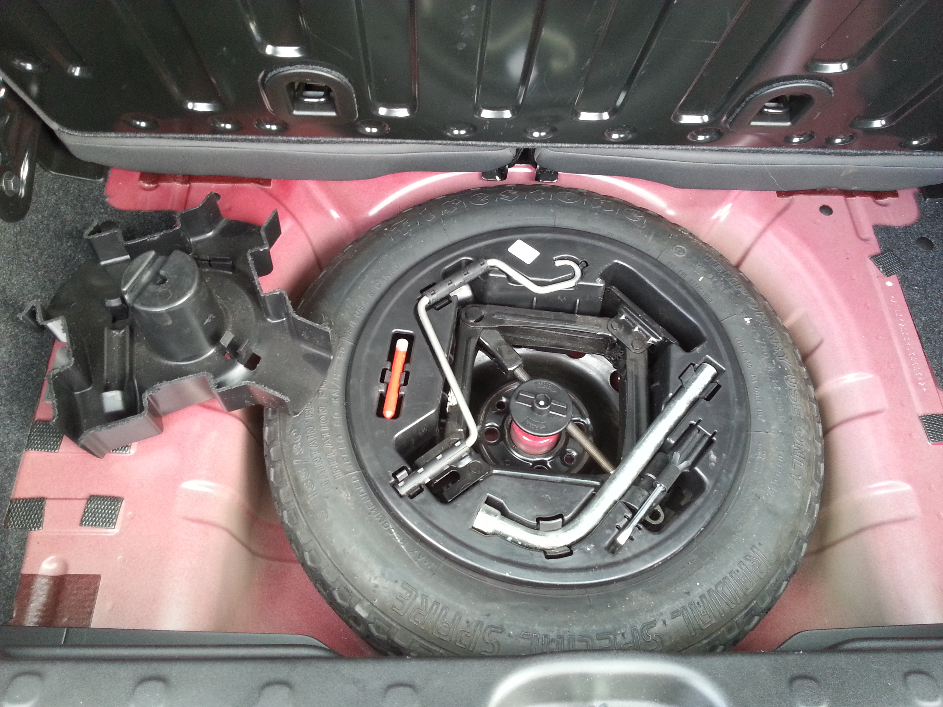

Anyway back to the fitting of the wheel. It went on perfectly no rubbing on the calipers etc so the £13 bargain worked a treat.
Now for the Jack set. This is the plastic moulding that the Jack, wheel brace, screwdriver etc sit in that go inside the wheel and screws into the bottom of the car.
I see the cheapest on ebay for a 14" was from a Fiat Stilo delivered for £19.50. This arrived Wednesday and went to fit it in the wheel that was in the boot. The moulding was about 2.5 inches to high so that the mat wouldn't sit flush in the car. So what I did was with the trusty hacksaw cut the bottom of the moulding of by approx 2.5 inches and now its slotted flush into the tyre and I now have the full set of spacesaver wheel and jack set for £32.50.
The pic below shows the wheel in the boot and the piece I cut off so that it fits in. HAPPY DAYS!!

Brilliant,thanks,I was just about to ask what spacesaver would fit the latest Panda and you have answered it. Fiat £300! At least Dick Turpin wore a mask.
