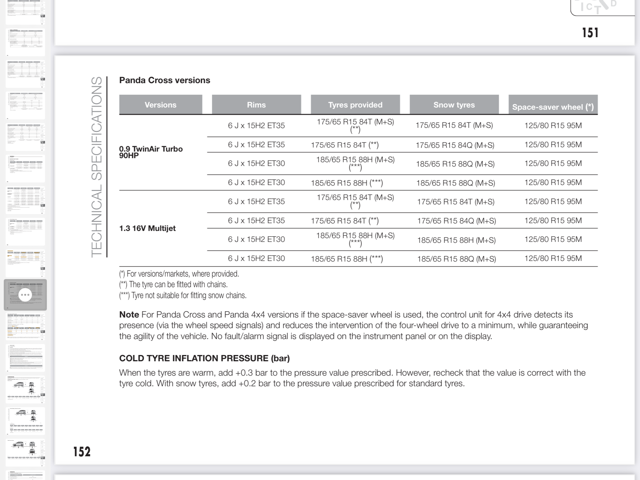

I am looking at getting a spacesaver wheel and tyre for our 2015 Panda Cross
the tyre will be 125x80x15 so as to fit in the boot but the offset of the wheel is ET 20
the normal wheels are ET35 offset with 185x65x15 will this offset be ok

No update from @Phil R whether he sorted his proposed spacesaver purchase and “ET20” offset query for his “normal” wheels “ET35 offset with185x65x15”, but I notice on p152 of the February 2016 edition Owner Handbook (attached below, assuming this applies to the 2015 model), that the 185x65x15s are in fact listed as “ET30” (it’s the “175/65 R15 84Ts” that are listed as ET35).
Also, p152 clearly states it’s the same spacesaver tyre spec for both wheel/tyre sizes (i.e. “125/80 R15 95M”) across all Panda Cross combos with no mention of differing ET values (wouldn’t the Handbook state if that was not the case?).

The current Panda is model 312 - but often, wrongly, called 319. (The VIN numbers all start ZFA312… )
The ET offset is relative to the wheel width, so the narrower spacesaver has a smaller ET value.
Cross models use a different offset as originally (when all Cross models were 4x4), they used a wider tyre (185 section) than all other models. Although now all supplied with 175 summer tyres, the wheels didn’t change.

So, IIUC, the OP was correct with “ET20” for the space saver. And the spacesaver for both the 4x4 and Cross is exactly the same (as are the 15” road wheels+tyres - confirmed in the handbook), so the spacesaver in my 4x4 (shown in the pic attached to my previous post) is the one he needs to get.
