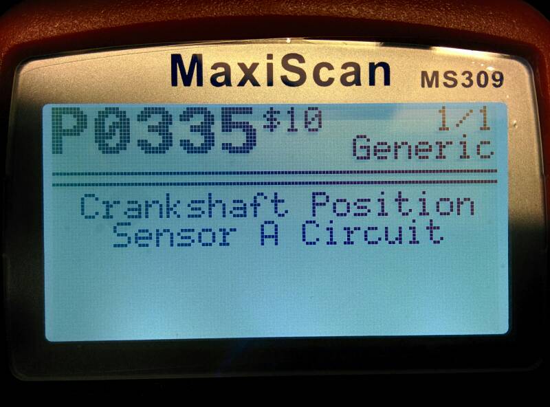

Yes throttle to start, lost ability to idle, engine management light on when you try and start it came on when it cut out, but is of when I get her running, running on all 4
Ok so she started and ran fine for me to move her forward and reverse here in to the garage. gave it a wipe with a cloth.
Will wait for the reader to arrive to see what it throws up.
mmmm, sounds even more like crank sensor if it worked fine once it had cooled down.. If you have had an eml come on and its the crank sensor at fault it will normally be reporting a misfire or coil issue rather than crank sensor. Although on few occasions i have seen them report crank sensor but car tends to not run at all which i think is is the sensor is sending ecu a constant signal rather than an erratic or just no signal.
Got this ?
