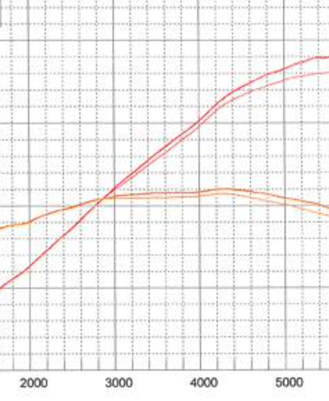

Look through my old post on tuning, I posted a back to back rolling road of a 1.2 on a rolling road, standard exhaust then straight through no catalytic converter full race exhaust, about 4HP only at 6K rpm

Heres a full decat so not road legal, each vertical line is 4bhp so nothing that could be felt and in all honesty it within the tolerance of the rolling road, even worse these power runs are at full throttle

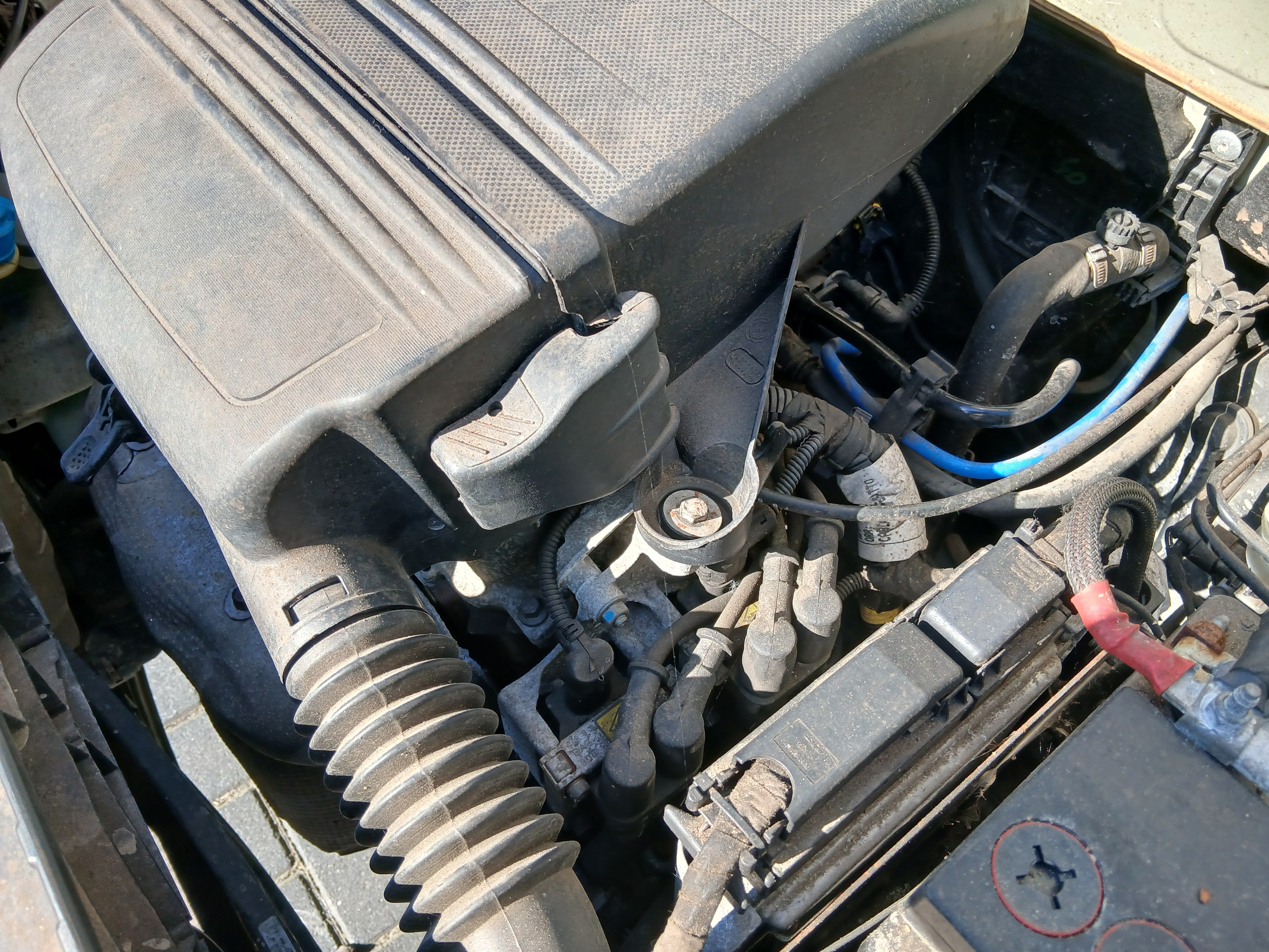

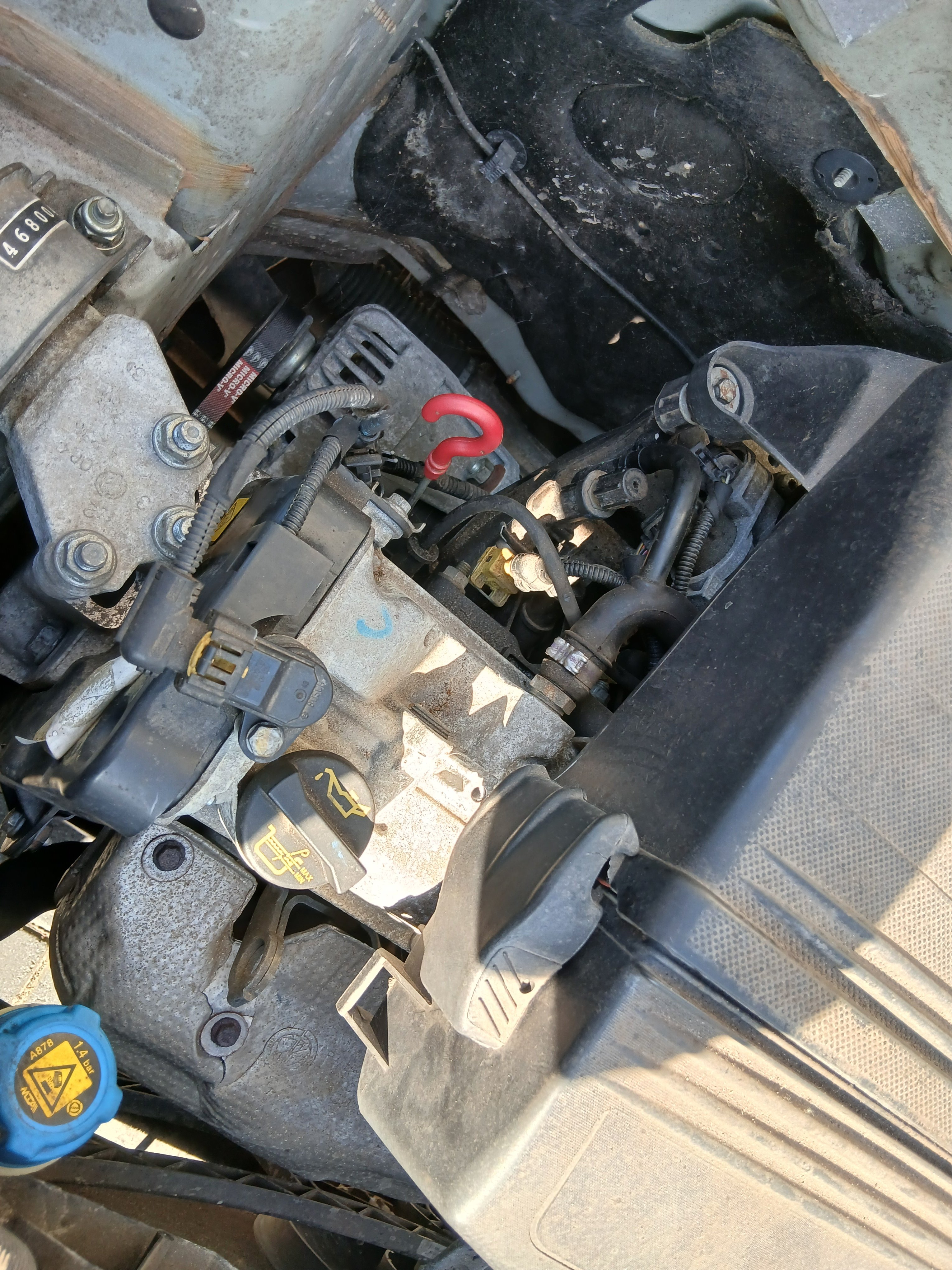

Here 2 images of my engine, and silly me, looked underneath the airbox and there it was, the cable from accelerator to throttle body .... ☺️
The graph says it all. No problem, then I know it is a no go and I will enjoy the quiet, smooth running culture between 1500 and 3500 rpm and I got some other things to think about, but that is for another topic
