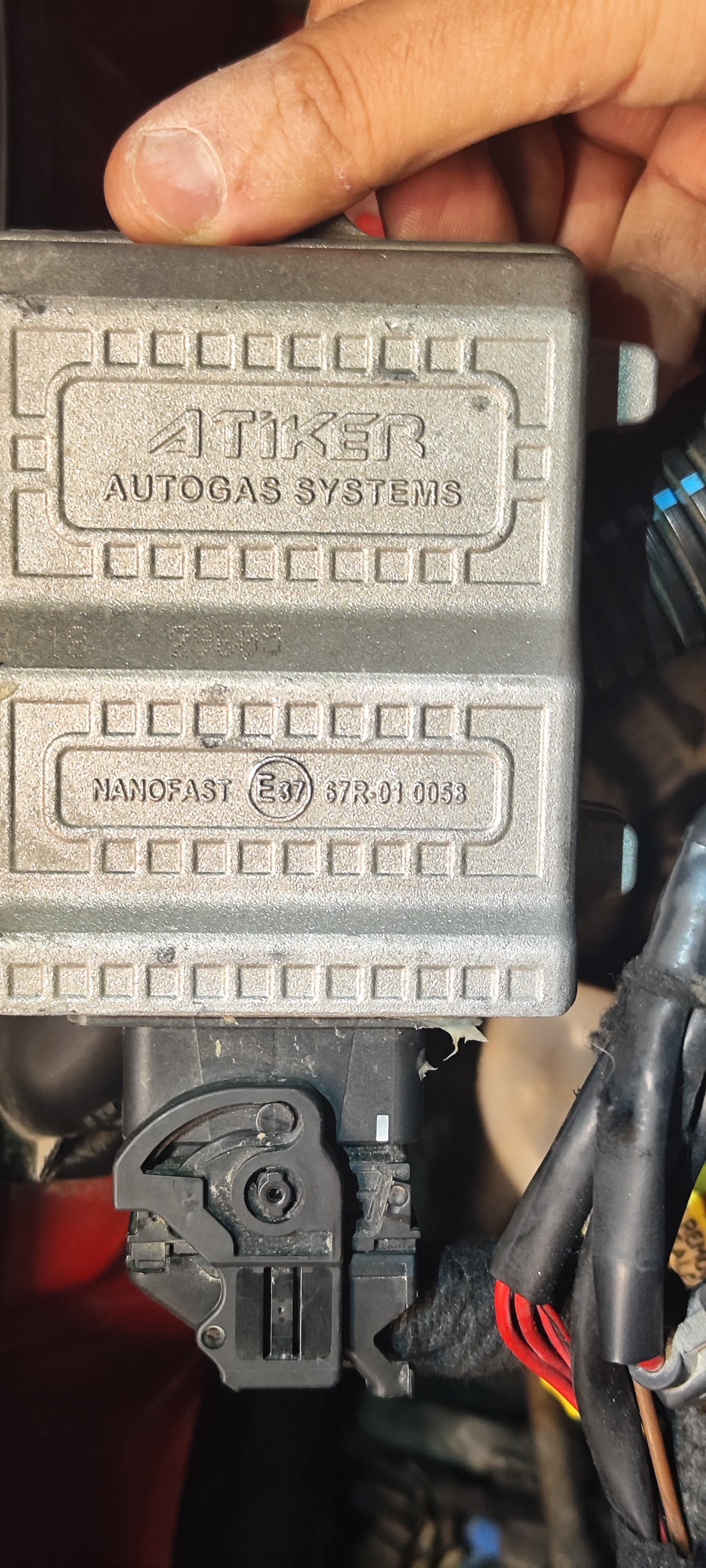

But does the LPG system have a separate ECU? And can we access that via the car's OBD?
gr J
Lpg system has a separate ecu.
From injector timing to fuel quantity. It has parameters that allow you to adjust how much fuel you want to inject at what temperature.
Although LPG adjustment is not very difficult. If incorrect settings are made. It may cause heat damage to the valves.
That's why I don't intervene with LPG until the vehicle runs completely on gasoline.
I've never adjusted LPG before. But I want to master this subject in the future.
It has its own ecu socket and software. Settings can be made from the computer.

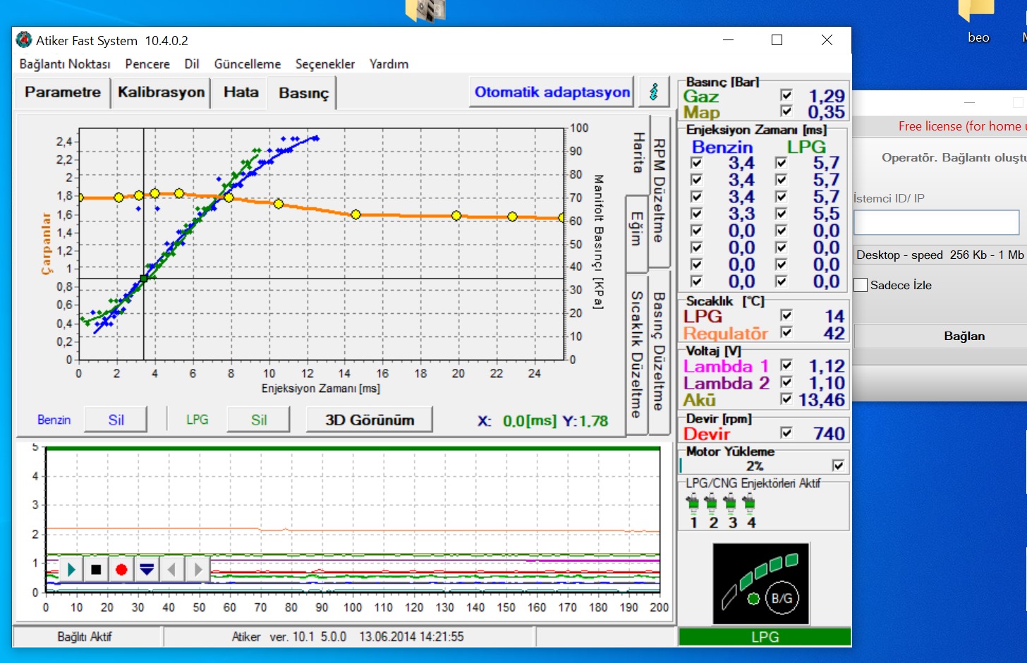

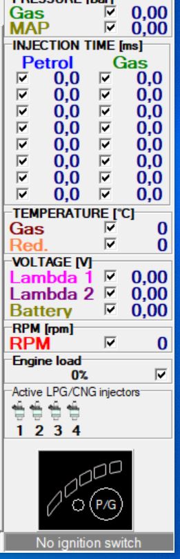

Apart from this, I bought a communication device for LPG.
I can run tests where I can turn the LPG injectors off and on one by one. Nothing changed.
The LPG circuit determines its own map by looking at the map and injection time. In fact, in advanced settings, the user can view the table with fuel trims by looking at the ltft stft settings.
I don't know if I can use this data to detect malfunctions or perform tests, I have this in mind.

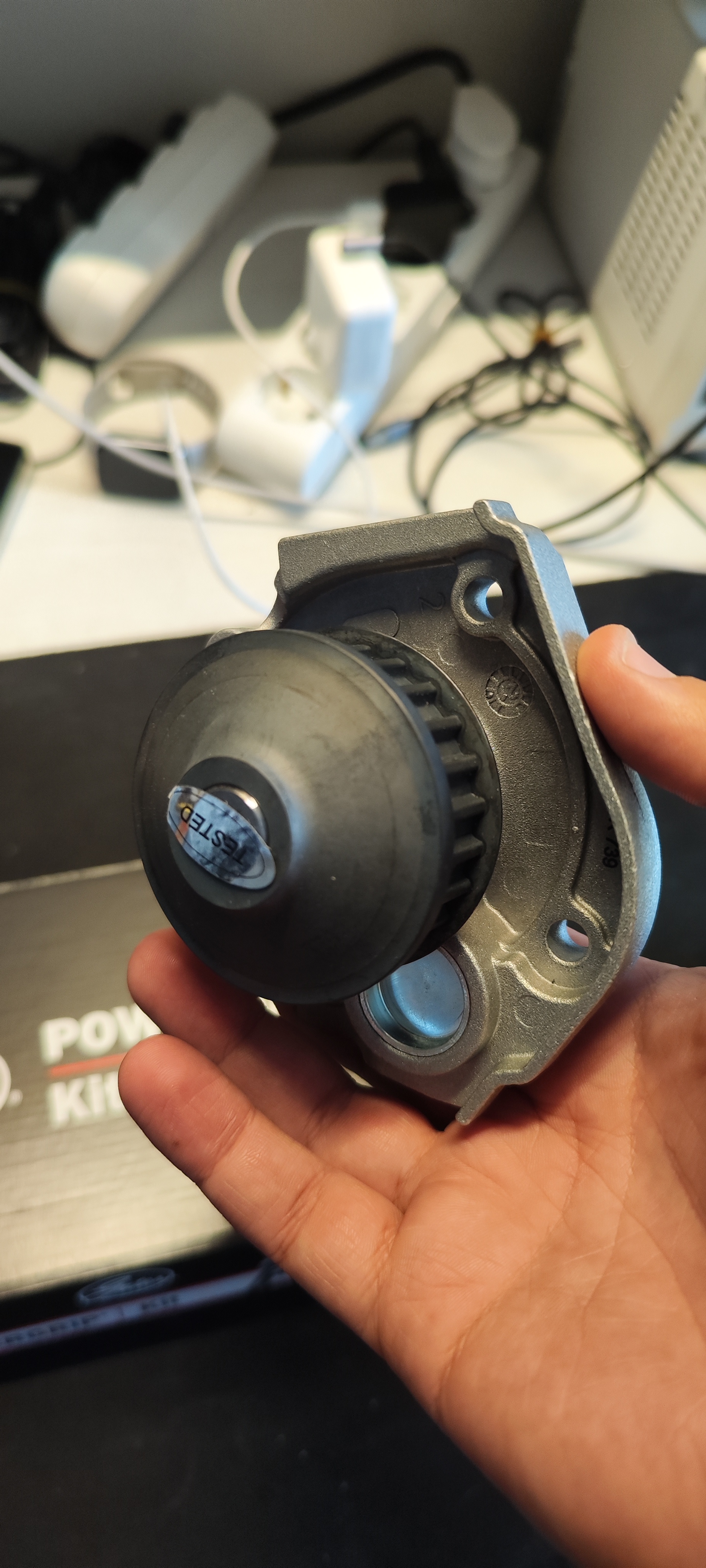

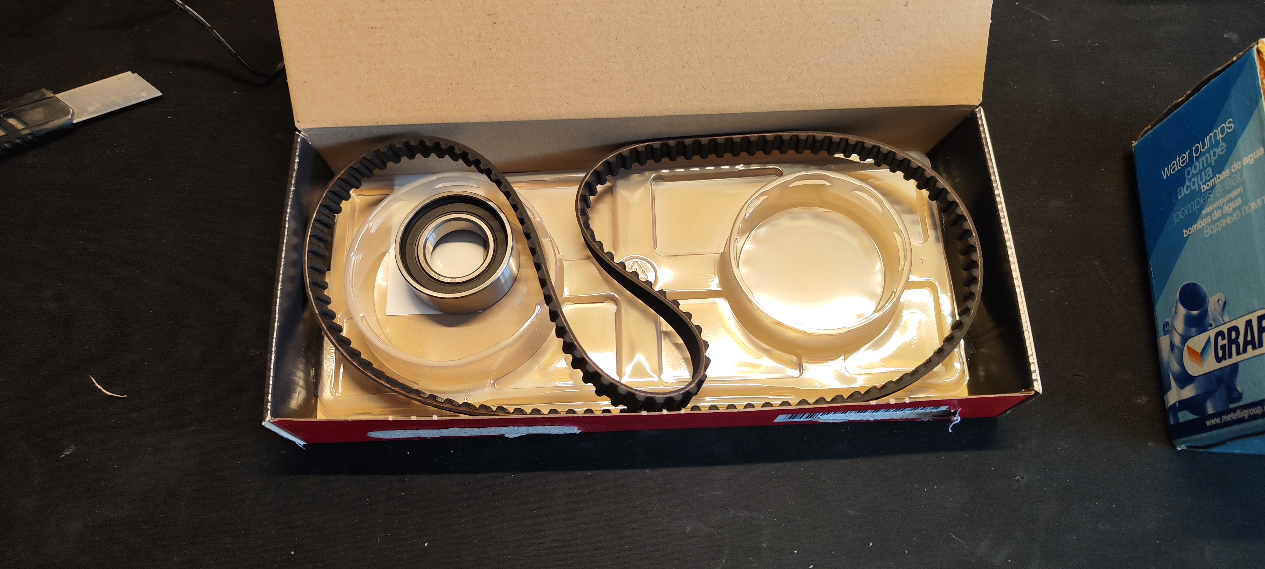

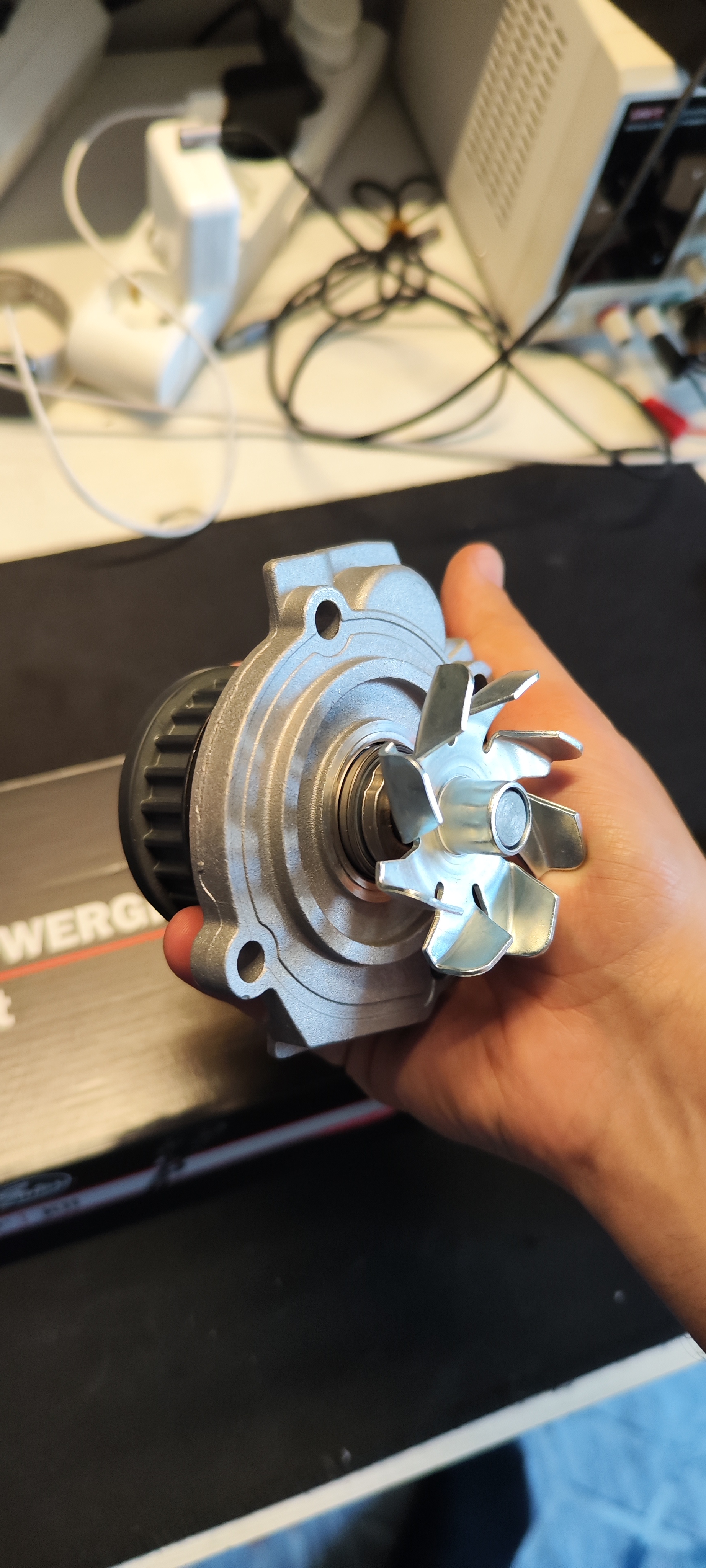

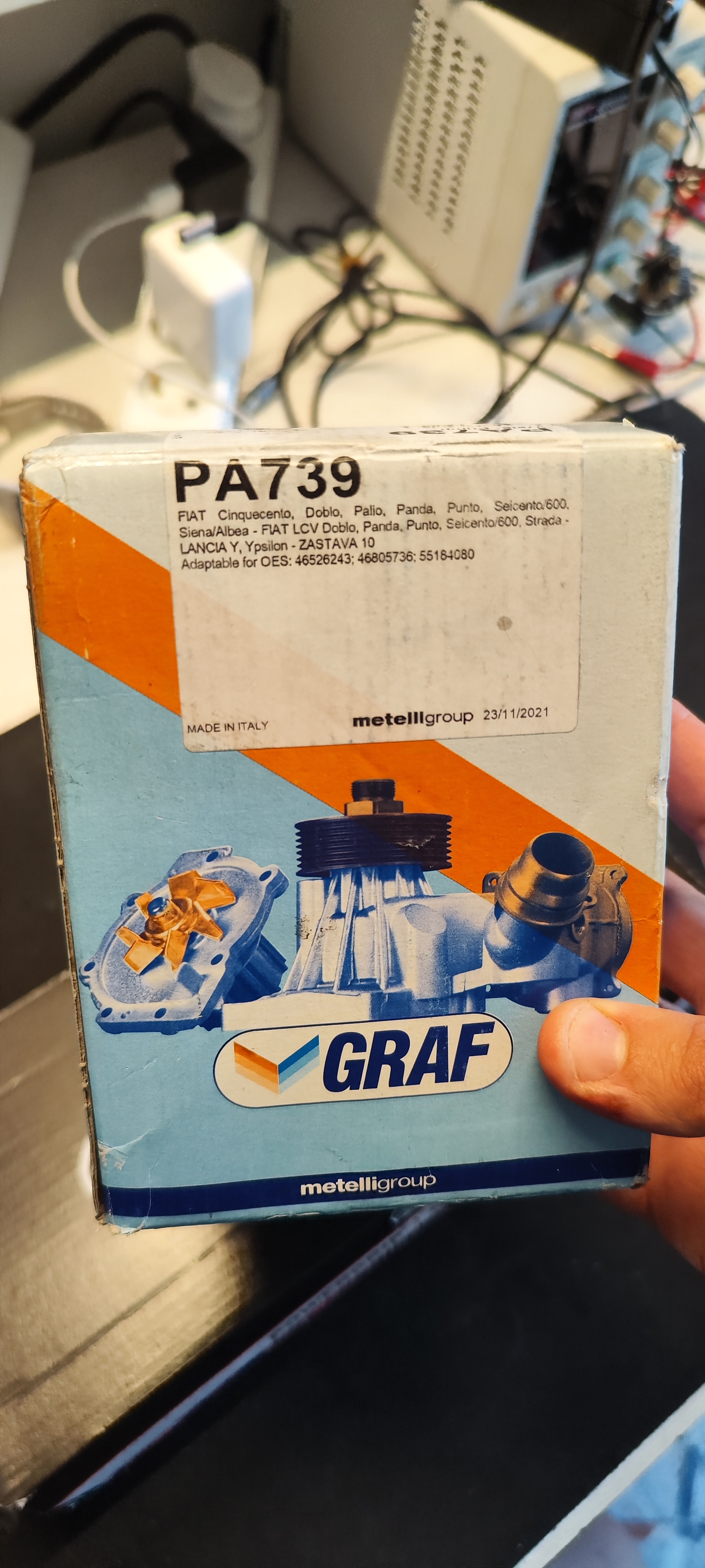

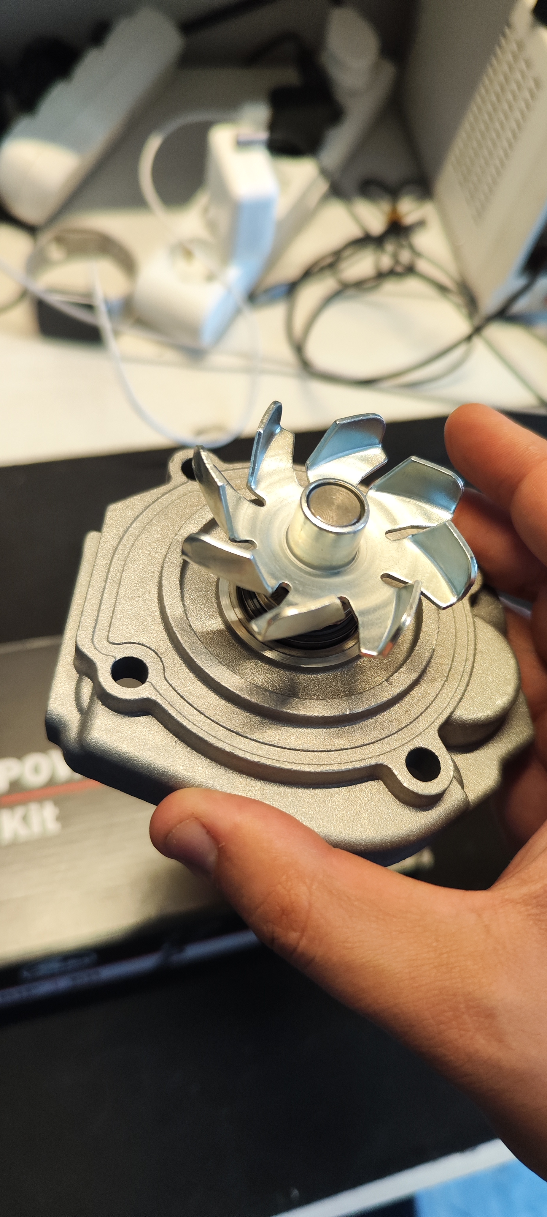

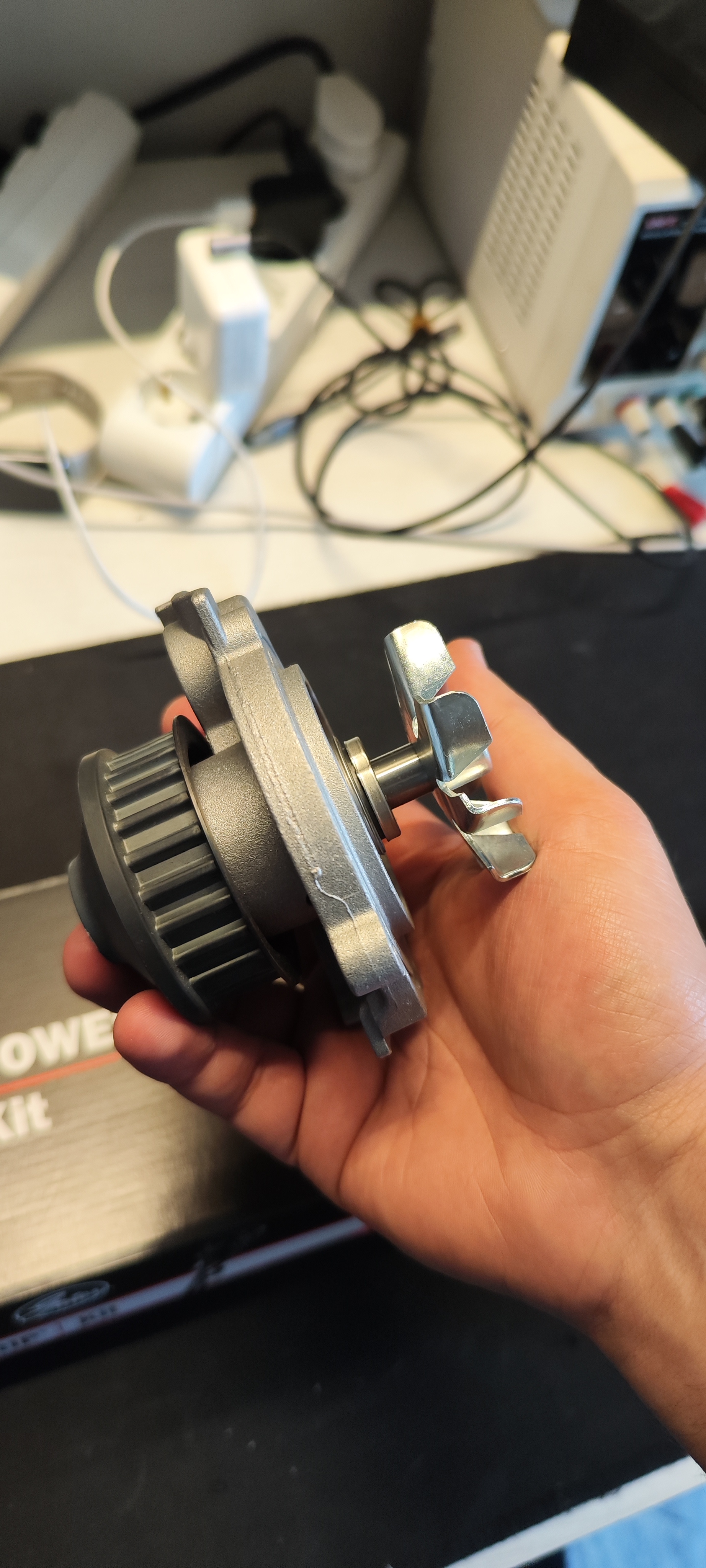

Did the seller recommend this as a circulation pump? However, the propeller structure seemed too small to me. Also, the fact that the propeller is metal means it can rust. I think the original is plastic.
Does anyone have a picture of the original pump?
Also, are there any other pieces that come to your mind?

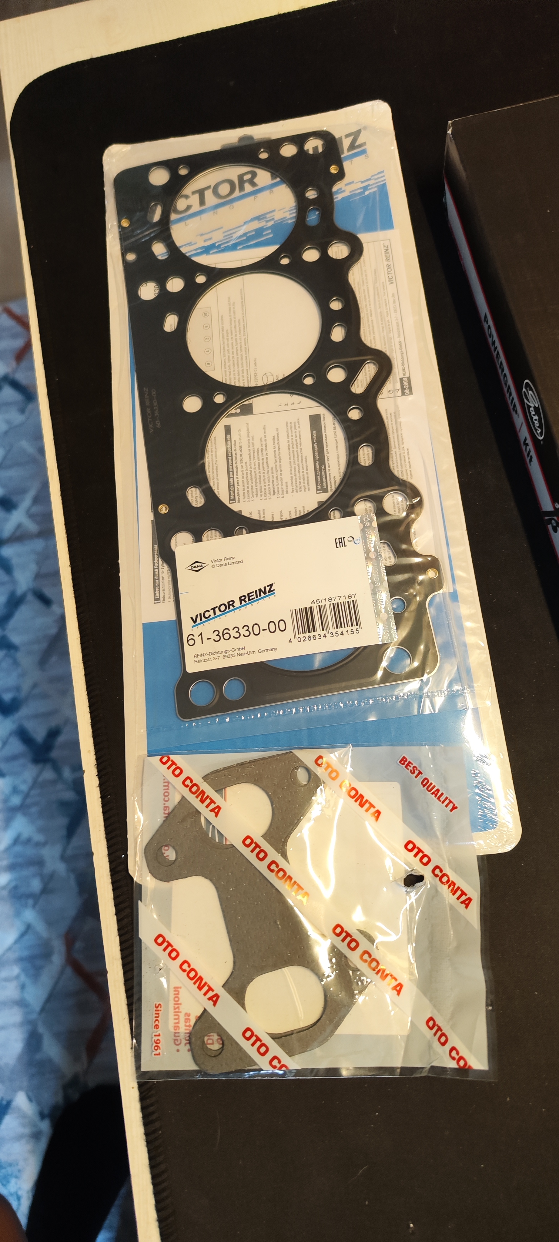

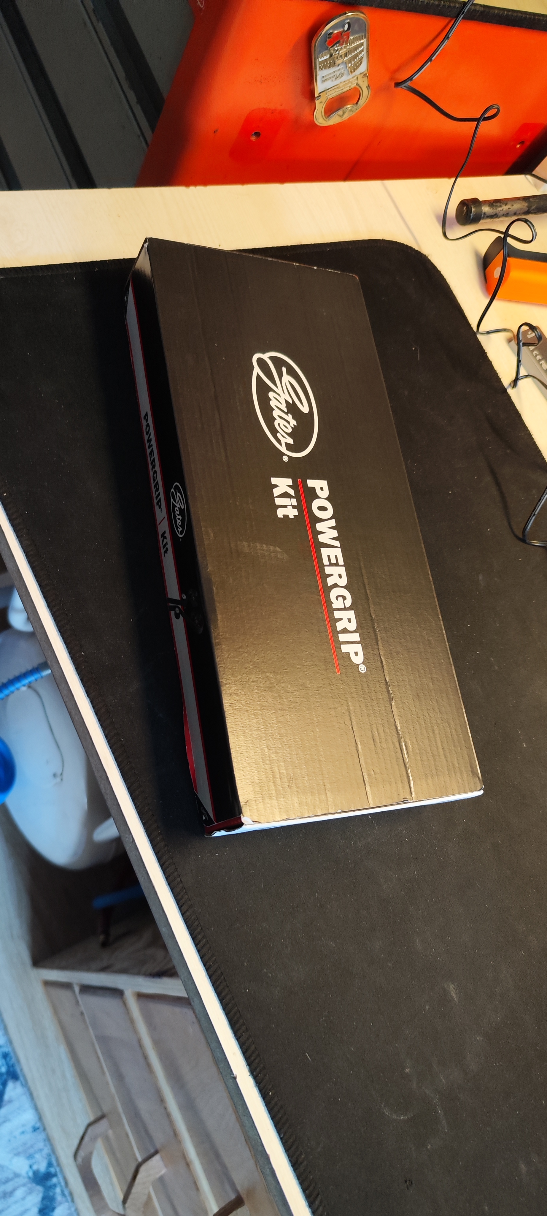

My purchases.
-Rocker arm cover gasket
-engine gasket
-Water pump
-timing belt and timing bearing.
-liquid seal
-Exhaust manifold gasket
-Engine oil, antifreeze and pure water
The top cover and valves are adjusted to the millimeter by CNC. I will give this directly to a service that repairs the cover.

Graf are a top brand water pump.
Do not spin the water pump without it being lubricated with anti freeze.
Metal impeller better than plastic, no rust due to corrosion inhibitors in "antifreeze"

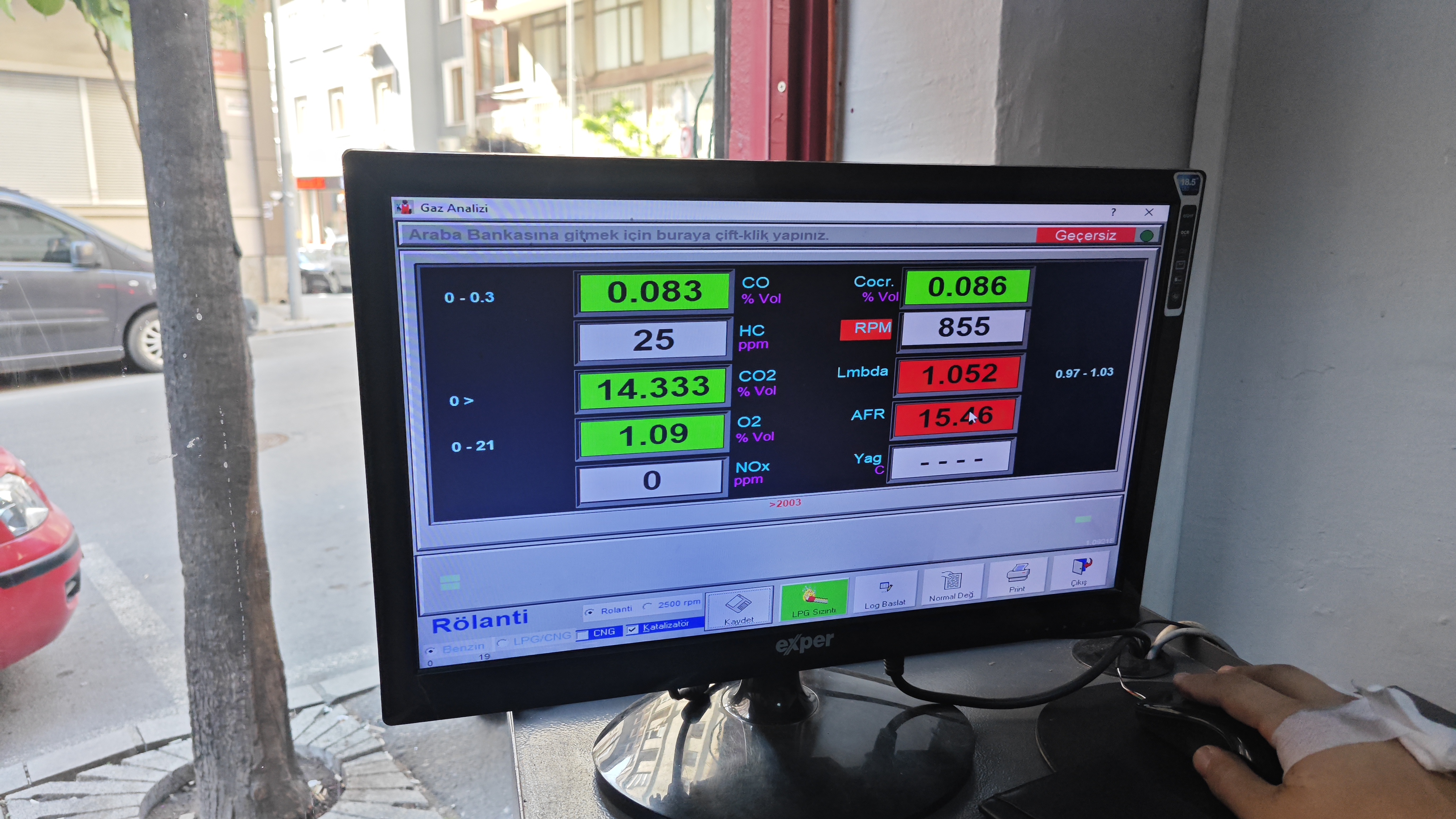

I went to exhaust emission measurement.
Values like this afr 15.5 are too high. (Poor mixture)
