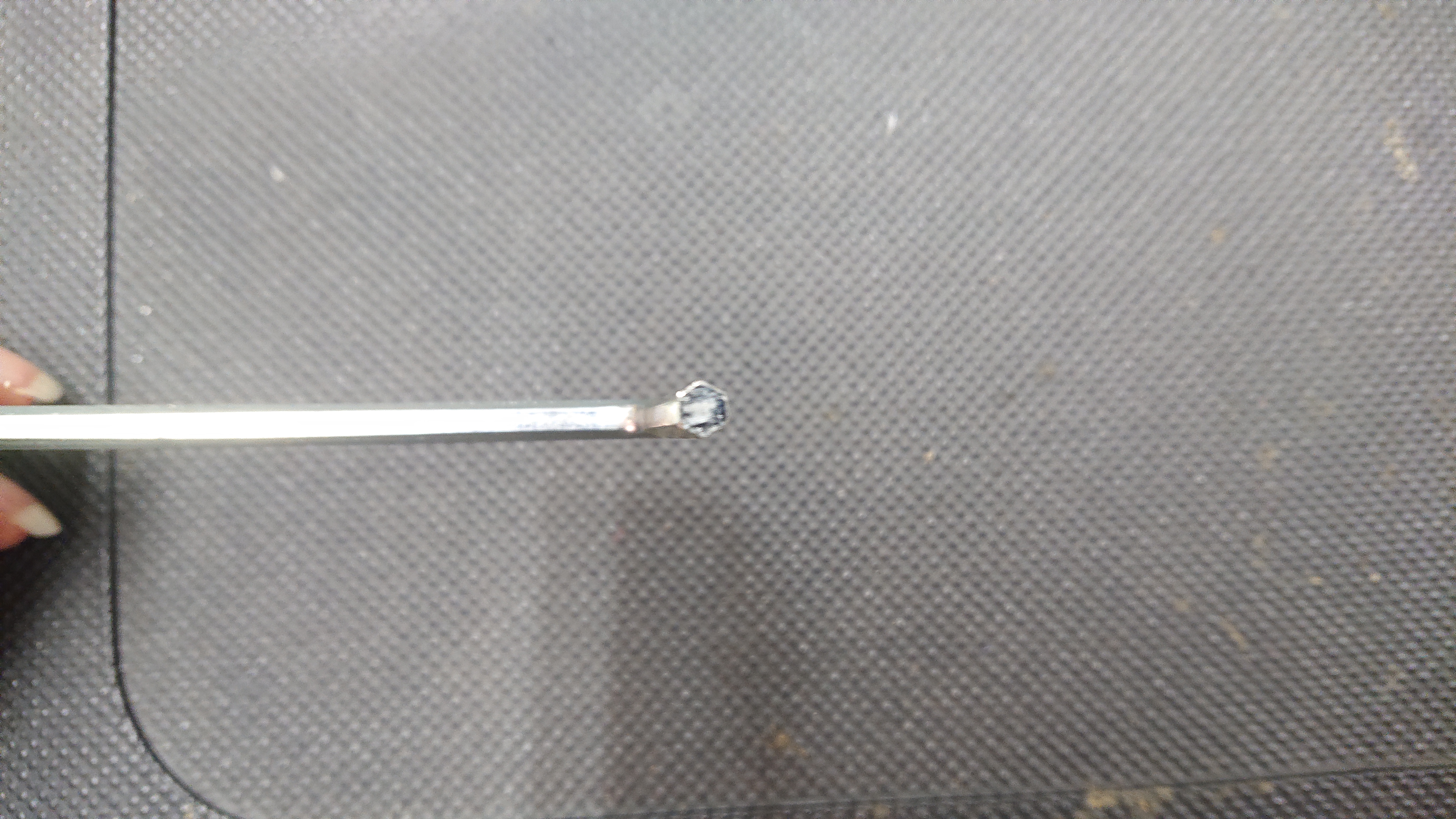

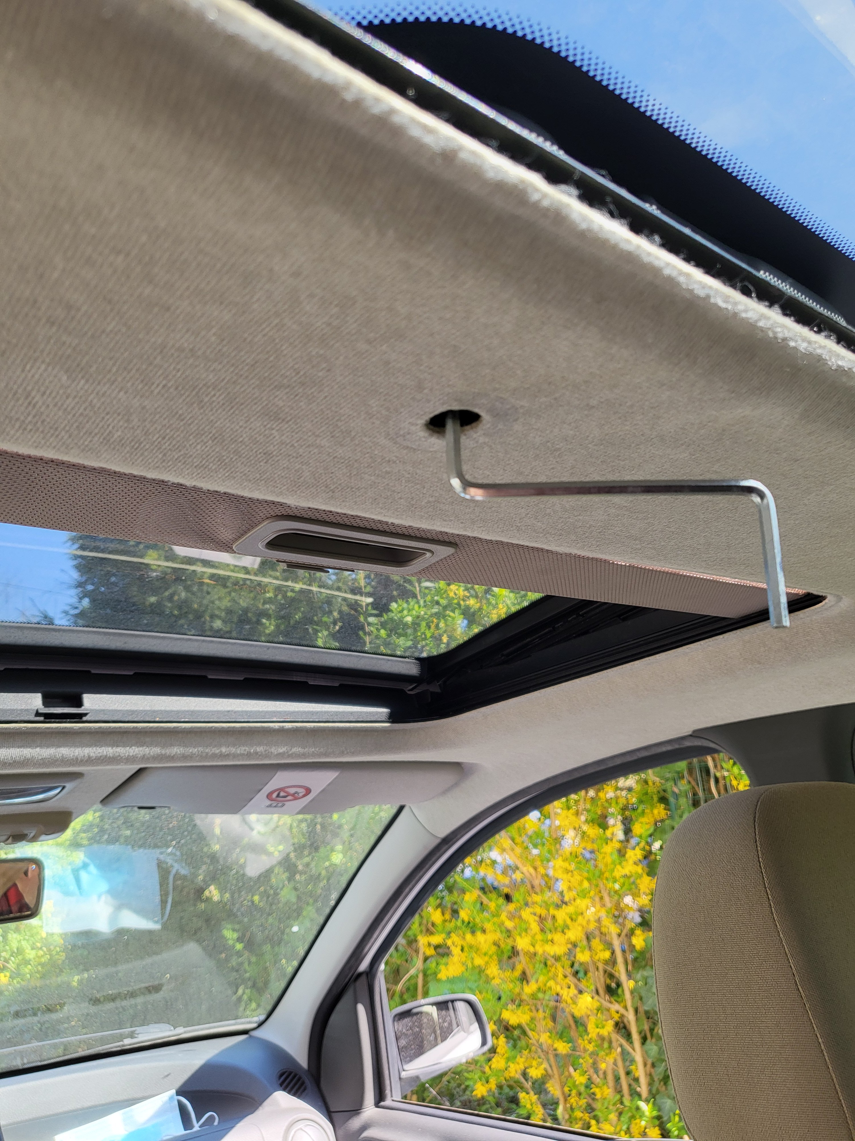

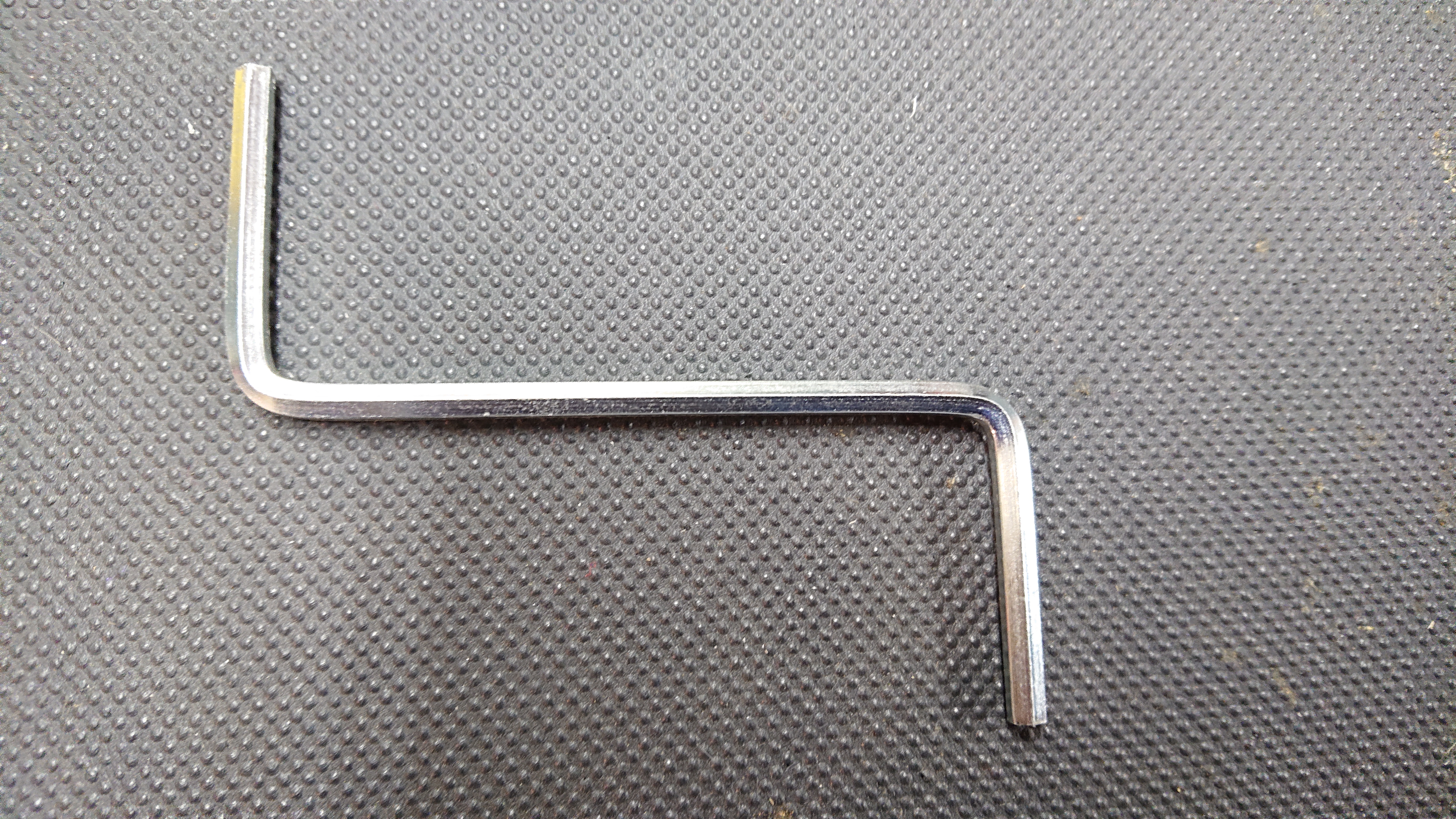

Please see pics of the skydome tool. It really is just a hex key which measures 2mm flat side to flat side. Mine has always lived in my car jack holder in my spare wheel in the boot.
Always wondered what it looked like! Becky doesn't have one but looking in the hole in the roof I can see it's a hex so thought an allen key would do the job if necessary. As we don't intend to ever open it hopefully I'll never need to find out.

I think I (initially) have exactly the same fault as Jollypanda posted on jan 2nd. A kind of grinding clicking noise when trying to open te roof. I do have the 'tool' (which is nothing else than an allen key with two bends, for easier turning it around) but this is quite hard to turn around and I did not want to use to much force onto it. I could open (lift) the roof rear edge a little and closing did work with the switch. But re-opening not: again the grinding noise...

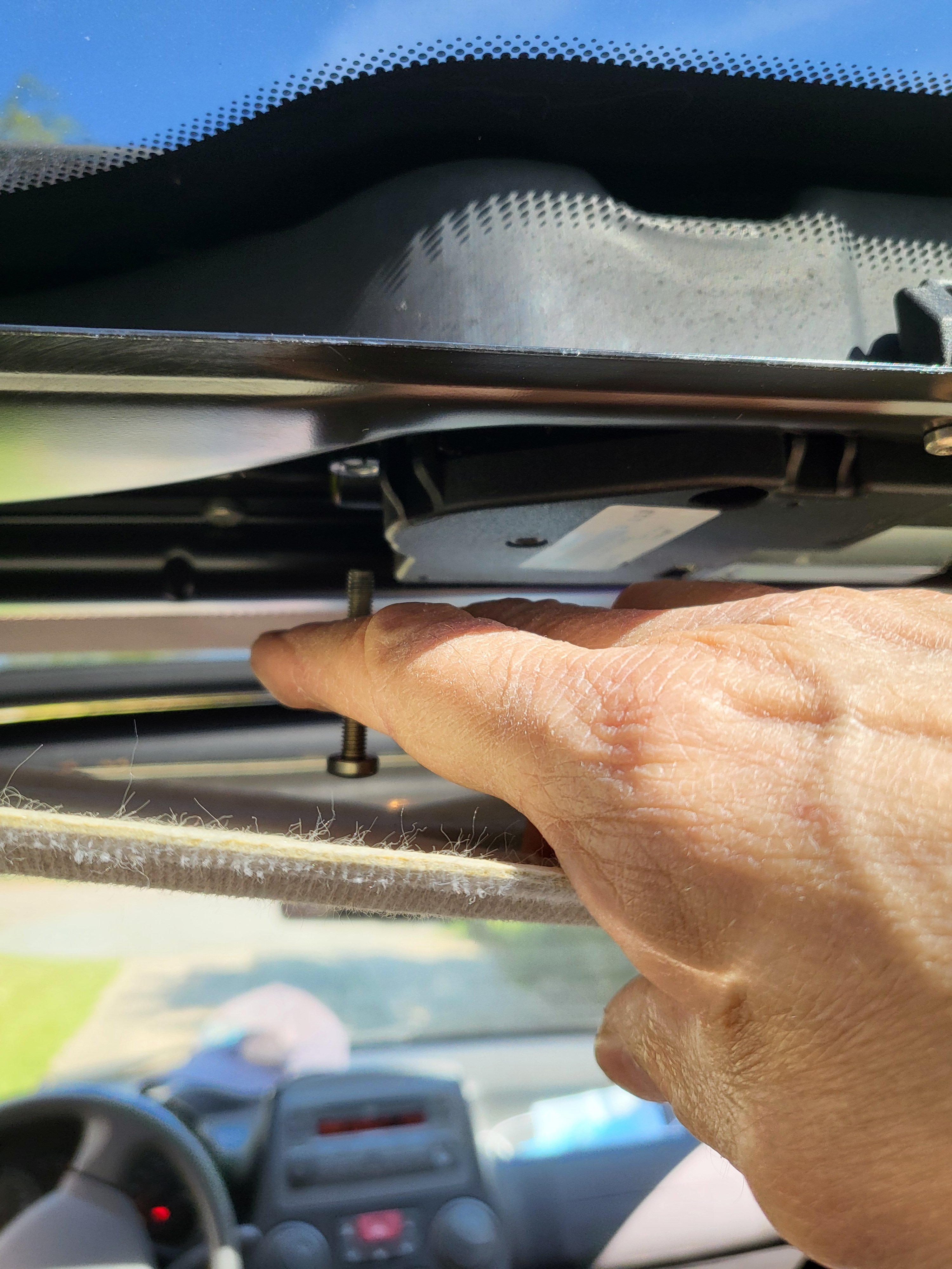

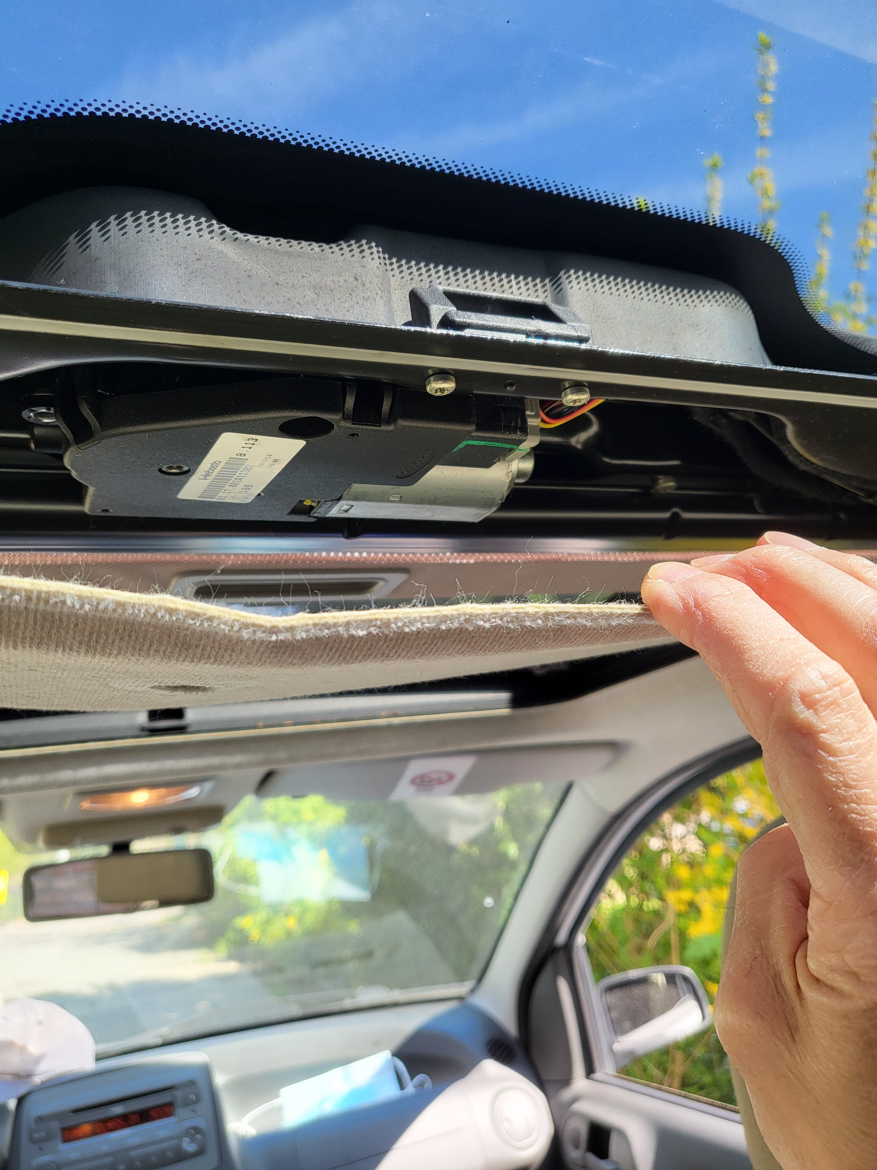

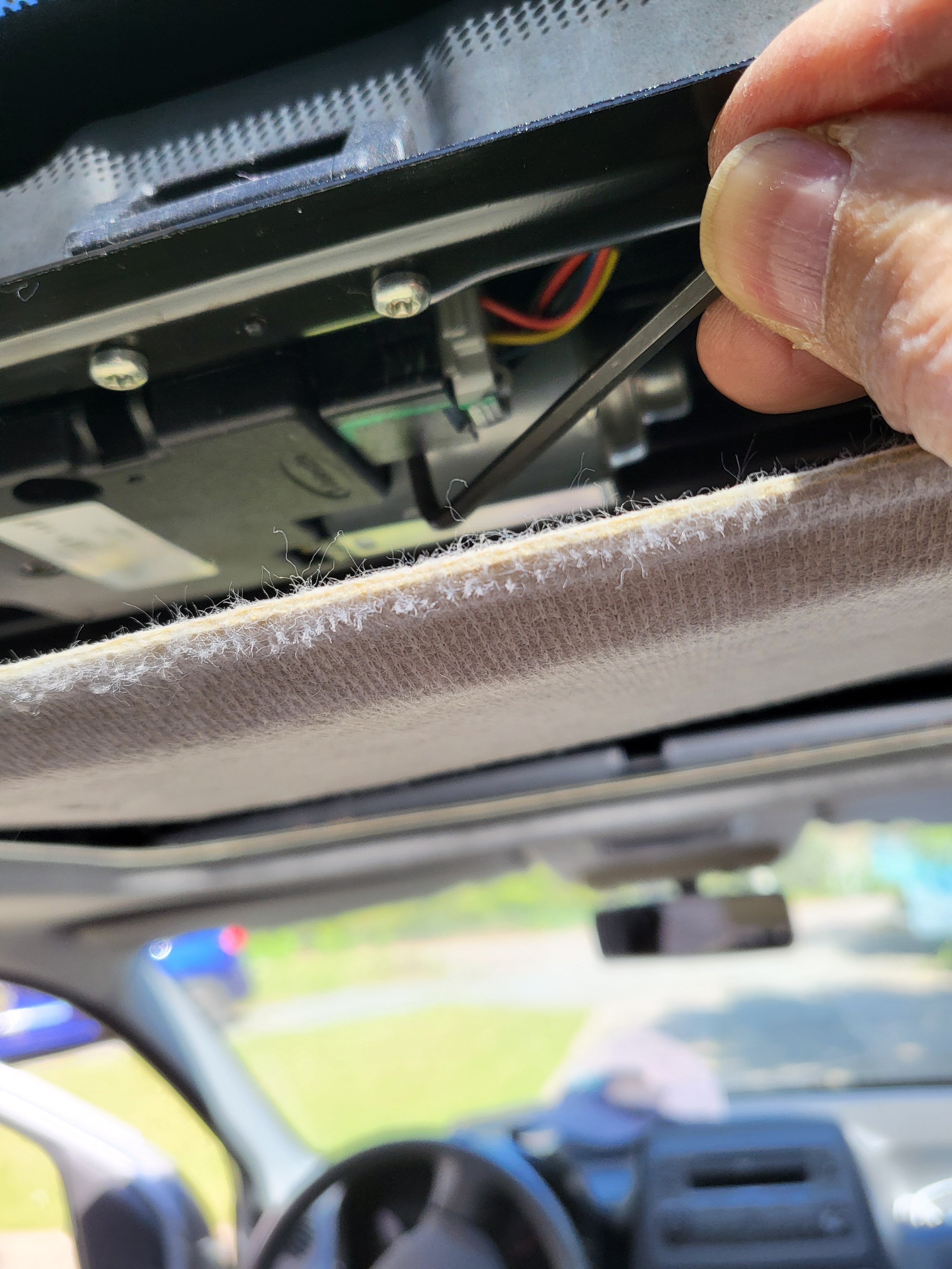

Finally nice weather... and time to spend. And... problem solved!
First of all, the motor is accessable from the inside of the car! 👍 So my main concern is solved by that, because the glass panel was closed and impossible to open, even with the hexagonal emergency-crank-key. This only resulted in a cracking noise as if a chain is jumping over its teeth.
So I took a chance to partly open the interior roof ceiling, quite easy just by removing the the hard rubber 'door-seal-like' surroundings, front and rear, and... found the electro motor completely accessable but loose, one screw completely fallen out, the other half out!
Screws re-inserted and tightened, and now I could (partly) open the roof with the allen- key, and re-closing worked with the switch. But re-opening not (yet). I read something about 'resetting' the logic of the system by keeping the closing switch pressed and holding it for 10 (or 30?) seconds. I gave it a try-out and... everything OK now!

Shame on me. Apparantly I initially missed your post of june 27th, 2019 (!) and had to find out myself yesterday... Exactly the same story! Opening the ceiling, thightening the screws and recalibrating by holding the switch a few seconds in 'close'-position solved the problem. Yesterday I added some pictures. Thanks and sorry!
