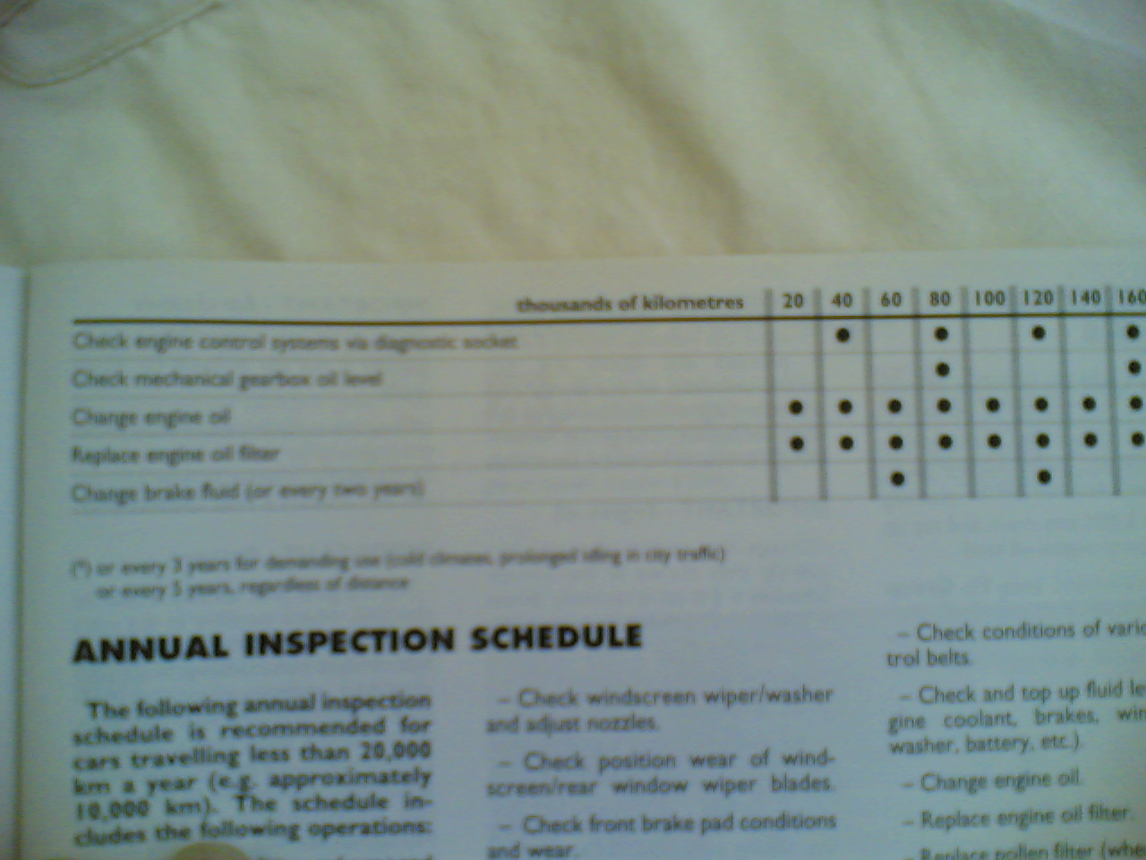

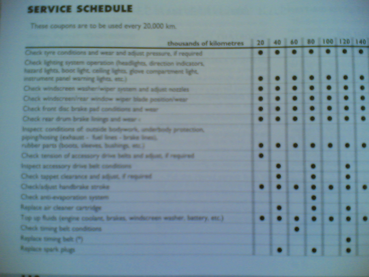

My cinq is making 100k km, so what do I need to replace on that number of kilometers?
What motor oil do you use? I was thinking about Mobil S 10W40 is this ok for my cinq? also which spark plugs you think are the best?
Tnx all! :)
Well thats the problem, I dont have it! could you be so kind to look it up for me?
Thank you! (y)
Poor quality, but just legible. Sorry I don't have a scanner handy, or a decent camera. Just my phone. Should do for you though.
NB. This is for a Sei but should be similar/same :)
