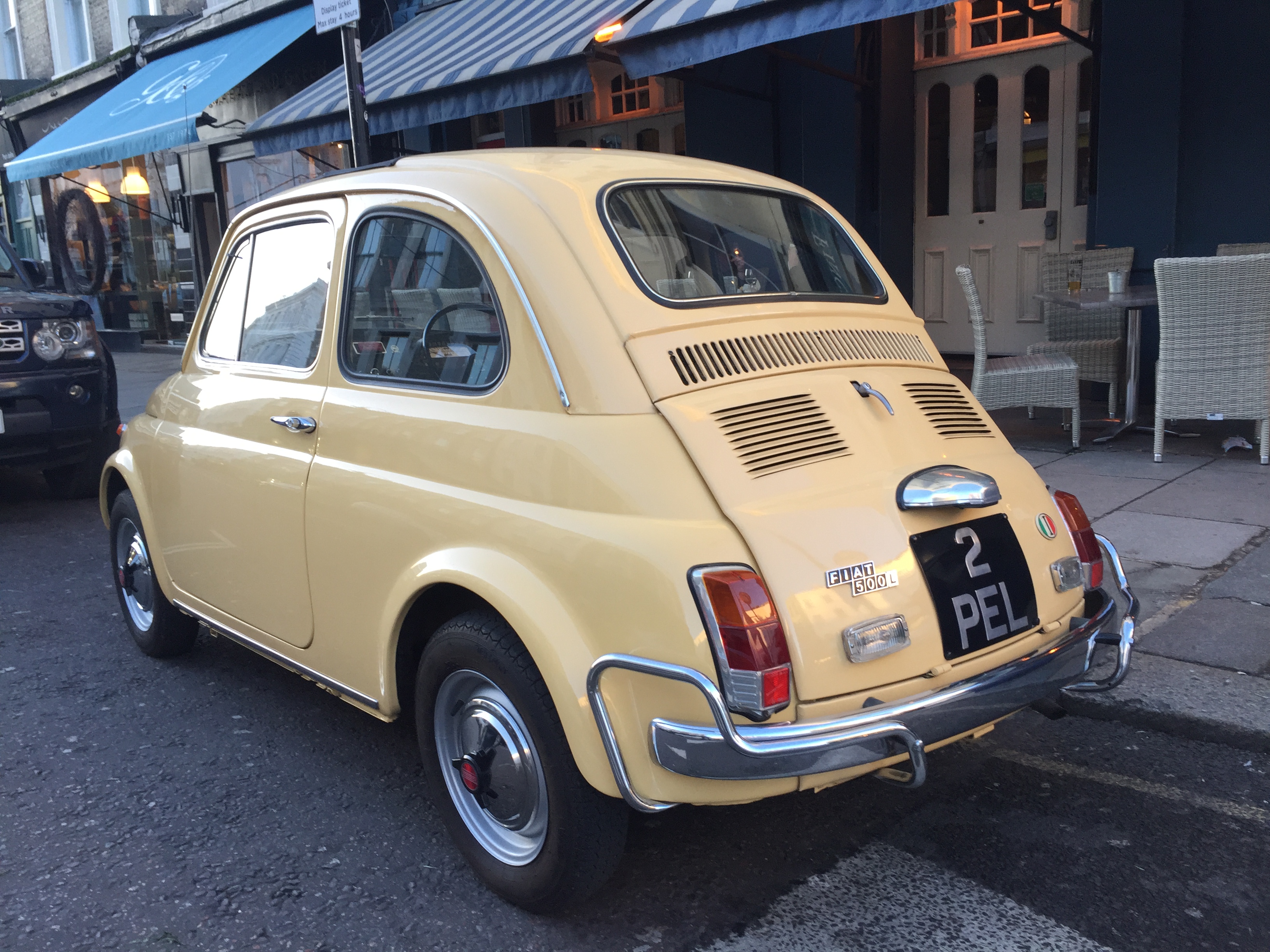

My 500 was fitted with two reversing lights from new and has a little flick switch fitted next to the screenwash pump. So one has to manually put them on. Which I never do!!
Obviously there was no 126 in 1972 so they had no option for this mod.
I may just get a 126 housing and switch to do a proper job. The question begs does the standard 500 box's selector shaft move into the right position to activate the switch? Or is the 126 different/longer? I can see me ordering all the bits. Fitting the housing. Redoing the wiring from front to back and then putting the car in reverse stationary. Then looking at the back of the car to see no lights on!! Classic tale of if it aint broke don't fix it!
Pic of my 500 and British Wipac lights for forum types peruse...
A very nice rear end there! ;-) I simply fitted the reversing light switch as a blanking stopper because I have no reversing lights and rarely go backwards... especially in the dark. ;-) There were two switch rod lengths and I randomly chose the shorter one. In reverse I get no continuity between any of the three! Spade terminals, so perhaps the longer one would work. I got a secondhand housing off eBay...LP Garage; I am sure you would get advice there. Lovely car, please keep posting.:)

Thanks for compliment on my 500. It's a really special example. RHD and genuine 11k miles from new. Always garaged and was off road since 1979.
Has not a spot ot rust or snot anywhere. Original throughout save a bit of paint due to storage marks it collected over the years.
It is sublime to drive as nothing is worn out or baggy! It came with its original exhaust/clutch/wheel cylinders etc. The interior is timewarp.
I never used to be a big fan of the colour but sort of like it now. Taihiti yellow! Very 70's being a 1972 example.
Even has its period FM radio under n/s dash and tinny box speakers on rear shelf/aerial!
