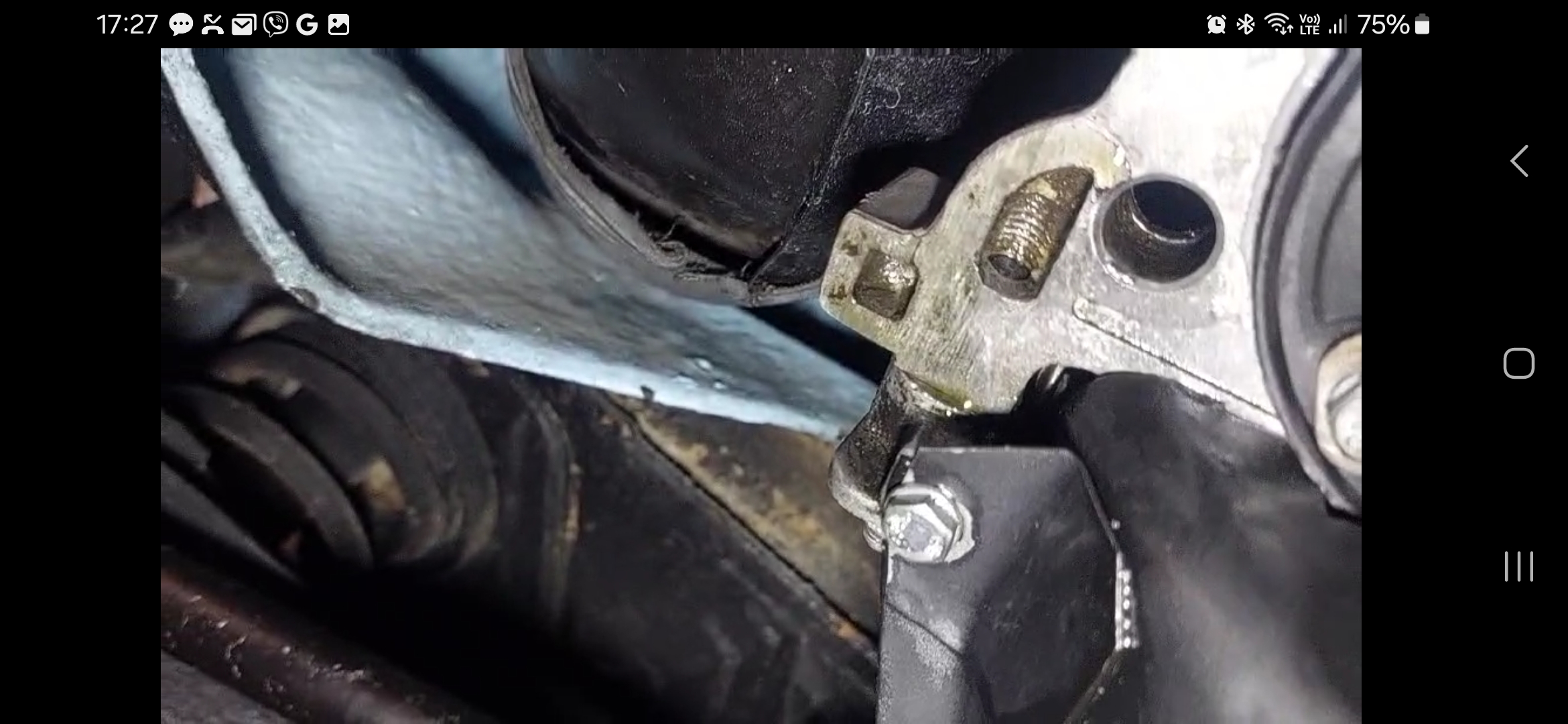

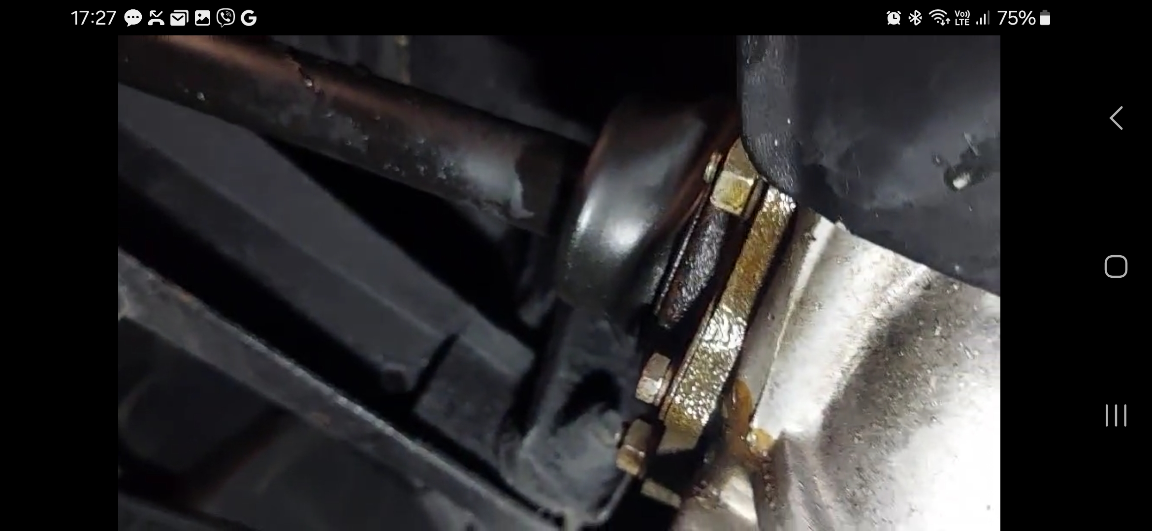

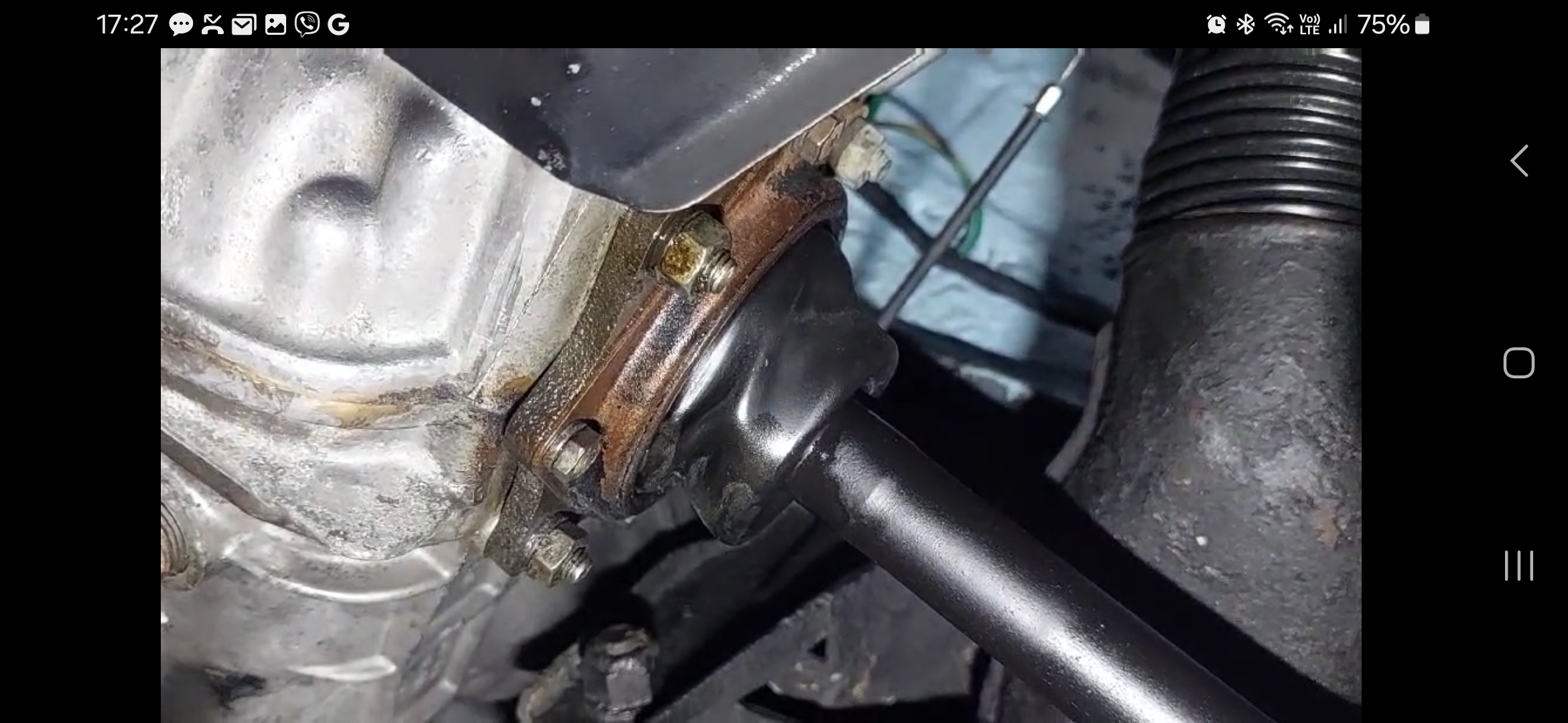

i am sending some pictures... hope you can help me

The first two photos of driveshaft seals in fairness to garage if no work done on gearbox/driveshaft area may be down to fair wear and tear and new seals etc. needed there. They have a strange system peculiar to Fiat I think, where the sealing side revolves in the fixed rubber gaiter, others here will be able to explain it better, but unless gearbox is overfull of oil then not alot to be done apart from replacement there.
Re the last photo if I am reading it correctly it may be a seepage of engine oil around back of sump area, in which case that would be garages problem
As I explained on an earlier answer to a similar question, the gearbox boots and seals can easily be changed WITHOUT removing the gearbox, especiallyif it is a garage doing the repair and the car is up on a ramp. As to the engine leak---that will have to be examined on the ramp (with you in attendance ?) to ascertain the actual cause. There is a u-tube film showing how to change the gear-box boots and seals with the gearbox still in-situ.
I agree with @the hobbler, that the boots and seals can be changed "WITHOUT" removing the gearbox.
However the point being raised was whether the gearbox had been removed by the garage when engine work was done and to whom the resultant oil leaks could be attributed to:)
