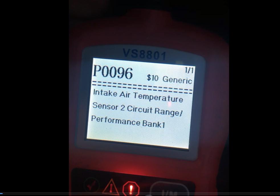

Thanks for that kind message any idea which one i need to clean and its location i have some cleaner ,i also put it on my own reader which came up with the same symptom pictured,
