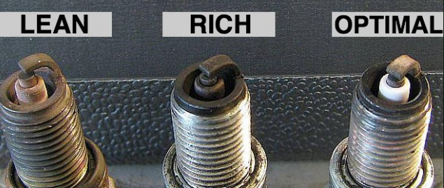

Too weak - a lean -mixture will cause overheating. Too rich a mixture -like running with the old manual choke pulled out - causes a loss of power and cutting out. If the mixture is too rich your plugs would be blackish.
The image attached shows spark plugs that have had a lean-rich and normal running.

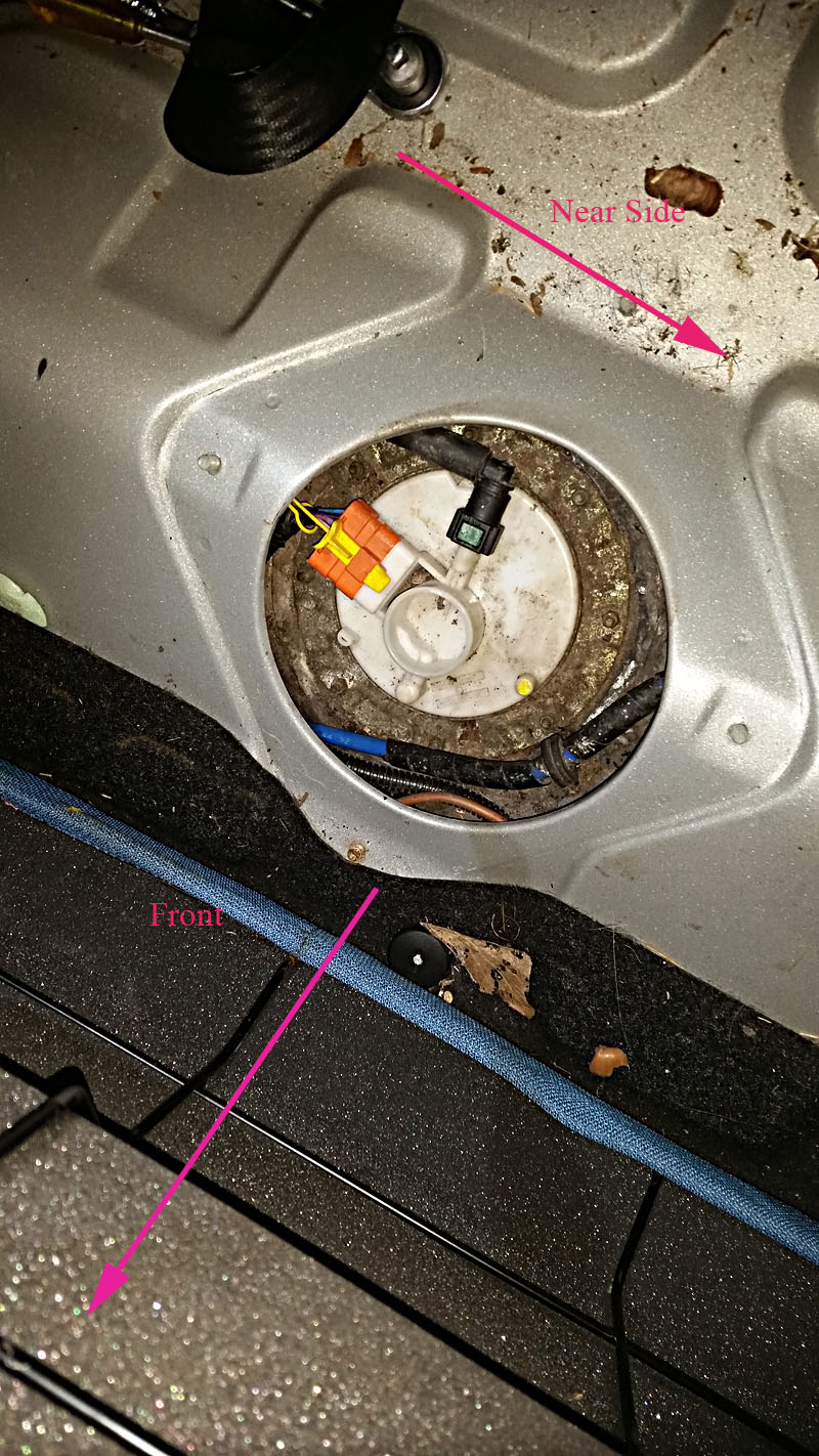

No did not do the return as it does not go back through the top of pump but the hose goes under the back seat somewhere to some other connection. I'll try and get a photo when I take the dog for a walk in a minute or so.
Here is the pump. The blue pipe continues under the seat towards the nearside and I assume is the return pipe.

Seamus, I full agree with Jackwhoo. You now need to fit a new fuel pump. You're not going to progress one way or the other until you've fitted one.
Looks like it. Trying to avoid unnecessary expense but looks like it.

Where the fuel return to tank pipe connects to the fuel rail . If possible disconnect it there. Connect a spare hose to the fuel rail and measure the return flow there.
