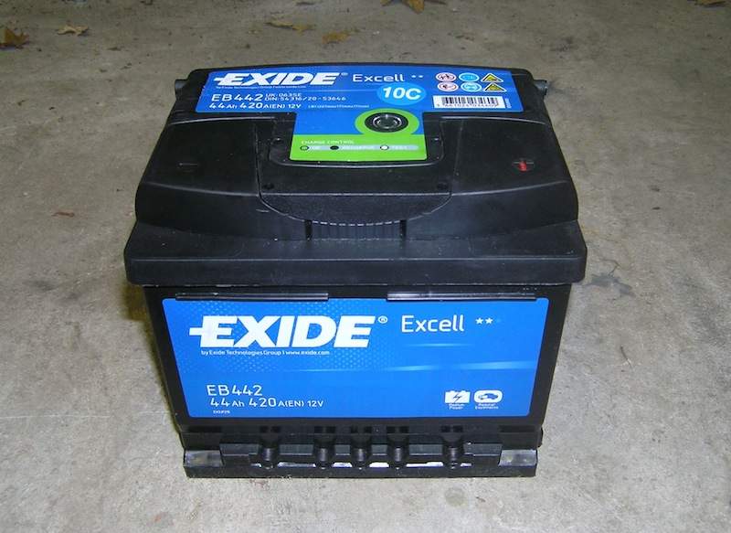

The original battery is 12 Volt / 40 Amps (Magneti Marelli).
At the local shop I bought the following battery:
- Exide Excell 44Ah 12V (80 euro)

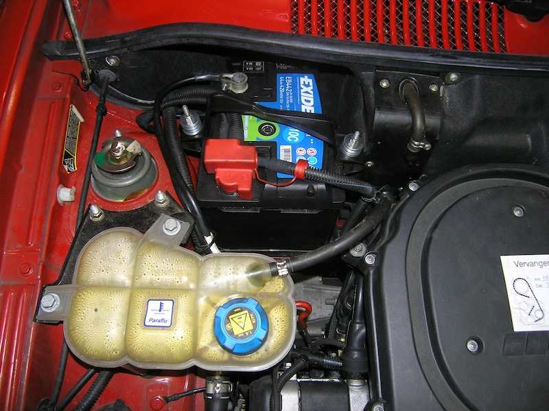

Open the engine compartment.

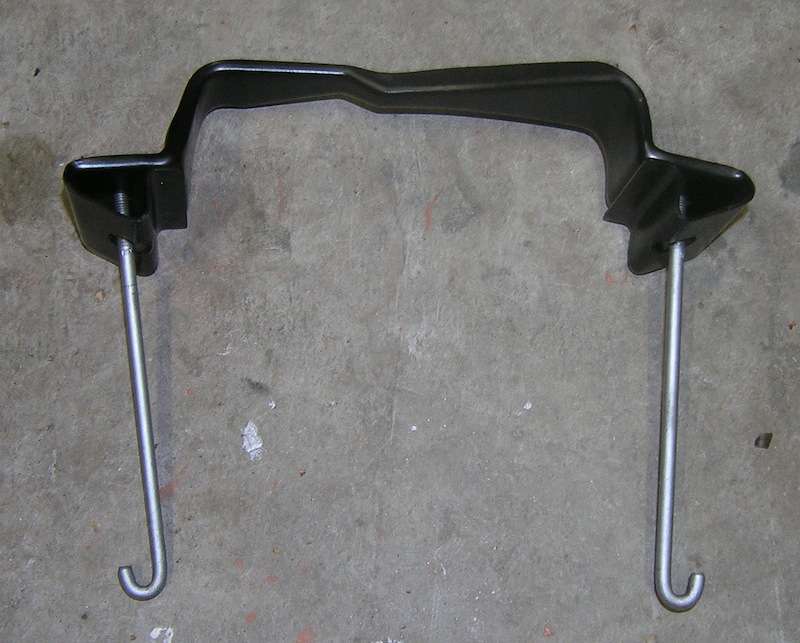

Locate the battery and remove the bracket.
It's secured with one bold on each side.
Loose the bolds almost entirely.
Now rotate the rods a little and remove the braced.

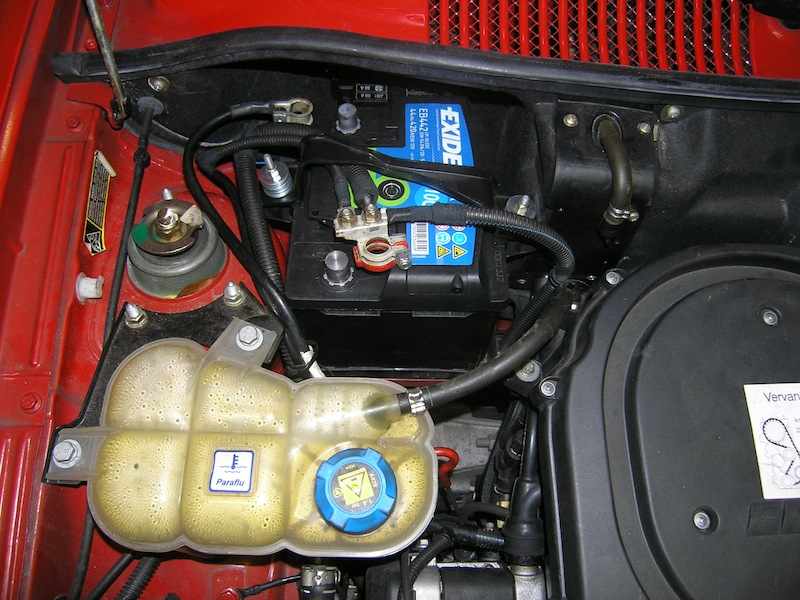

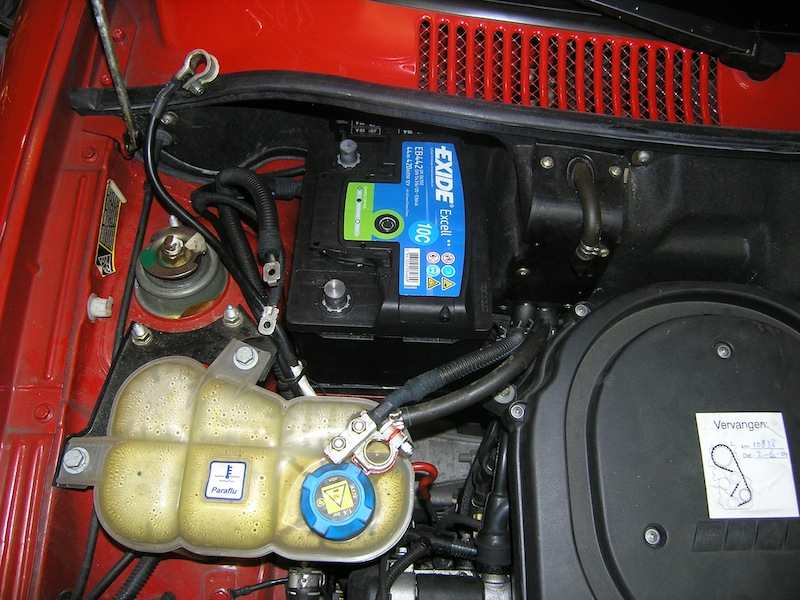

Now disconnect all electrics.
First remove the negative one. Then the positive.
Please make sure you do not short anything!
The positive connector has three wires connected to it.
I had to disconnect both separate wires to fit the new battery.
Otherwise it was not possible to slide the new battery underneath it.
(And yes, i noticed i did not remove the negative first in this picture :bang: )
attachment.php

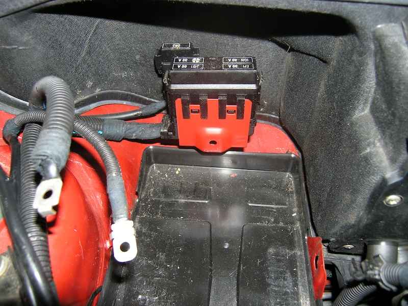

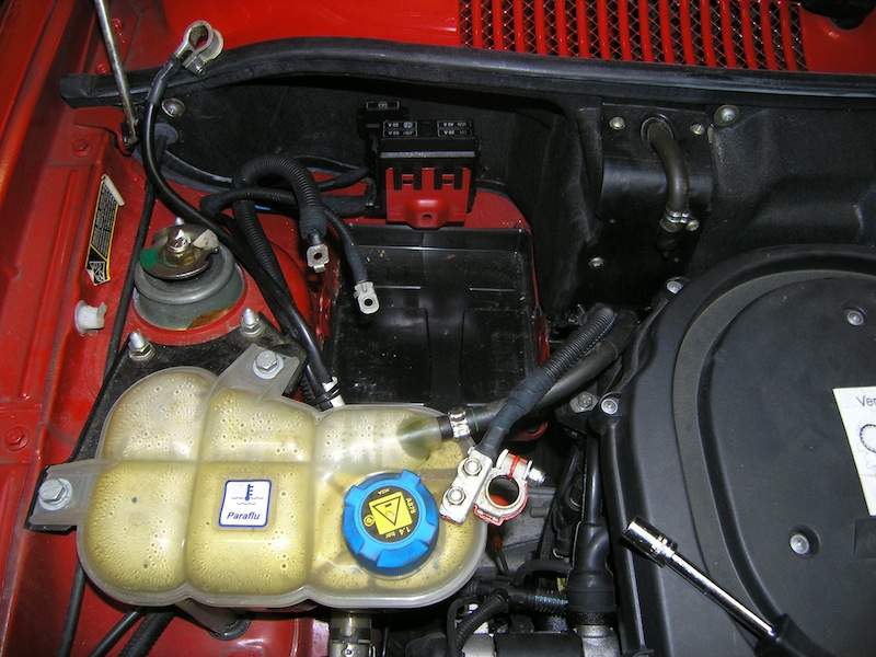

Pull out the battery. The original one comes out easy.
attachment.php
This red bracket was clearly in the way.
I bended it a little backwards (1 inch / 2.5 cm).
Now there is 'plenty' of space for the new battery.
attachment.php

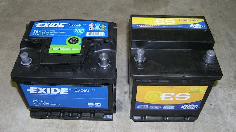

Comparison of both batteries. Original at the right.
attachment.php
In my case the new battery was a little bigger.

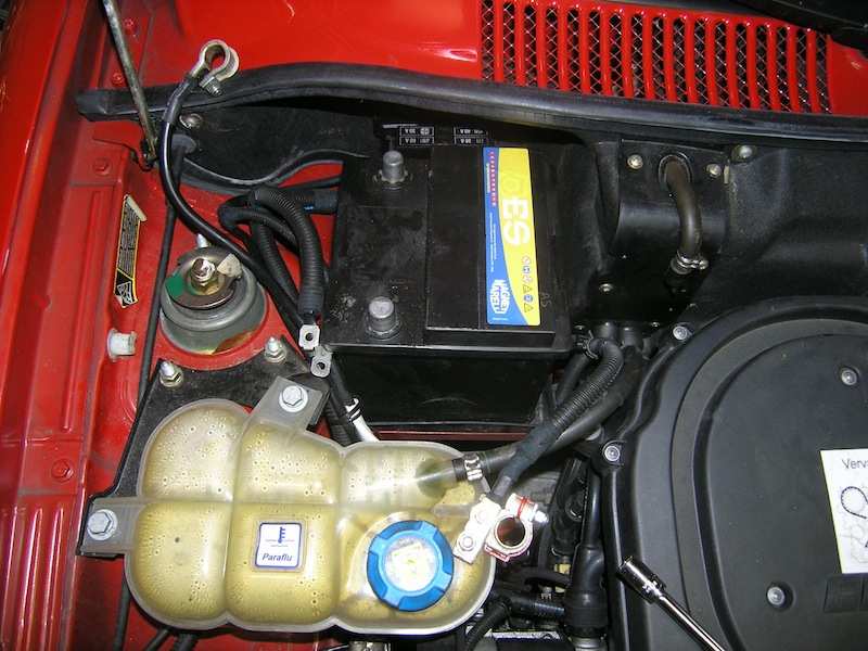

Now the struggle begins. Flip the battery inside.
The new battery fits quite tight in the Seicento.
Make sure you don't damage any parts.
Especially the wires and tubes around are quite vulnerable .
attachment.php

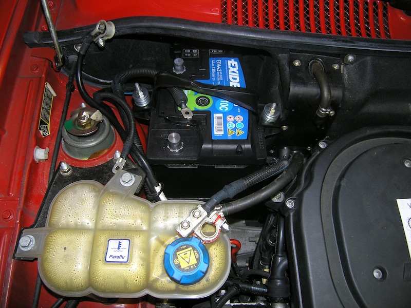

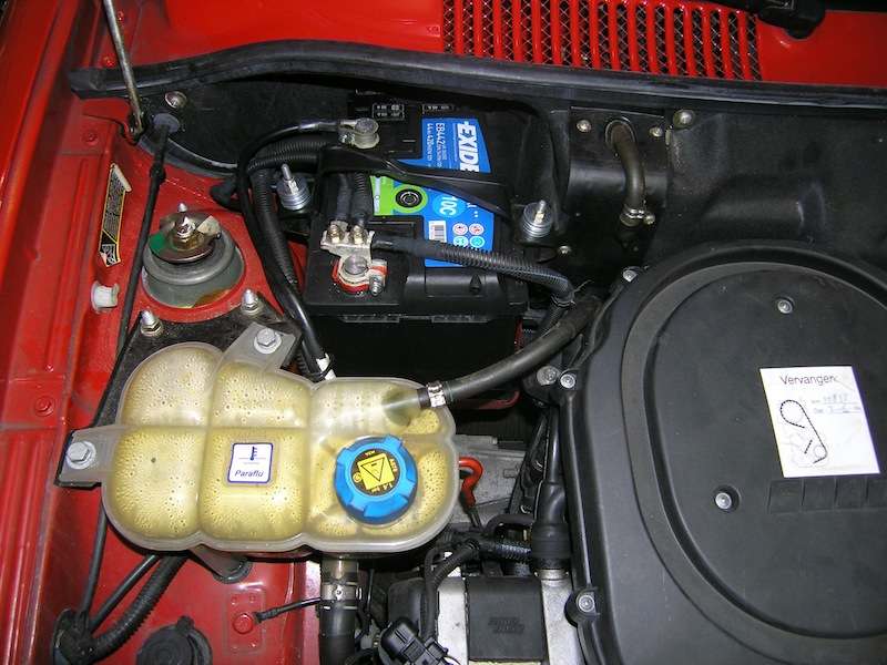

Put some vaseline on both terminals and connectors.
This prevents corrosion.
Reconnect all wires properly.
First connect the negative and then the positve.
Again, make sure not to short anything.
attachment.php
attachment.php

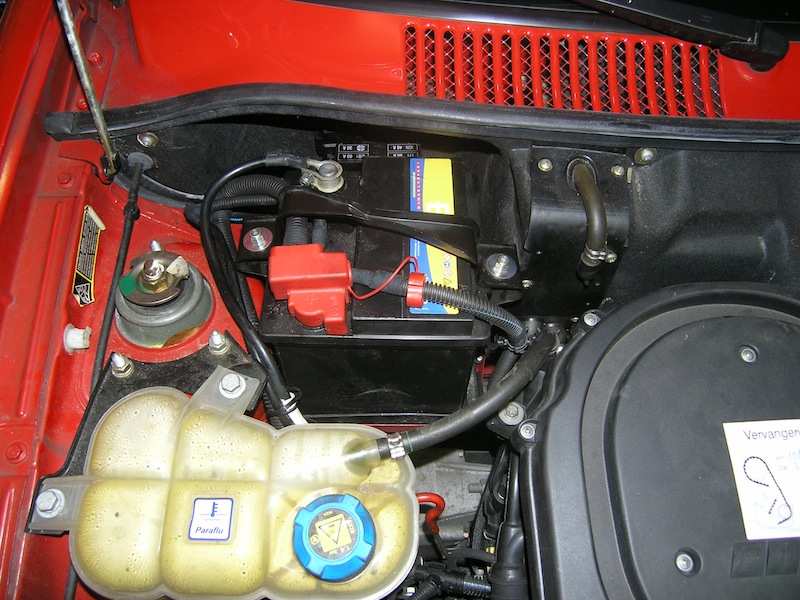

Now put back the little red cab and enjoy the result!
attachment.php
Close the engine compartment and make sure nothing is left inside.
