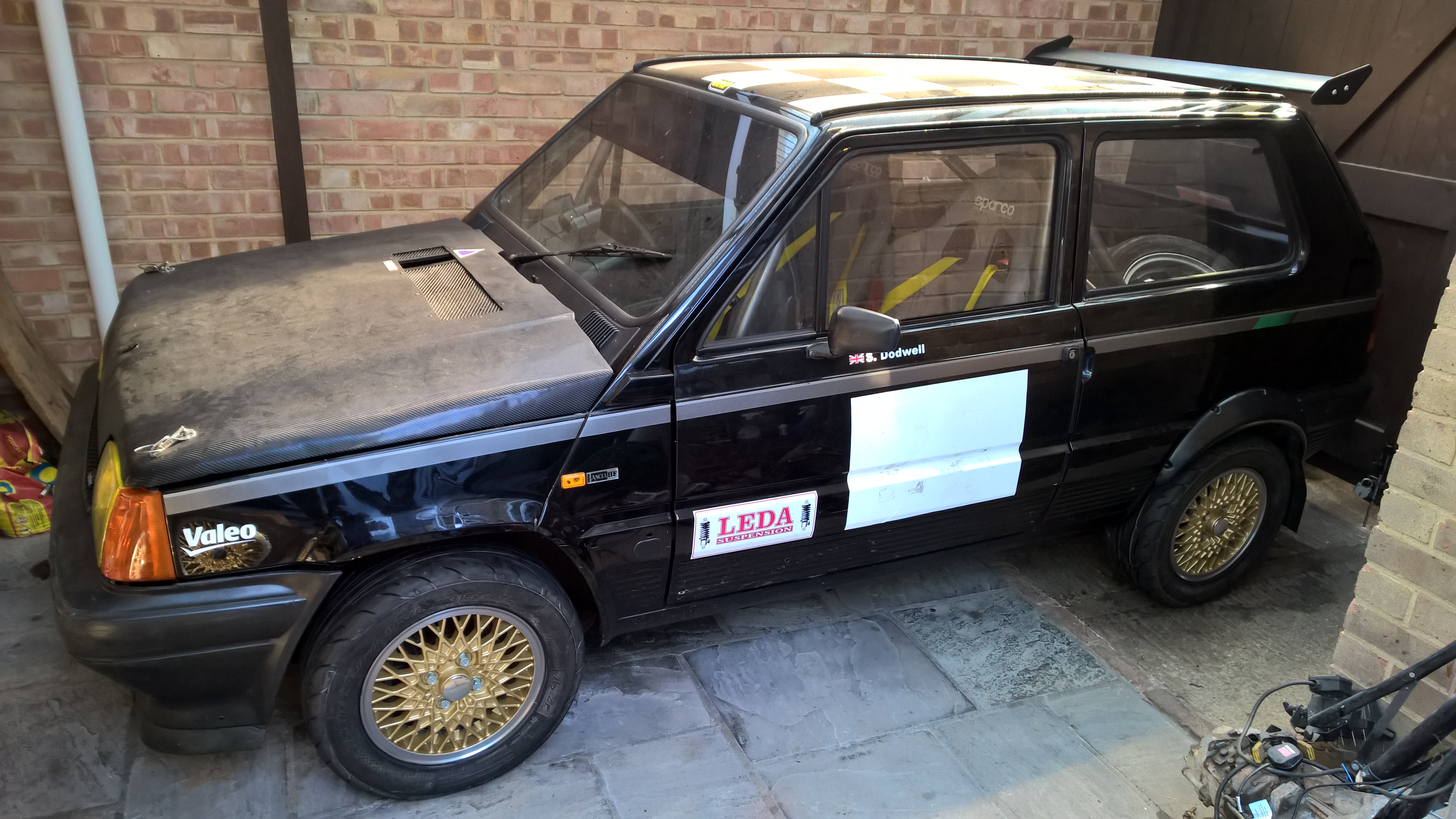

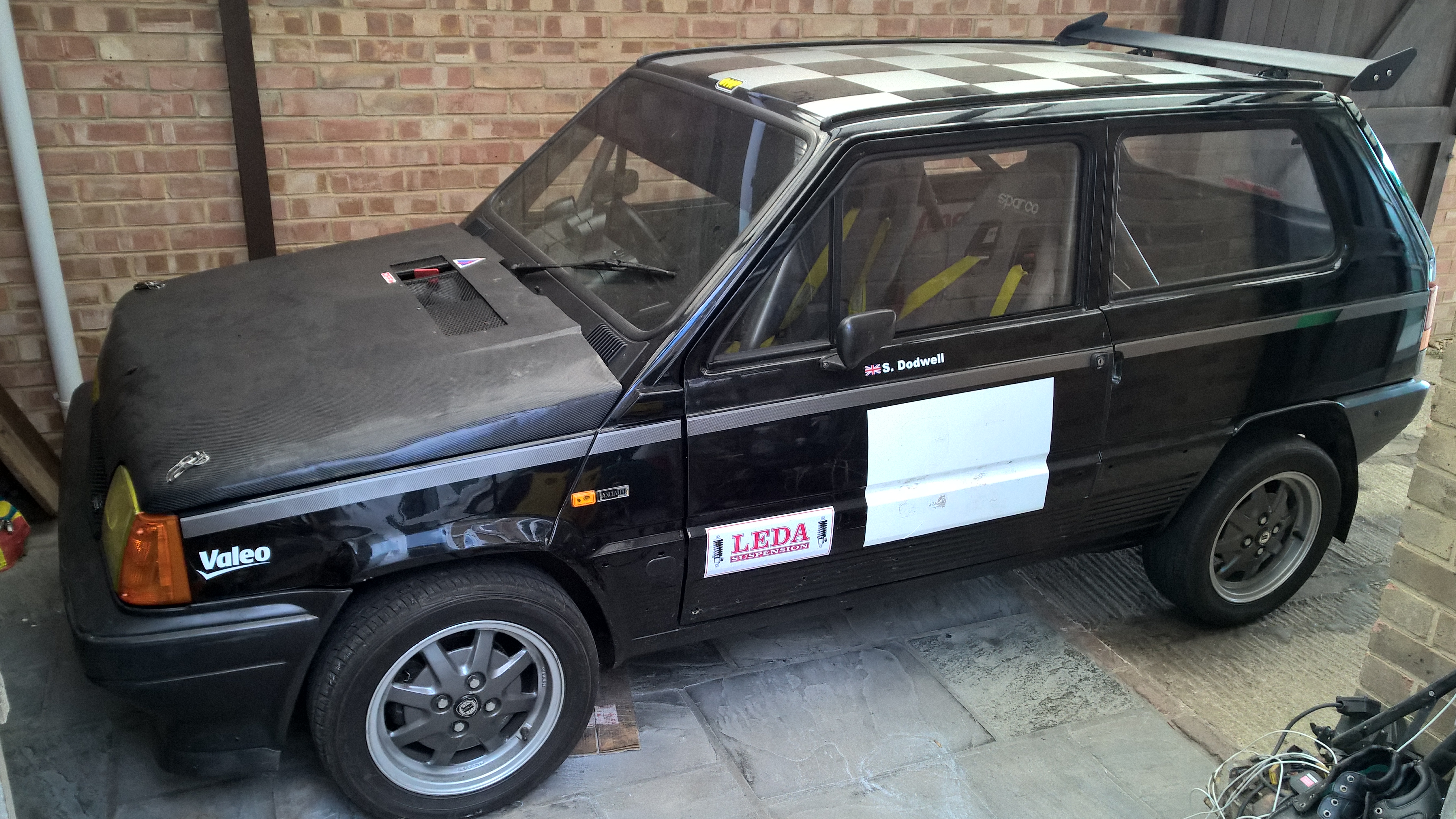

Si. Magenta our next panda will be swinging arms fully floating axel. Pannrod arm and coils at the rear Same set up at front 45mm lowered engine and front wheel centre moved forward by 25 mm + 120mm lift again

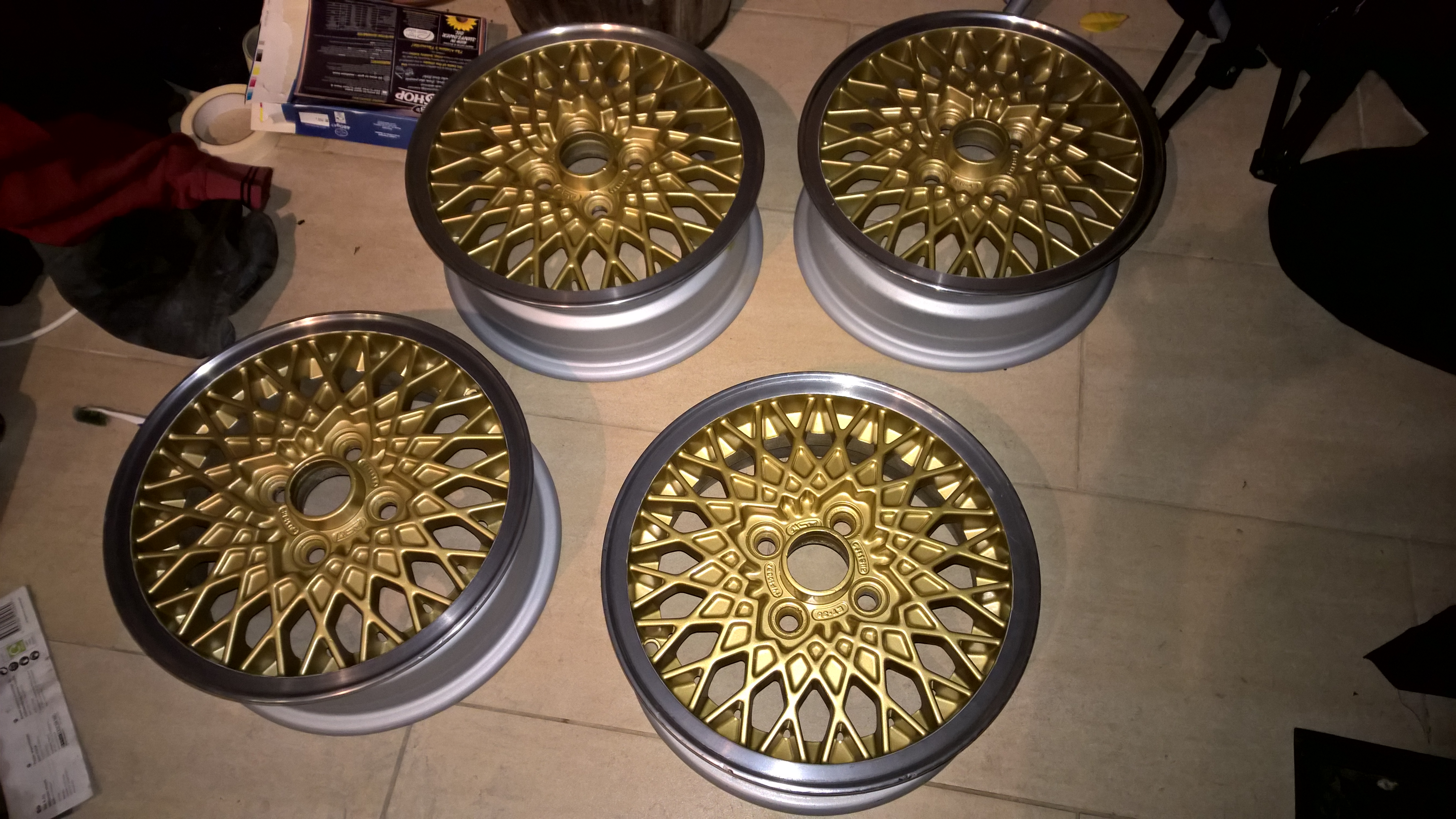

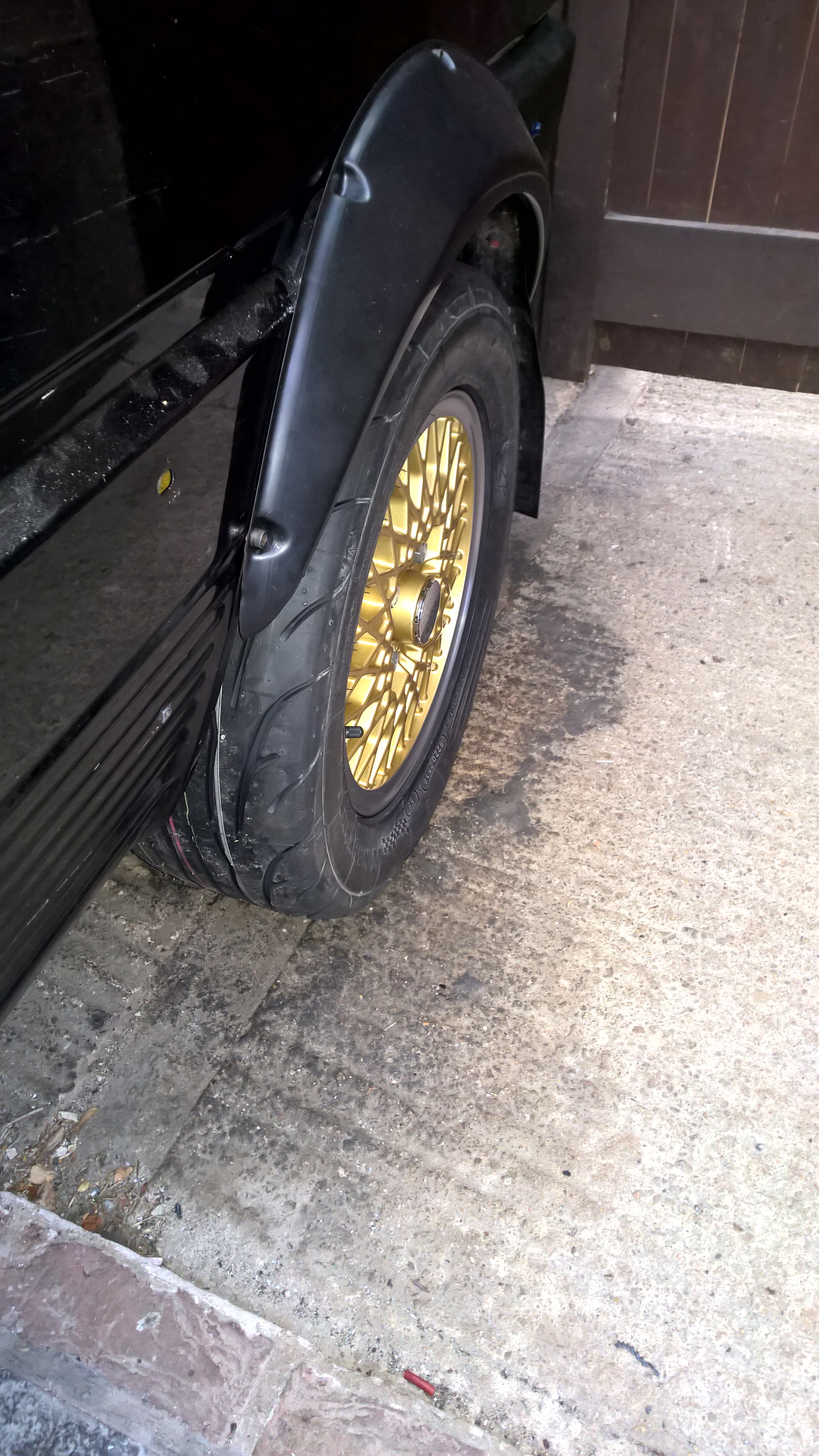

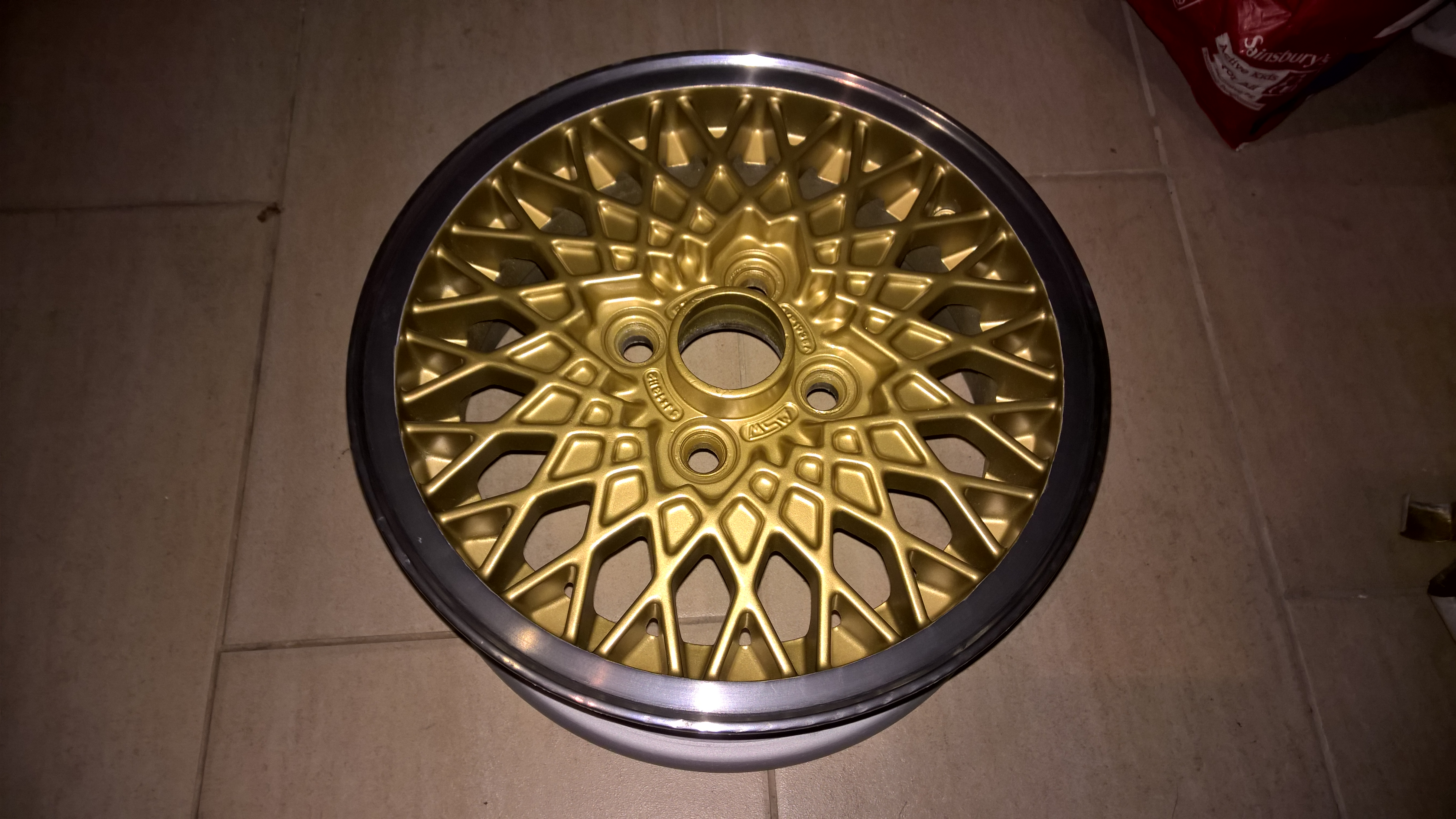

Looking Mega Si! And I absolutely love those wheels. Presumably they aren't 4x98?
