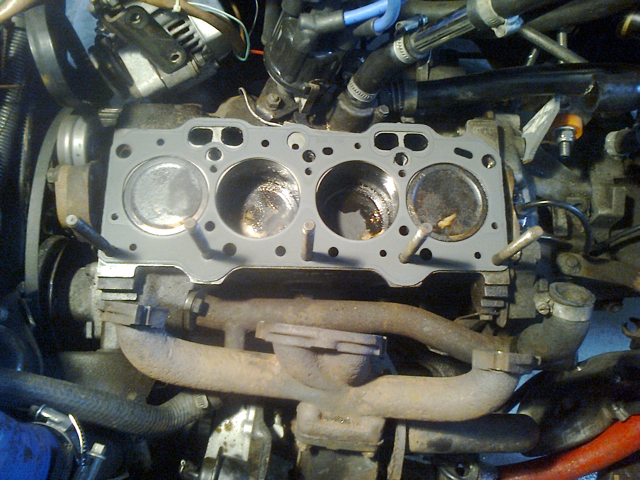

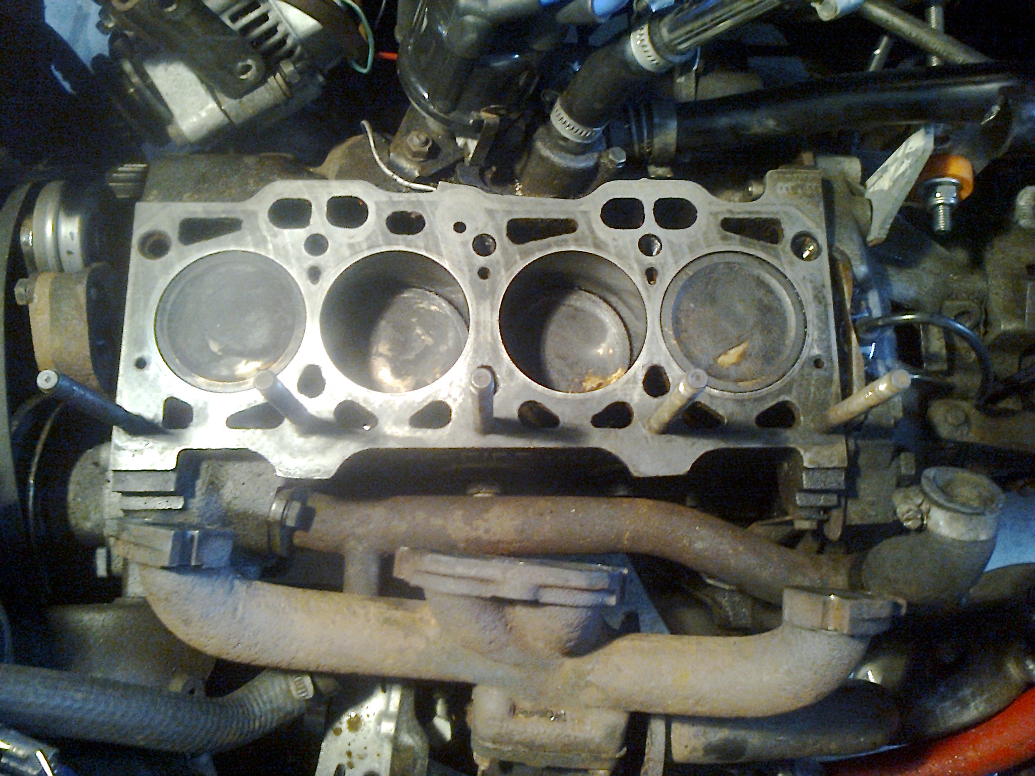

Thanks for the links, might consider the spesso gasket for future but managed to get one in the end thanks to my Dad for ringing around. I got 2 sets and 2 bolt sets as well. But with the damage done to the bore I think it won't be long before the cylinder head is back off again :eek:. Just have to get this event out the way on sunday.
Anyway, as I am learning this engine now it took me a little while to develop the technique so only got the head back on this evening.
Very odd engine with thinner studs on the front and bigger bolts at the back of the cylinder head and even with the crows foot tools I just bought impossible to tighten up the nuts as they had a special tool at Fiat. Had to guess the torque using the calibrated elbow for 2 of the nuts but fortunately the angle bit removes some of the inaccuracy at least! :eek:
So tomorrows job...put EVERYTHING else back on! and hope all that was wrong was the head gasket and the cylinder bore is just terrible looking but functional!

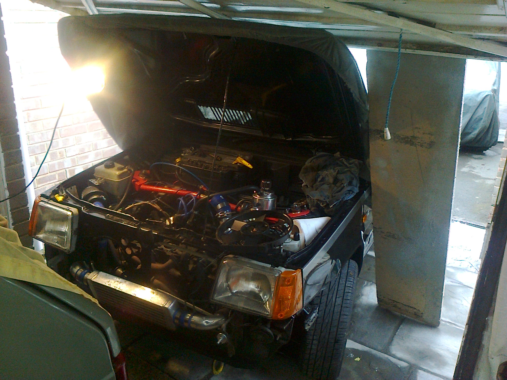

Also, if anyone is wondering...hmmm how do I stop it from raining. Just go to excessive lengths to keep dry like this...
Not a drop of rain all evening even though it was wet all day to this point :rolleyes:
And the momentous occasion...the placing of the new head gasket :)
