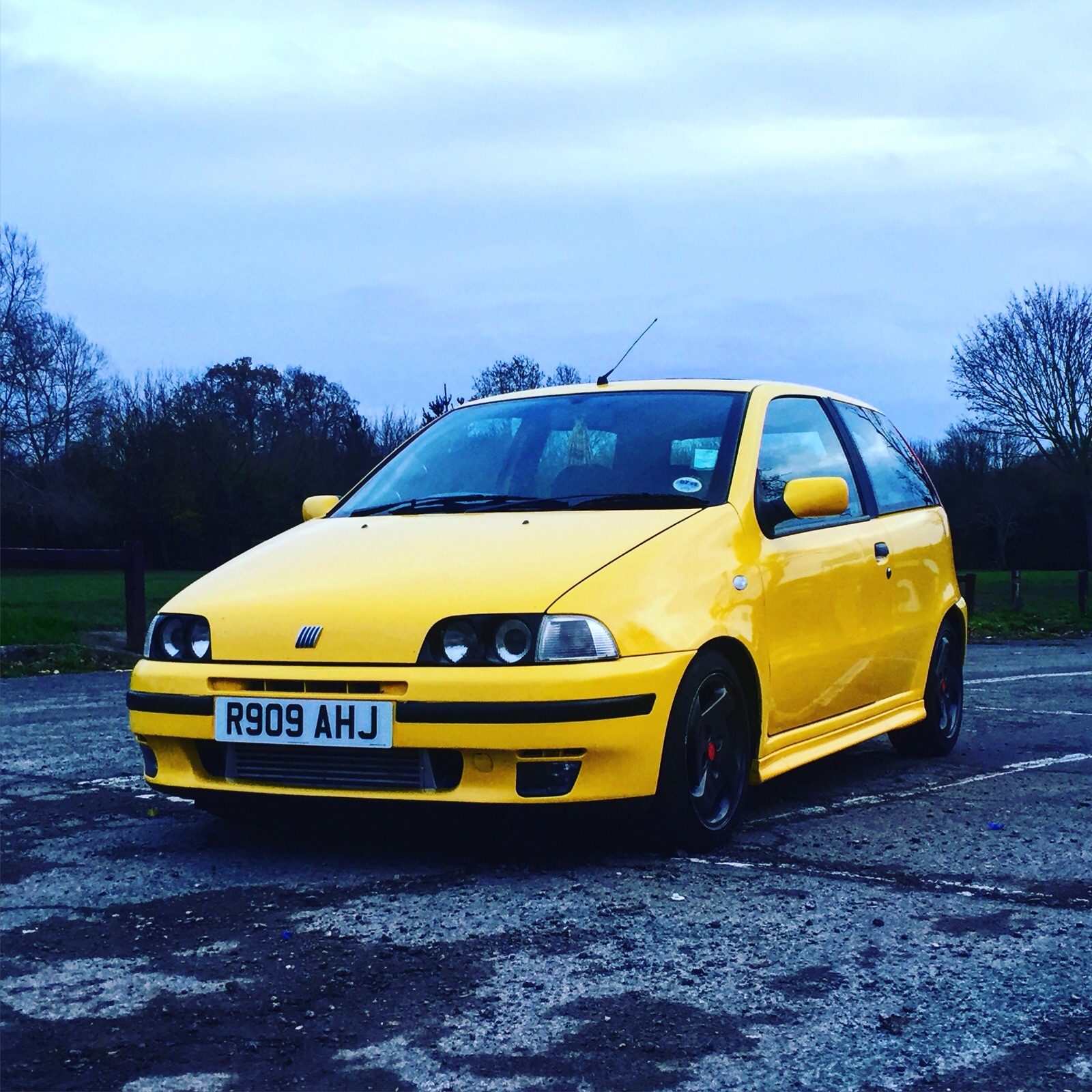

Just been shown the thread by someone, I currently own the GT had her since 2013. Not sure how to post pics but if you Google puntogt92 my instagram should come up. Dan
Some pics.

Good to see its still going and looks really good. What sort of work have you had done to it? I had a folder with receipts to show a few thousand pounds worth of work i had done to it which i gave to the bloke i sold it to, it would be nice if he had given you those as a bit of history.

Yeah I got all the receipts when I bought the car there is so many, lots of old mot's and other bits aswell.

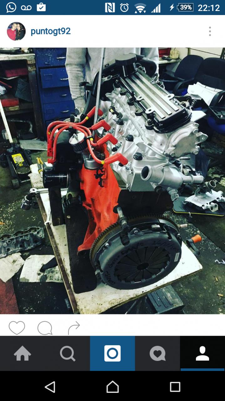

I've spent quite a bit on it, it's running forged pistons oversized pistons and pec rods, ported polished head, piper fast Road cam, gt2554r turbo, methanol injection, 440cc injectors, 255 fuel pump, 3 inch maf conversion and when it's mapped 3 stage boost mapping also quafie lsd. should be making a safe 250hp when it's mapped.
When I bought it I had about 3 receipts then I collected a fair few, it was my pride and joy but i'm glad its still going and looking good. That's a good spec and i bet its quick as my rs feels pretty quick and is only running 228bhp and weighs more than the gt. Have you fitted the side strips on the doors? I bought the car without them.
Haven't really floored it yet still running in done around 800 miles, and I did buy some side strips but not sure weather to fit them or not. Was running 170 ish bhp before rebuild and turbo ect and it was great fun, in some ways better I'm scared of breaking it now lol
