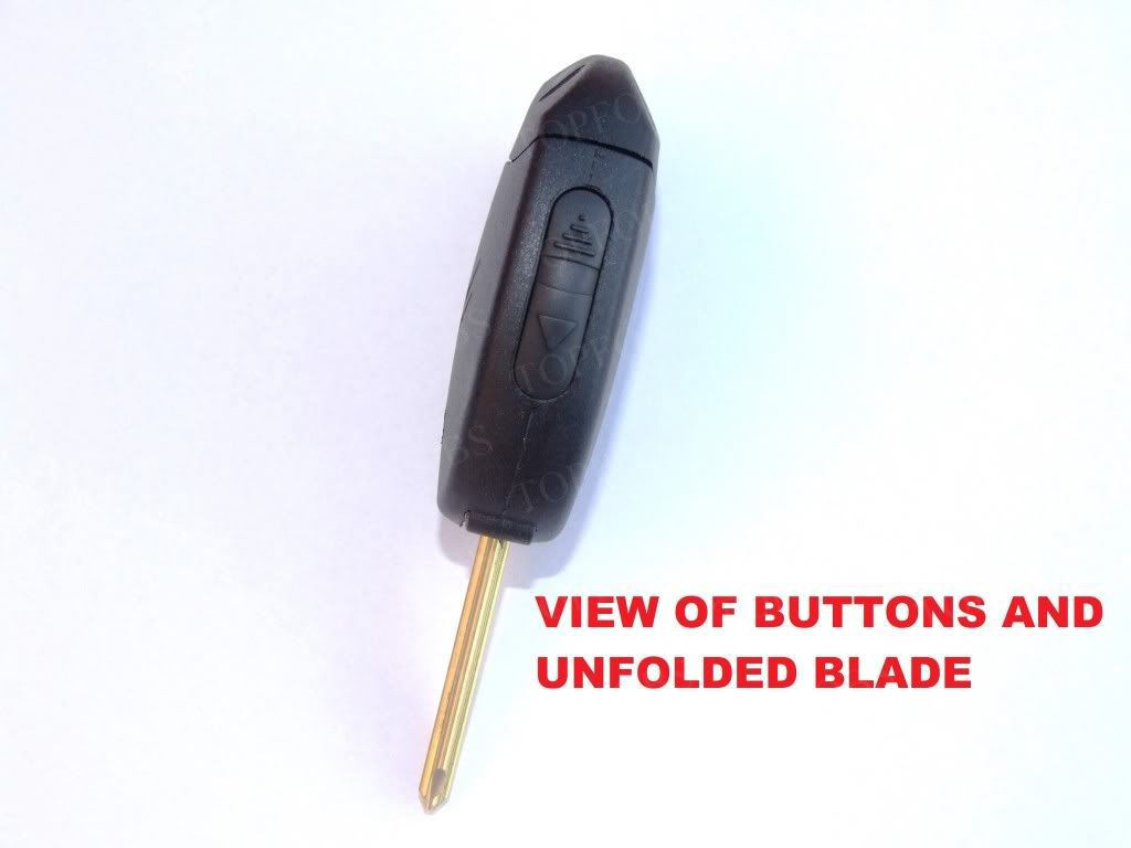

The remote central locking/unlocking on my 54 (2004) Scudo has stopped working. It was getting a bit intermittent, now nothing. Took the key's battery out and tested on a multi meter and it seemed OK at 3 volts.
I had the battery out of the key for a few mins, and since read that this can cause problems? Have I done anything wrong?
I have the security code and spare (non-remote) key. Any advice appreciated.
The key is the type with 2 buttons on the side and blade that folds out, similar to in the links -
http://i1142.photobucket.com/albums/n602/topfobs/sid_zpse5a30eaa.jpg?t=1360338566
http://thumbs3.ebaystatic.com/d/l225/m/mJfSC44Gryw93UvFAd6bp_g.jpg
Check first if the 2 micro switches are on the circuit board behind the 2 buttons, these have a habit of coming off and being lost when you take the fob apart...I cannot seem to find replacement micro switches like this anywhere. If all is good the next thing you need is a new battery...your may read 3v on the meter but when under load it might drop dramatically...if still giving problems...scratchy head time mate!:D
