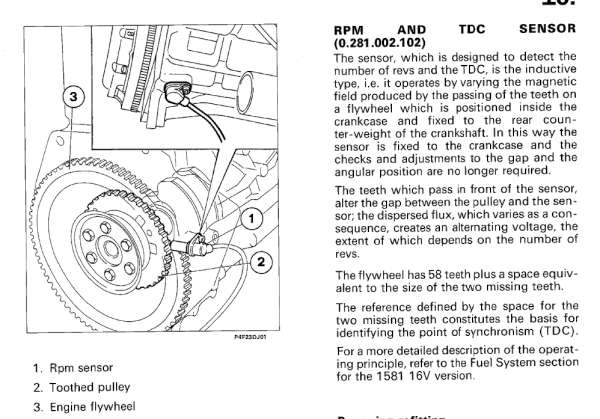

Having problems locating the position in the engine of the RPM sensor. I'm sure I read one of the posts stated it was a 5 minute job to change it, but I've spent over an hour looking for it!
Any ideas?
My car cuts out intermittently and I have to wait for 10 minutes before restarting. I'm guessing this is the probable cause as it appears to be temperature dependent.
