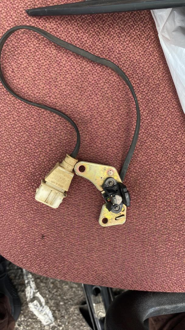

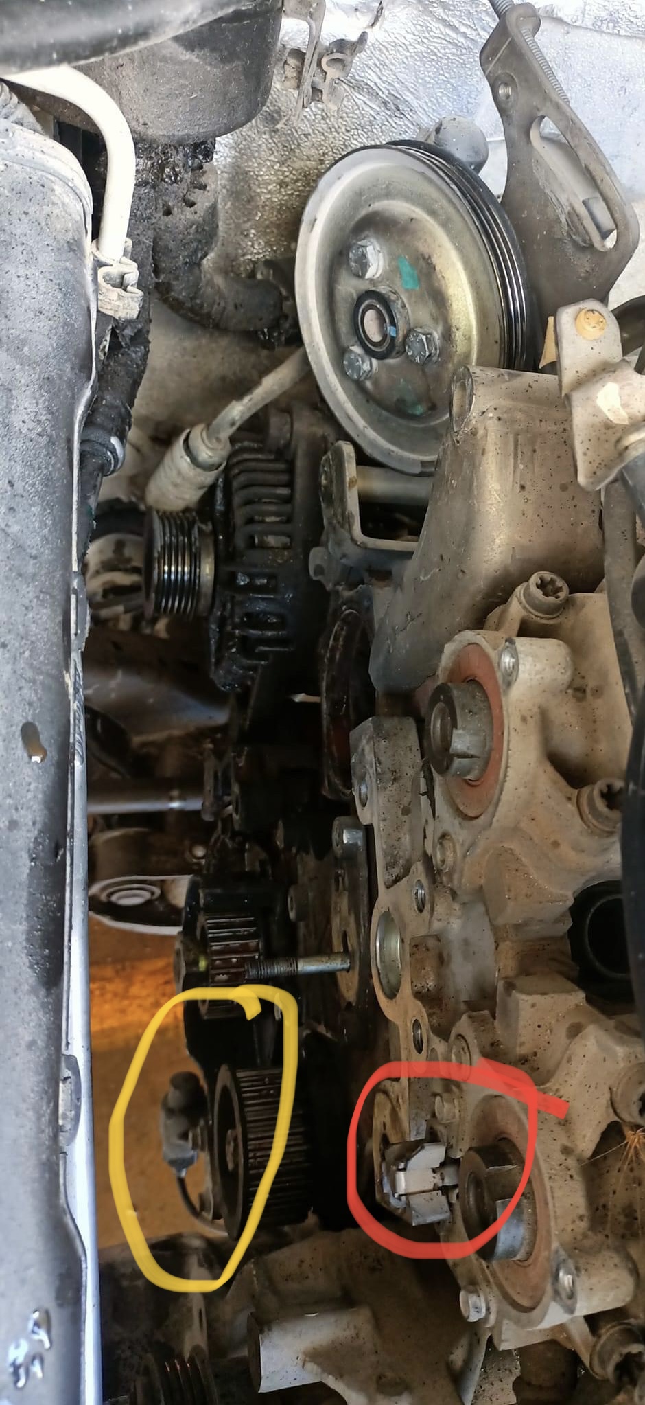

Hi everyone, where should I order a new brand Camshaft Position Sensor for Fiat Marea 1.6 16v??? I need to buy this for my Marea.
Please bear in mind that if Crankshaft sensor (TDC) faulty, injector
light will not illuminated at
the instrument panel but for
CAMSHAFT POSITION SENSOR , the injector light at the instrument panel
will be lluminated if the
sensor fails.
The Most Common Failure Camshaft Position Sensor and TDC Sensor Symptoms FIAT MAREA 1.6 :
1. Vibrations in the Engine
2. Slow Response from the Accelerator
3. Erratic Starting
4. Misfiring of the Cylinder
5. Stalling and Backfiring
6. Loss Power
7. Final stage engine cannot start

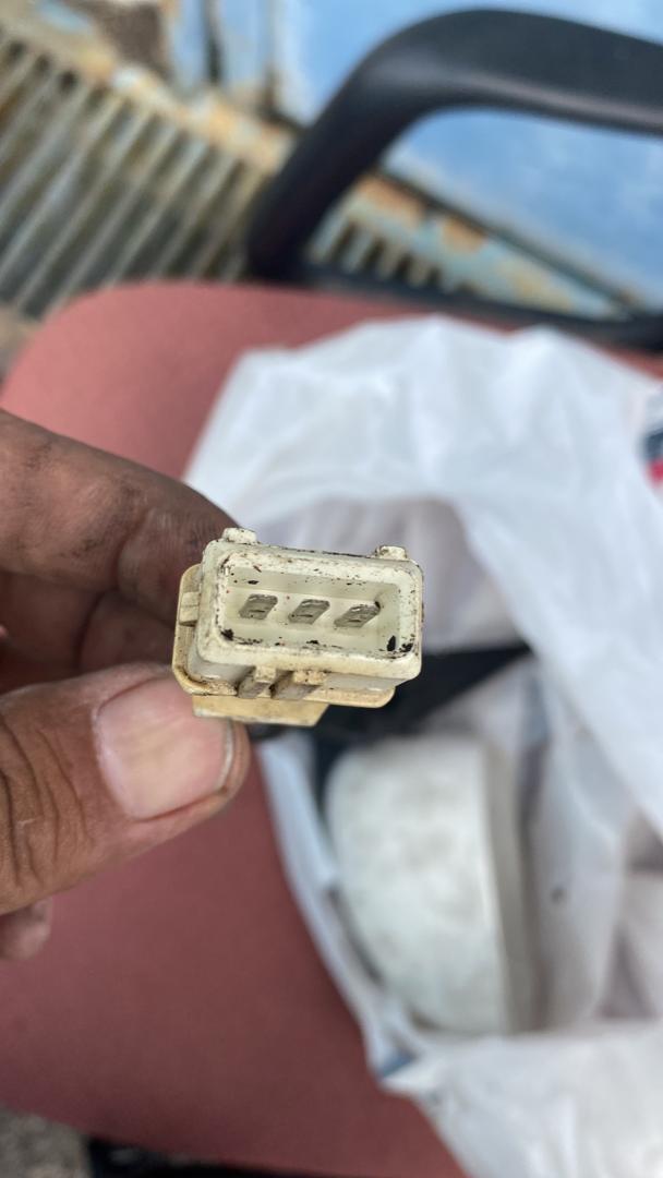

Have you checked the basic function of your sensor ? ( I appreciate your marea is unlikely to have OBD2 connection)
But a symptom..or error code might help
I already diagnose my Marea’s ECU using Fiat 3pin connecter together with AlfaOBD application..the faulty code shows Camshaft Position Sensor Faulty..but for TDC sensor does not have faulty code (Dont know why fiat engineer not make the error code number for this sensor)
