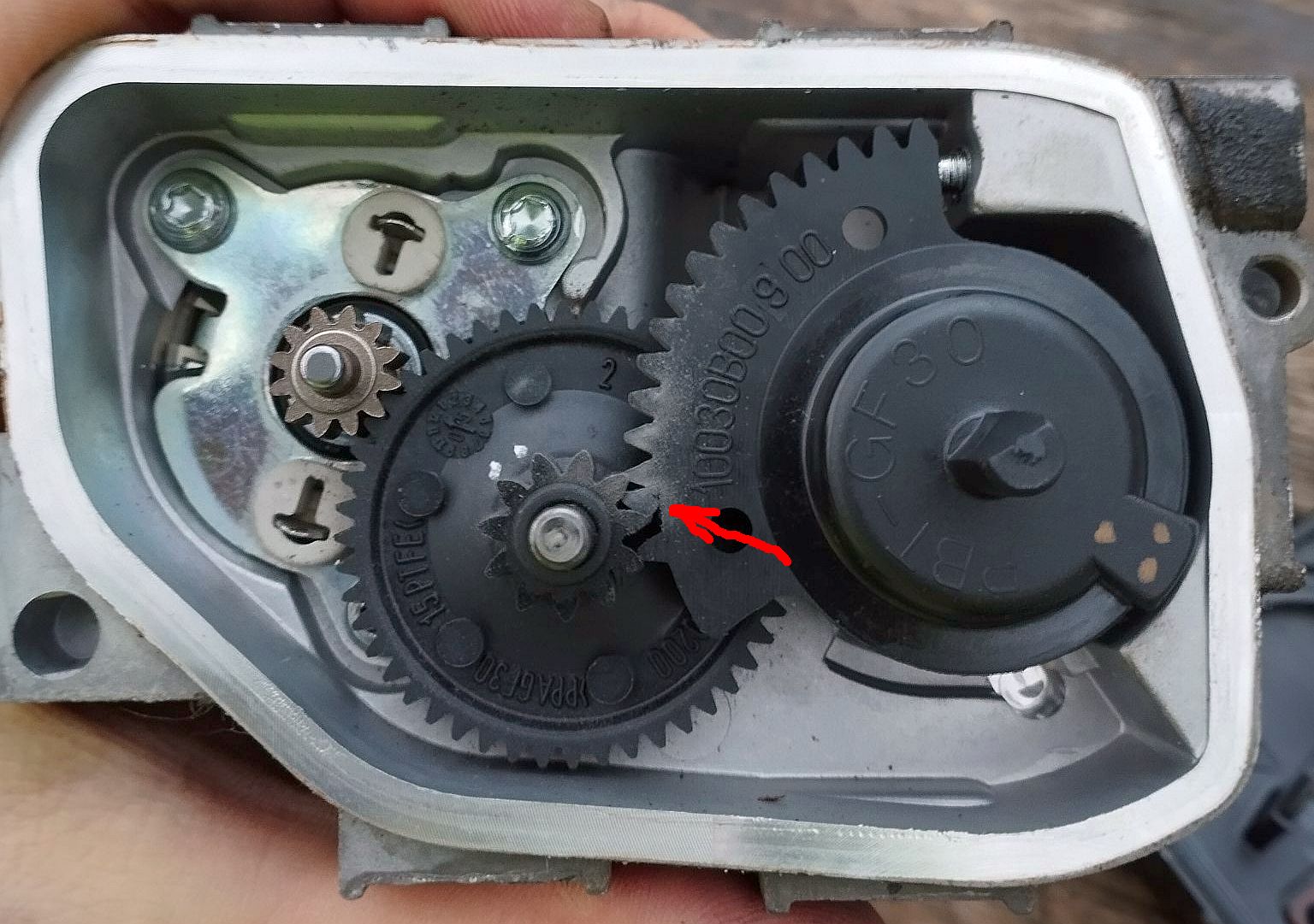

Do you have regular/normal throttle, like non-CNG cars? Try this Guide for Grande...
https://www.fiatforum.com/guides/throttle-body-disassembly-porting-testing-1-4-8v.723/
Faults are electrical (motor or potentiometer tracks) or mechanical (for example broken gears).

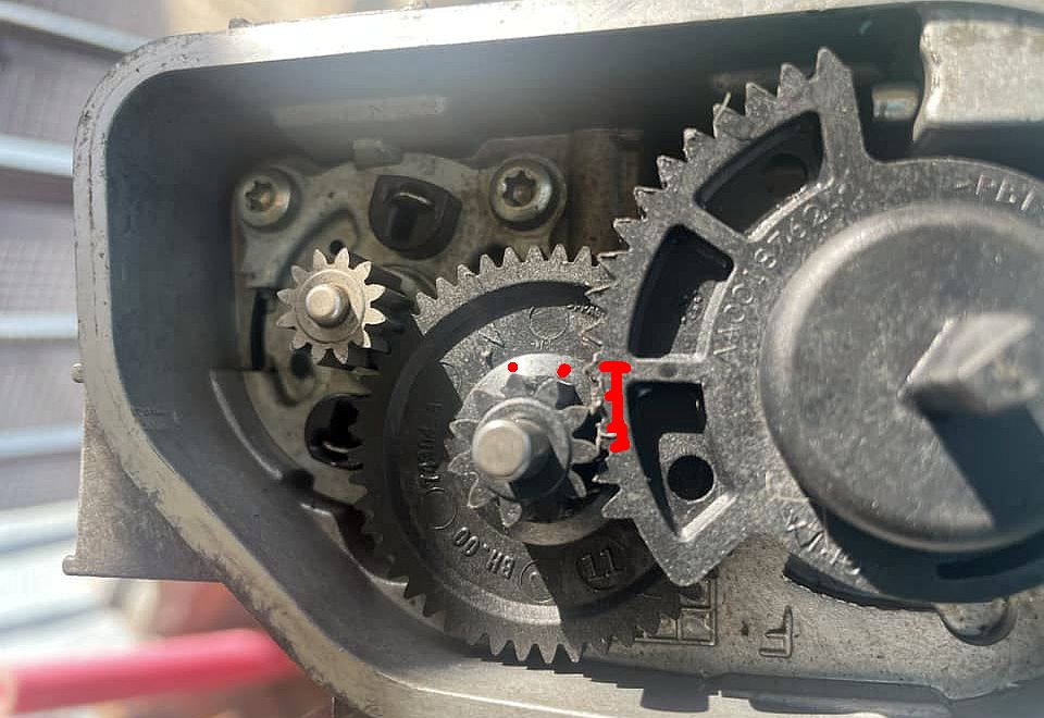

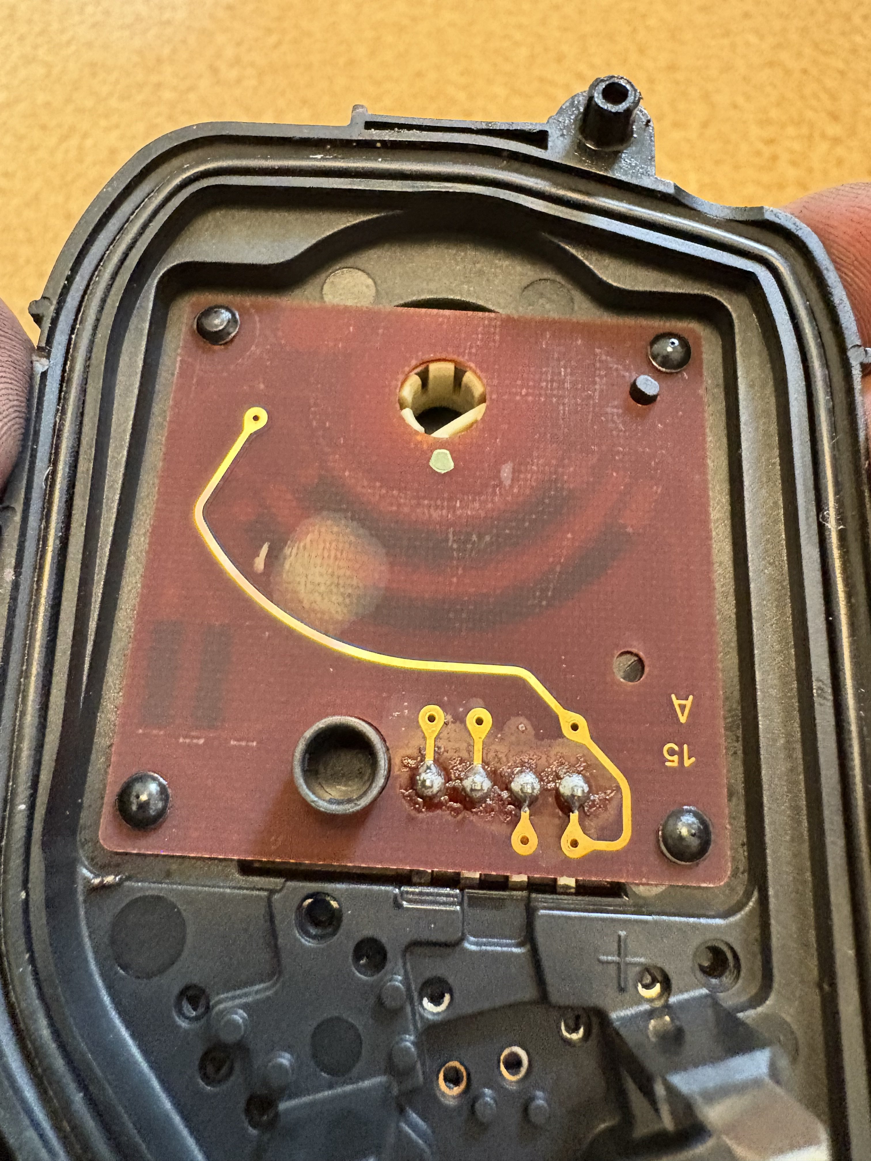

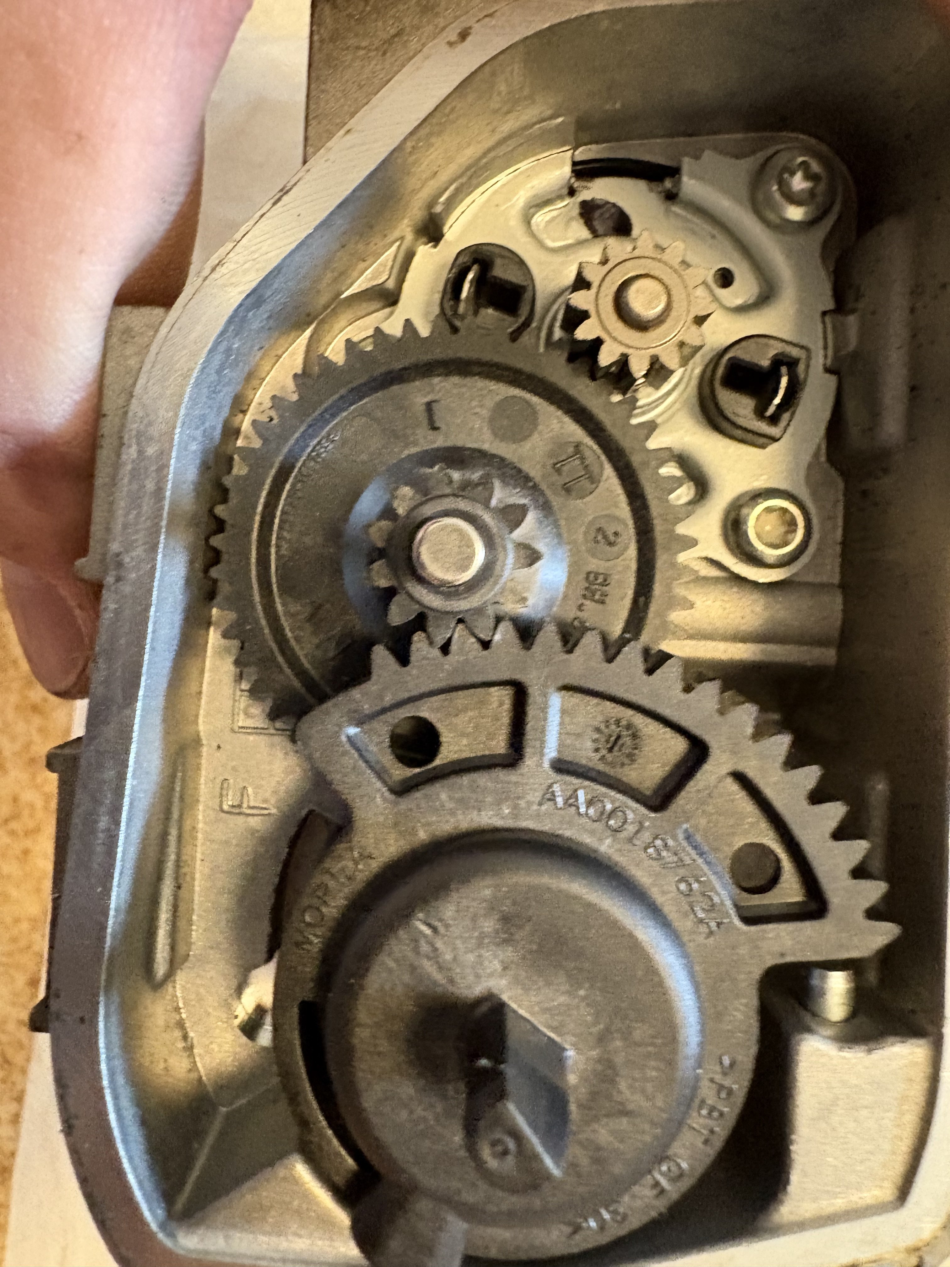

Tooths are fine so i guess it probably is electrical fault…and there is weird shiny spot on pic 2, might this be na issue ? I cannot check other side as it is welded in …

Does it correspond with the dead position on pedal?
Pedal data works smoothly by 0.4% even in this dead rpm zone so i ruled out pedal, this dead spot between roughly 12.2-15.5 is reported only on throttle body so i guess this might ve na issue, ive ordered used one for roughly 40$ so i will try different throttle body and will see if issue persists or not.

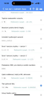

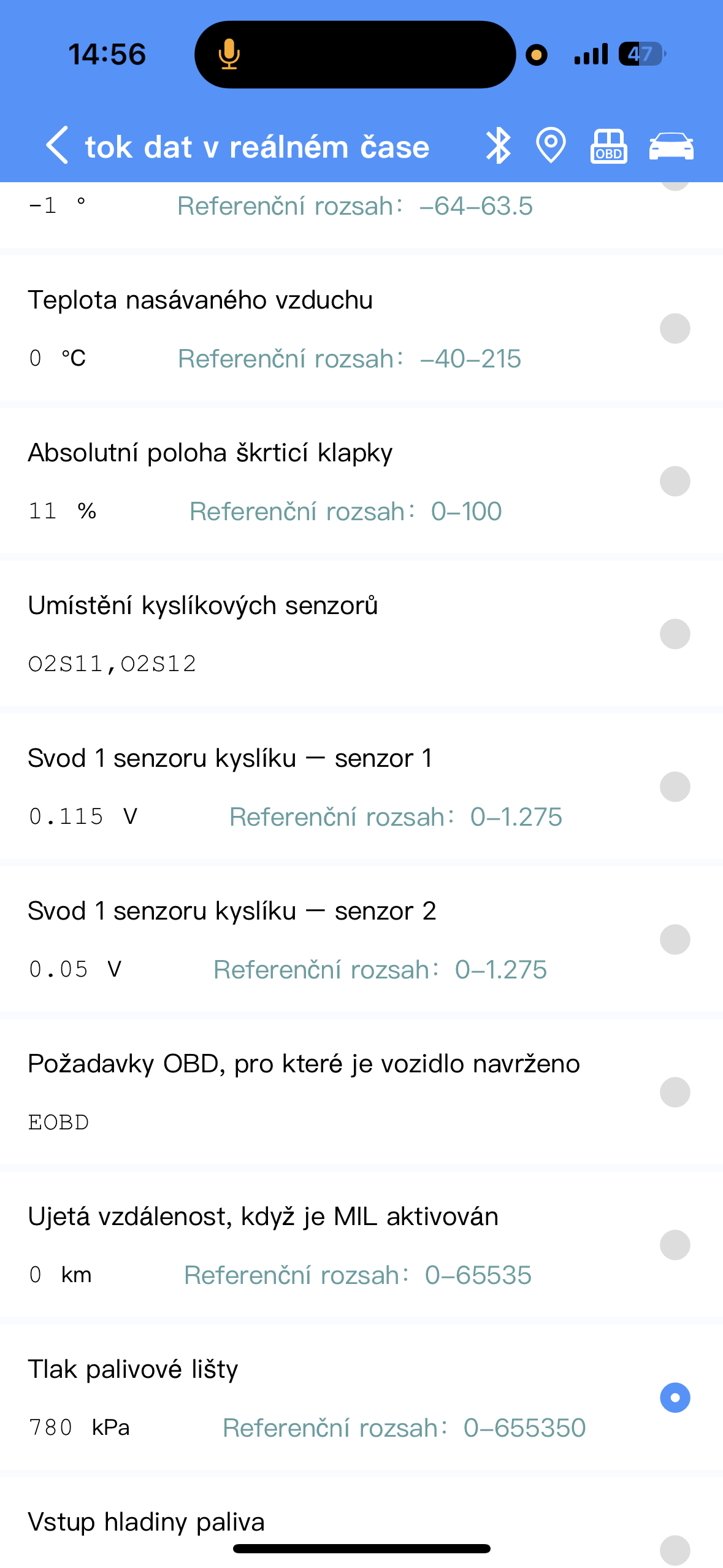

Update:replaced TB with used one, same result however i noticed difrerent values in o2 sensors, see pic below, might this cause ?

Use Windows laptop + FES or MES and collect data (CSV file), then make XY plot, not screenshots like that (mostly useless).
Try to replicate a graph like mine. Otherwise it doesn't make sense ("diagnosing" a car like that - by screenshots).

In the 1200-2000 RPM range, the VVT starts to operate while driving (>2000 when stationary)...
view
That's another thing to diagnose (besides throttle/gas pedal and lambdas - you watch graphs too - fuel pressure, MAP sensor and so on).
Speaking of oxygen sensors: take an emissions test (exhaust gas analyzer). Only then you can judge what the engine is really doing.
Lambda parameter alone is not enough to diagnose a combustion process. Basic/primary fuel is a petrol/gasoline. You reset "self-adaptation" values (again, only in FES/MES or AlfaOBD for smartphones) then drive a car on petrol only for a week minimum. Then you can try to switch back to second fuel (LPG, CNG) and observe the changes (alternative fuel can spoil the ignition/injection maps - car will struggle to pass emissions on both fuels).
First sensor (upstream, before cat. converter) is for fuel control, ECU intentionally swings it 0,1-0,9 V, oscillations about 0,45 V average (lambda 1,00). Oscillations are there even at high RPM speeds (if the sensor is healthy).
Second (downstream, after cat.) is for catalytic converter monitoring.
So OXYGEN sensors react to the oxygen level difference between exhaust and ambient air.
If cat is OK, readings must be stable (in steady conditions, like idle or driving constant speed), no oscillations. If conditions change (you step on the gas or release it), there should be a time lag (about 1 second) somewhere on the graph, it means again that "cat" is alive (has some "capacity" in terms of chemistry, it can "store" some gases). Value at least magical 0,45 V or more (that's good, means all oxygen was consumed and hopefully fuel burned completely - which is confirmed by exhaust gas analysis). Under 0,45 is "lean" (true for both sensors), but the cause can be manifold leak for example (not "lack of fuel" like car is not capable of delivering it).
Most common misconception is, that downstream above 0,45 volts means "rich" (which is bullsh*t). People mix both lambdas up/down stream (and what's their purpose) and air/fuel mixture before and after the combustion took place (resulting exhaust gas composition)! Two different things.
