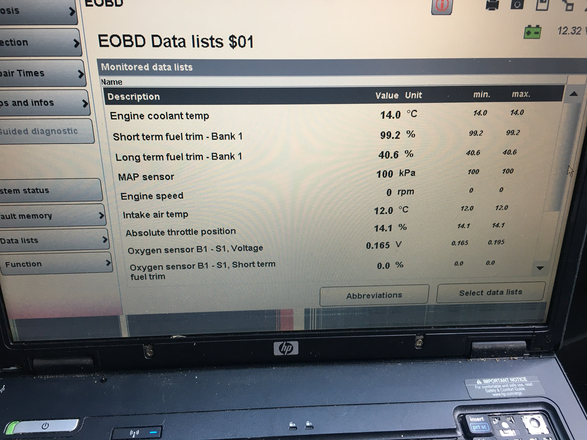

My panda 1.2 Mylife has developed a rough idle. Sounding and feeling like it wants to cut out but doesn't, the idle rpm drop below 650. Connected an obdii to it and shows no error codes. I replaced the spark plugs, ht leads and gave the throttle body a clean which all helped a bit. Now it is still rough(not as bad as before) but rpm slowly builds up to normal followed by a dip in rpm then jumps to normal idle, mostly with a cold engine. The throttle body doesn't seem to have an idle control valve in it, just the butterfly flap and no obvious air bypass valve. Any ideas where else that would be? or other things I could check myself before handing it over to a garage?
thanks
