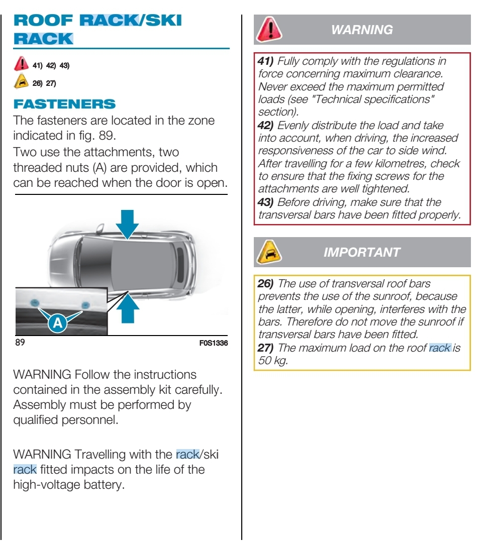

I have been looking to see if you can fit a Roofrack on a 500e - and I can't find a picture of a 500e with a Roofrack. Which leads me to believe, that it is either very difficult or impossible to install Roofracks on the 500e. Anyone who knows if it is possible, and has examples of people doing that?
Thanks in advance for you help
I mean what I said. The car has mounts but no one makes a rack that fits them.
Ohh - that's amazing - well then at least there is hope for someone making some roofers that fit at some point. You would not happen to have some pictures of the mounts?
Page 72 of the manual 😊
How strange is that - how come no-one is making roof racks for the car then! And thanks for you very polite reply, and for providing picture from the manual.
