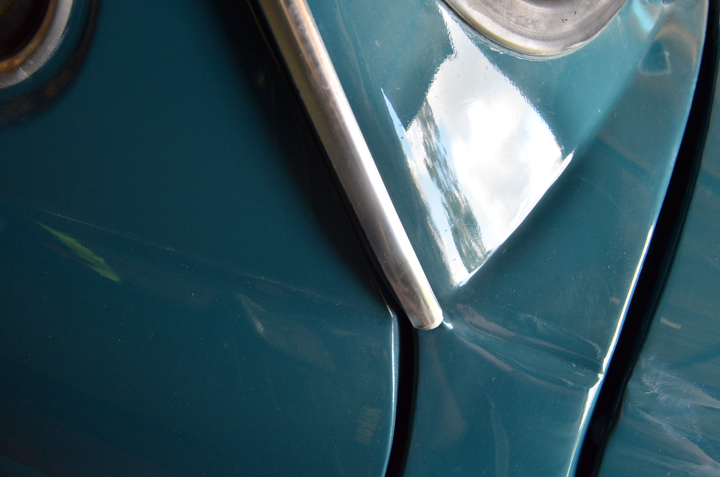

I used the polyurethane sealant that I used elsewhere on the car. It was fiddly but just a sliver all along the gutter edge did it. It also secured the sill trim that many people leave off to avoid making holes for the clips. It needs securing in odd places whilst it cures so have some means ready; I used the rubber ended quick clamps that are for woodworking purposes.

Thanks for the replies, appreciated. I have some sikaflex and a tub of these in the garage...
So hopefully I'll be ok, and thanks for the info on the seif tappers. It seems I'll go for the 10mm as your looks good in your photos Peter.
