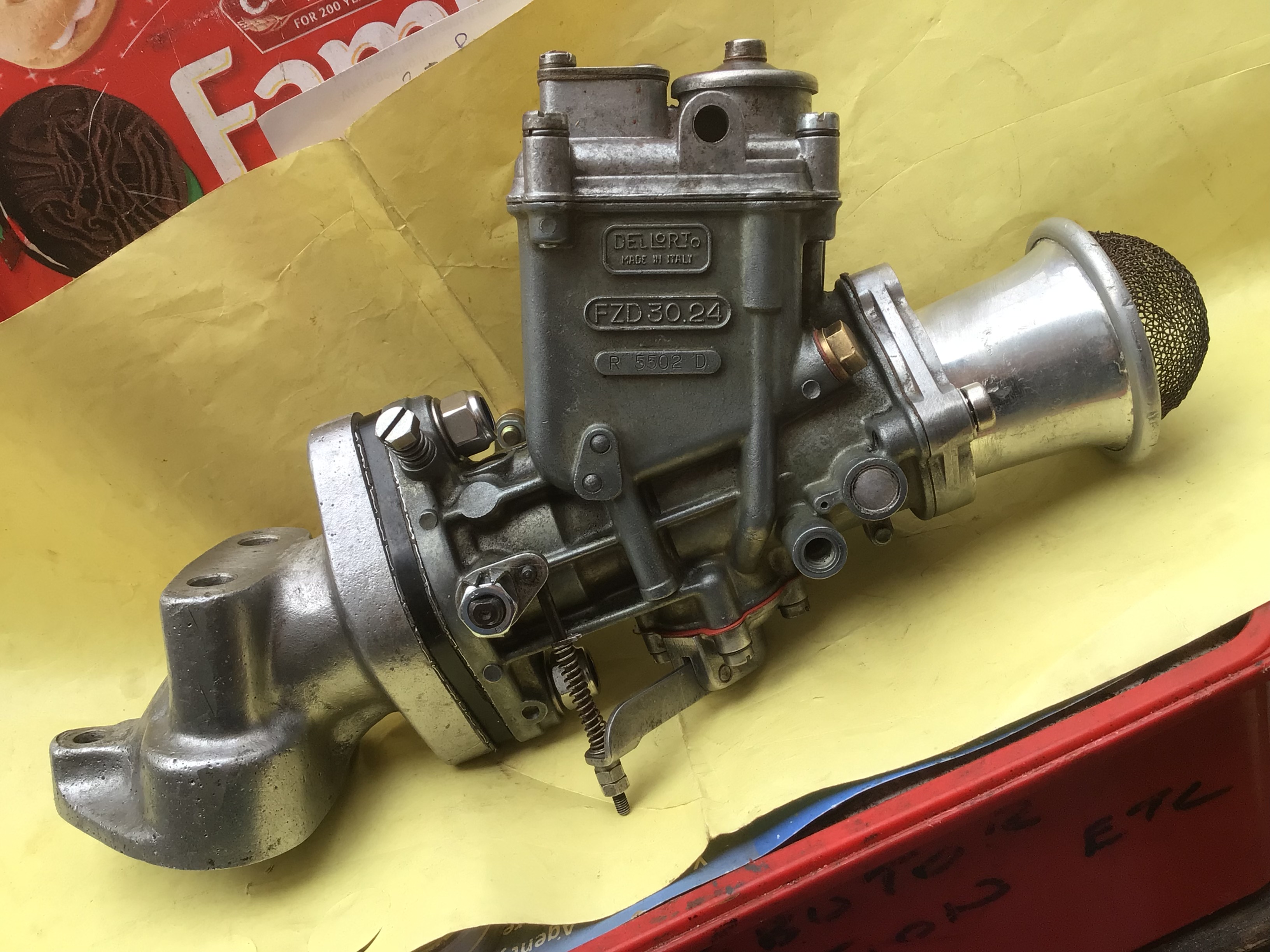

Did somebody call my name 🤔?
If "Toshi" has that Dellorto for sale, I would suggest that you contact him and "discuss a price". They are not cheap, but having used a FZD for about 11 years now, I reckon that they are about the best carb for performance for a "road-use only" car. They do not ( as the Weber carbs do) need a support and they stay in tune. Also, looking at the picture "Toshi" has put up, that carb has a 'gauzed' inlet trumpet---very rare nowadays. "Toshi" is a 'pucka' guy, and if that carb IS for sale---go for it as it is a complete set.
