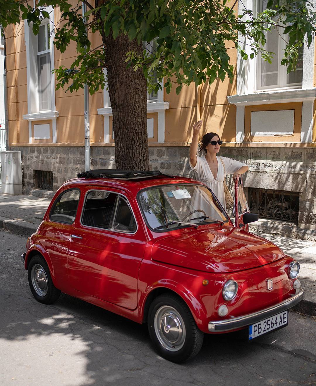

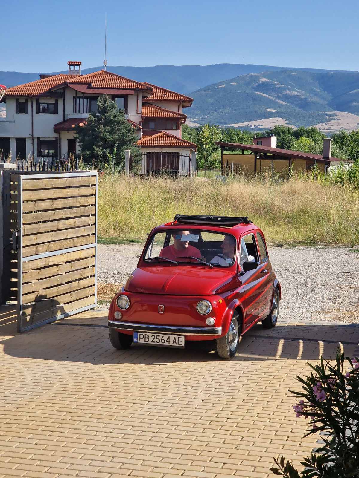

Me and wife always had a dream of owning a classic Fiat 500 and two months ago we managed to achieve it. We are the second owner of a 1971 Fiat 500L with 72k km on the clock. Our tiny spicy red pepper ( named him Peperoncino ) is one of the best decisions we've made. It is a pure joy of a car - every time I tinker with it I smile, every time I drive it - a grin.
Most of the bodywork has been completed already, so we got it as you see it - Rosso Medio. Only 1 problematic spot is left and that is the shelf above the engine which has rust where water gathers through the intake vent. I will redo the carpet cause they have ruffled and faded but all the rest is ok . Got a new fuel tank -old one was leaking everywhere.
