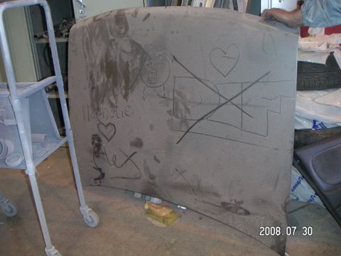

The hood will be removed later on, as soon as the time permitts, in order to make sure the bodywork underneath is taken care of.

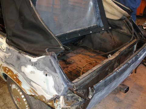

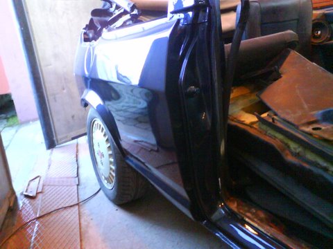

These 5 pics shows what happend after that the car has been left outside and was taken in again.
It's now time for it to strip the hood off, in order to find out what's behind
It wasn't as bad as we thought it might be.
However the right hand side passengerdoor window is not working 100%
That needs to be fixed.

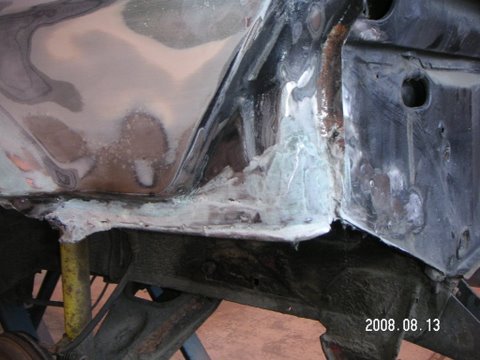

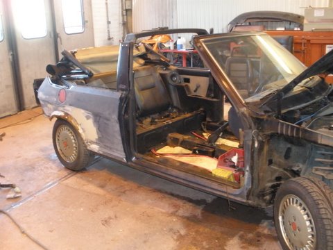

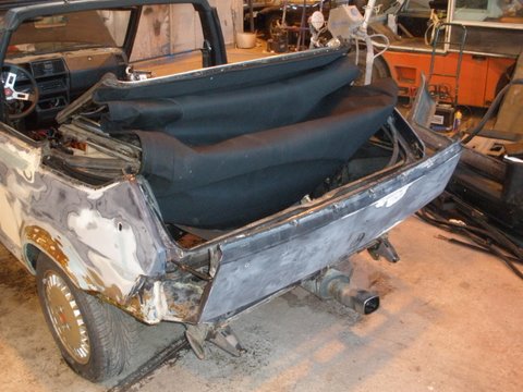

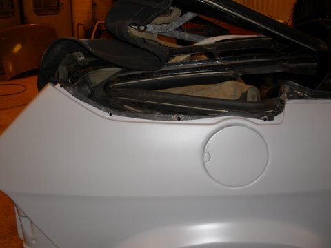

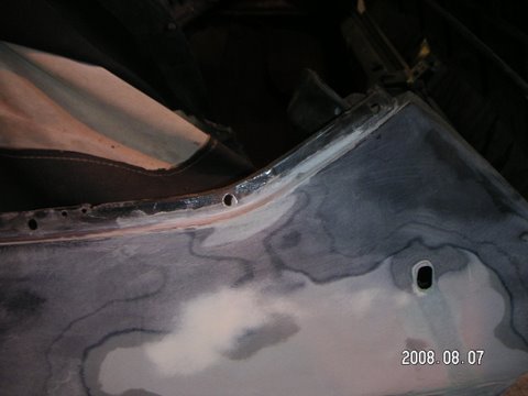

The edges on both sides of the hood has now been fixed.
Aswell the back corner of the edges where the wing meets the back.
Pics from both inside and outside.

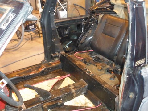

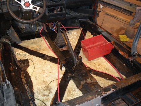

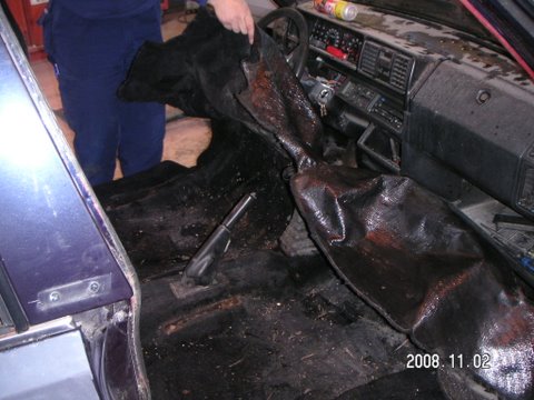

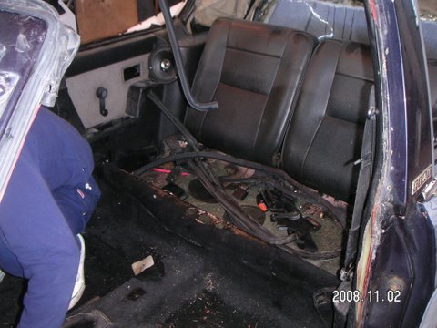

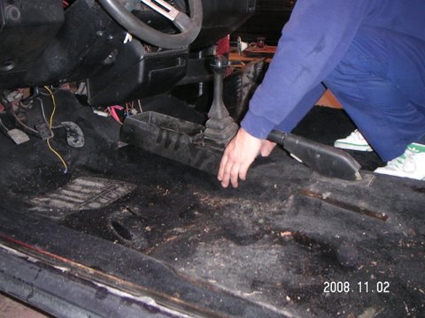

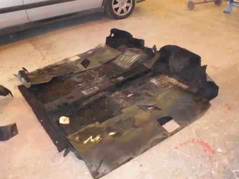

It was now time to strip the interior of the car.
The carpet needed to go to cleaning since it's been outside without door.
Stripping it wasn't the easiest thing to do.. but once you got the hang of it.. it was a piece of cake. :D
One VERY intresting thing was the cross in underneath.. was really amazed how well buildt the convertible are. :D

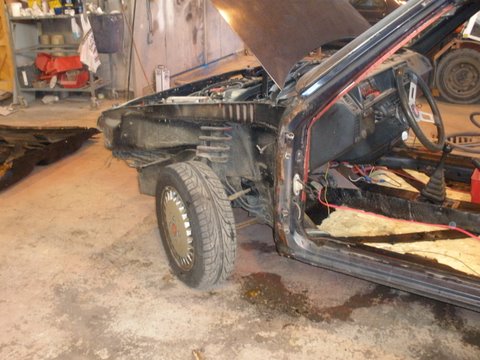

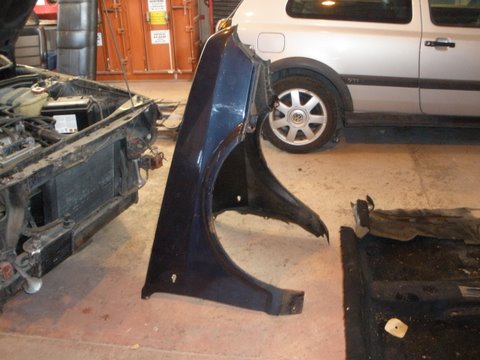

At the same time we stripped the interior we also did some outside work.
The front wings needed to be removed, as we knew there was some work to be done underneath
The Wings itselves are in very good condition...

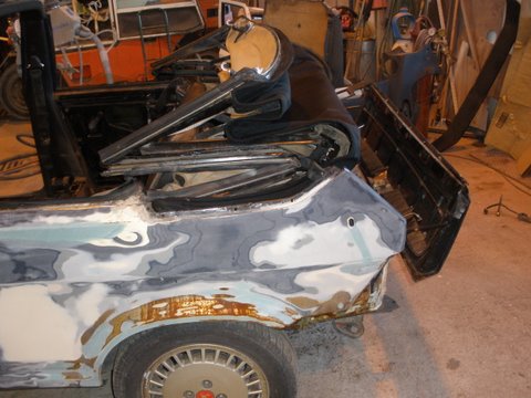

The Front wing tower ;)
aswell as releasing the hood from the back

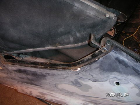

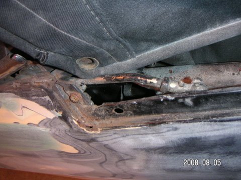

More pics on what it looked like when we stripped it.

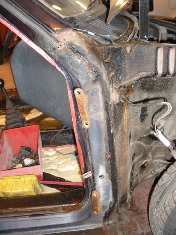

The "handle" that runs the right back window when we took it apart.
The last pics also shows where the worst rustspot has been, we noticed it when we removed the left front wing. Some welding needs to be done. ;)

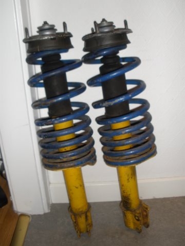

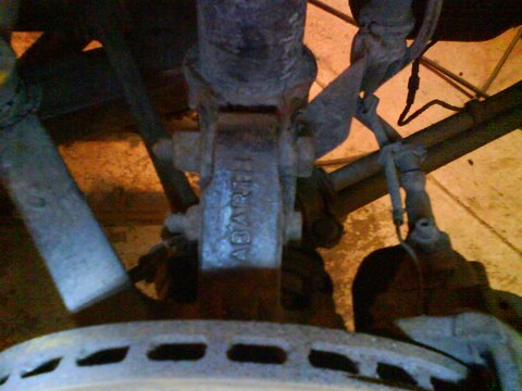

When i bought my other Abarth the seller gave me front konis.
I thought they would do well on my convertible.
On the second pic you can see how well the previous owners have done to convert the normal convertible into an Abarth

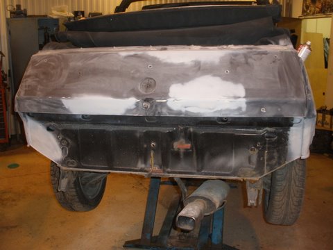

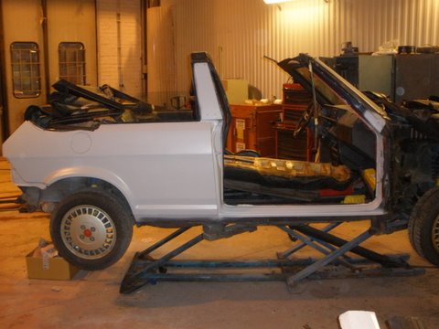

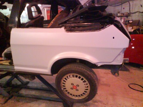

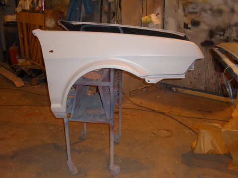

Before the car goes into the box for a coat of color it needs to have a base, in order to see ant make sure all the lines of the car are 100%
It was meant to be done in black, but we decieded to do it in off white.
It was done @ 2 diff times

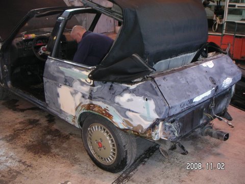

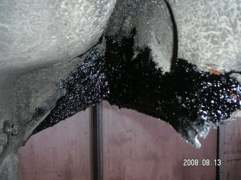

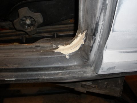

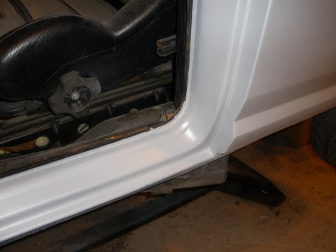

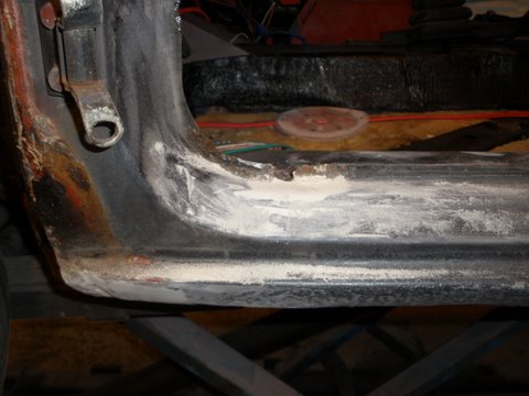

Some small patches of rust on the drivers side needed to be taken care of

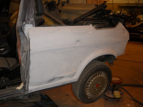

Finally the end is near..
The last coat of the basic paint were done

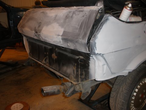

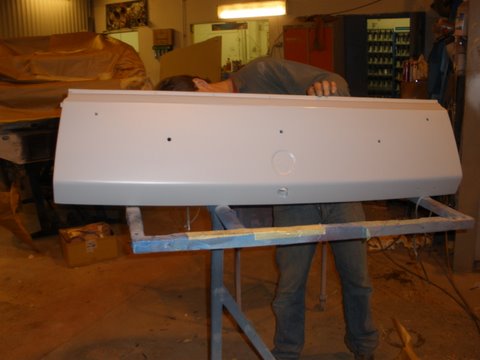

more pics
including the previous rustfixing on the drivers side, both front and back, the trunk and last but not least the fitting of the left bottom side of the left front wing

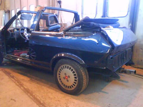

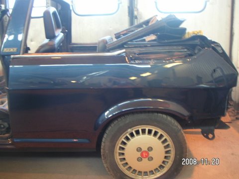

This is the final result..
In Blue, MicaBlue 407B :D
what a result.. still cant believe it ;) :D
