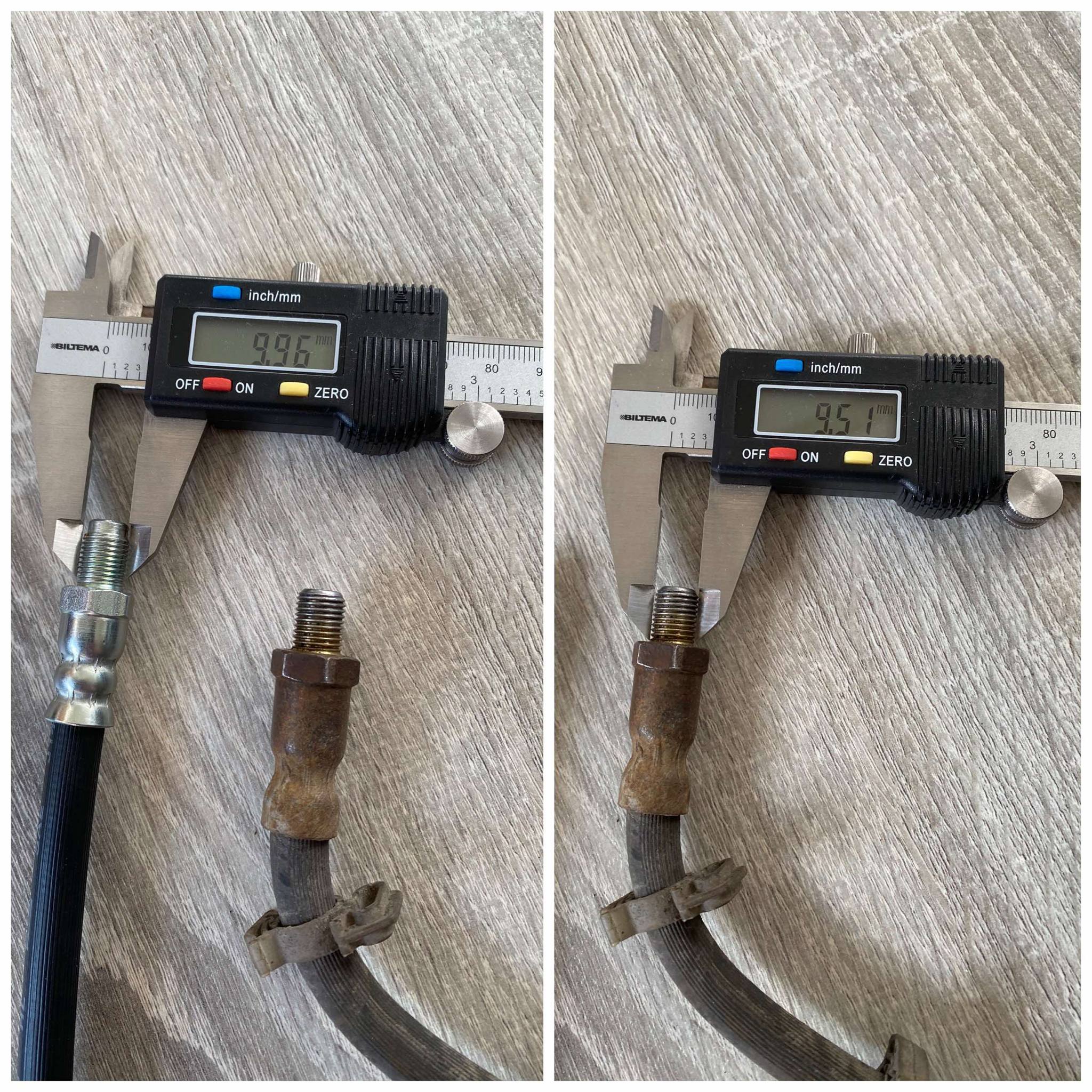

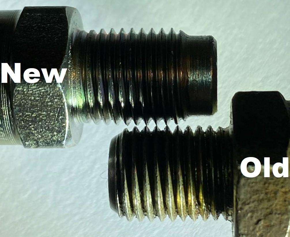

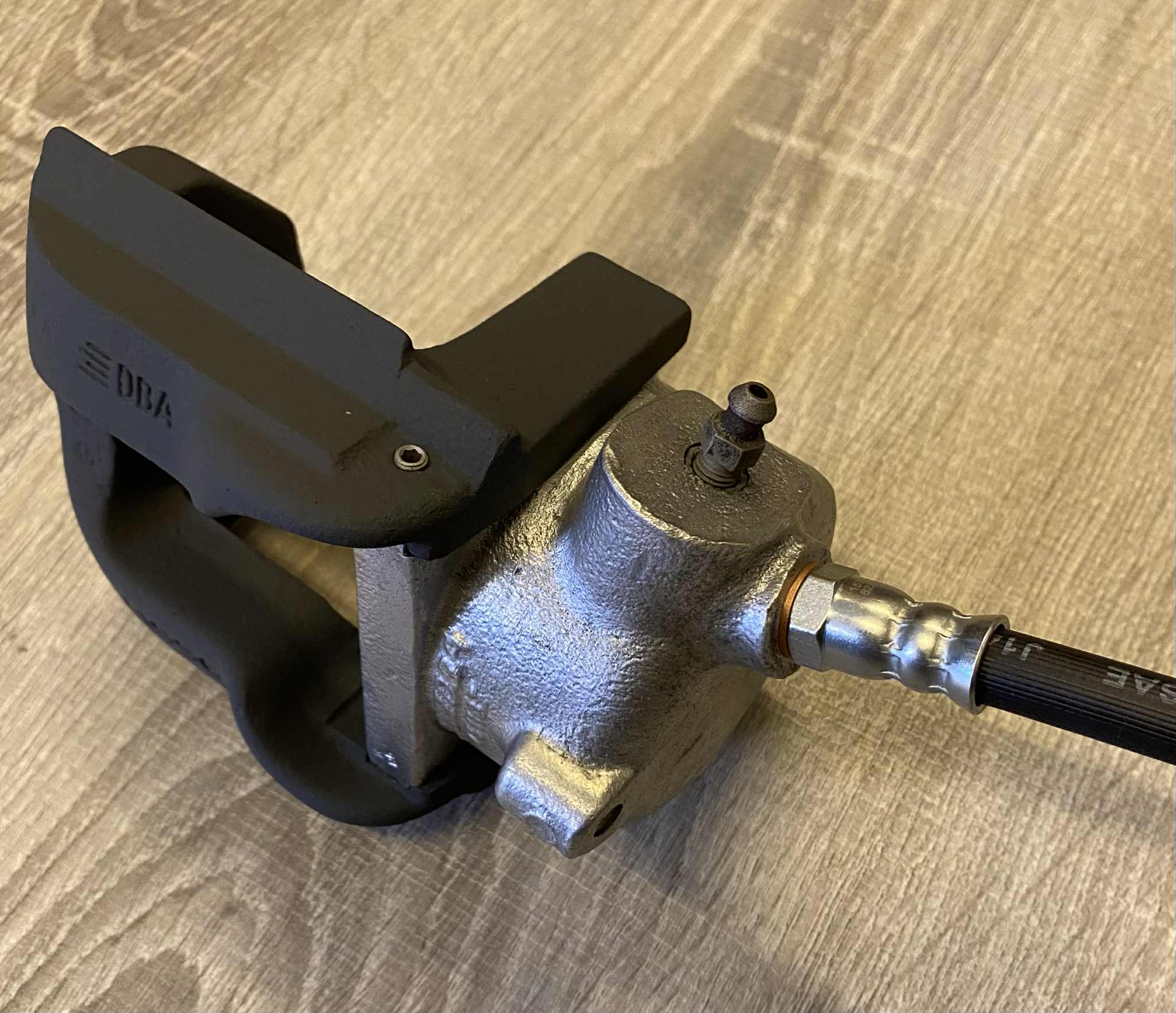

Hi all. I just bought some new hoses for the front calipers on my Ritmo Abarth but they do not fit.
My new Ridex 83B0360 hoses has 10x1mm tread.
When measuring the old hoses i looks like it's 3/8" x 24 UNF thread that is correct.
I have looked at several other suppliers and they all offer hoses with 10x1mm tread.
Has anyone else experienced the same thing? Where do i find the correct hoses?
I want standard hoses, not steel wrapped racing type.

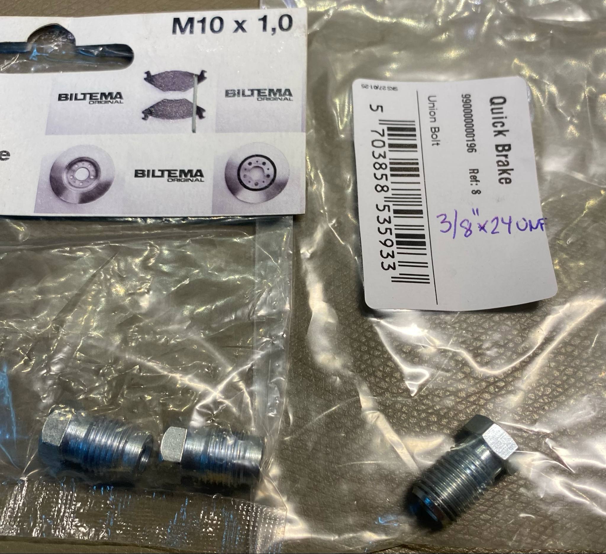

Thanks for your thorough answer S130.
Out of curiosity I bought two fittings with 10x1 and 3/8x24 UNF threads.
Only the 3/8x24 UNF fittings fits the 130TC calipers.

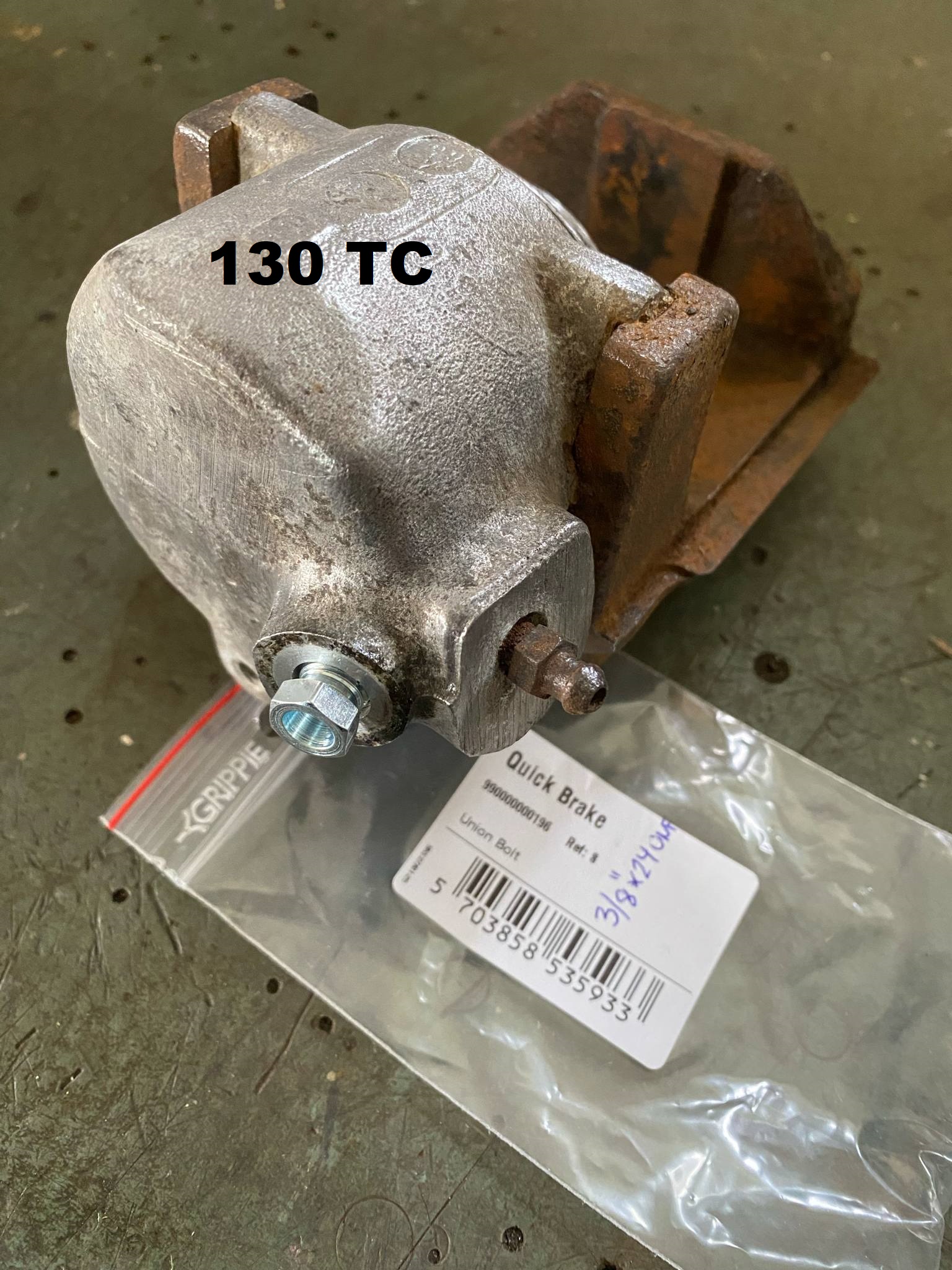

You are absolutely right S130. It's the diameter that is the problem. The pitch is pretty close.
Picture 1: I have another set of 130TC calipers and they are the same. 3/8' OK and 10x1 does not fit.

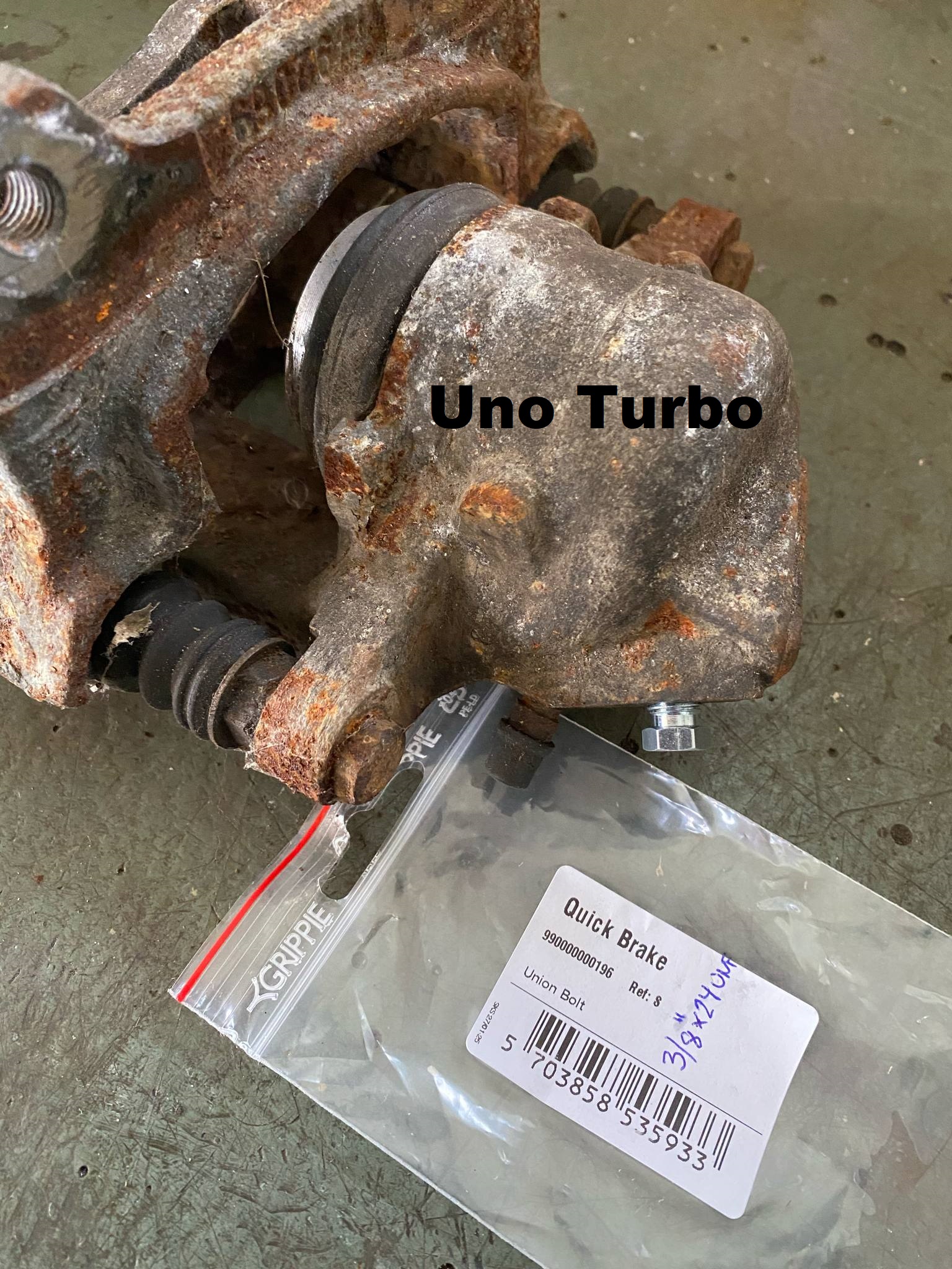

Picture 2:The 3/8' does also fit a Uno Turbo caliper (10x1) but is a little bit wobbly.
My new brake hoses are made to seal in the end. Not as the origials with copper washer on top.
If the threads were ok the new hoses may seal in the end as the hole for the breakfluid is in the sentre on the calipper. If not i can remove the unthreaded end of the hose and use the copper washer. Let's see.
I was hoping someone out there with a 130TC had experienced this. I don't like to use force to make things fit :)

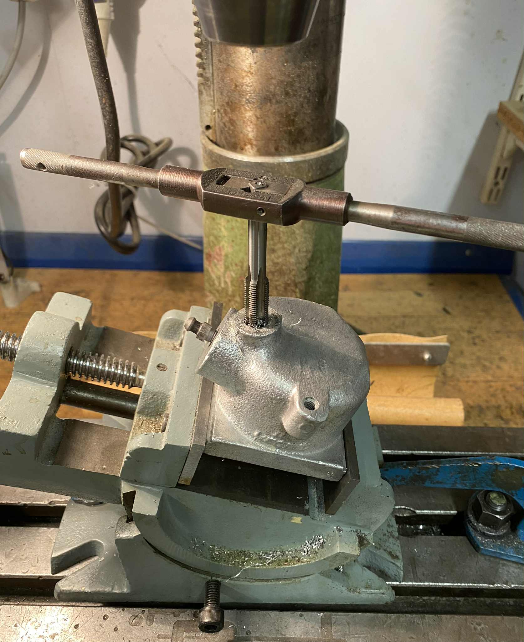

I have a 10x1 'thread tap?' so i am going to cut new threads. I'll give you an update on that.

Update:
Drilled and cutted new 10x1.0 treads.
Using the original copper washers.
Project finished.
This is a realy odd problem ,so if there are other 125/130TC owners out there getting the same problem please comment.
