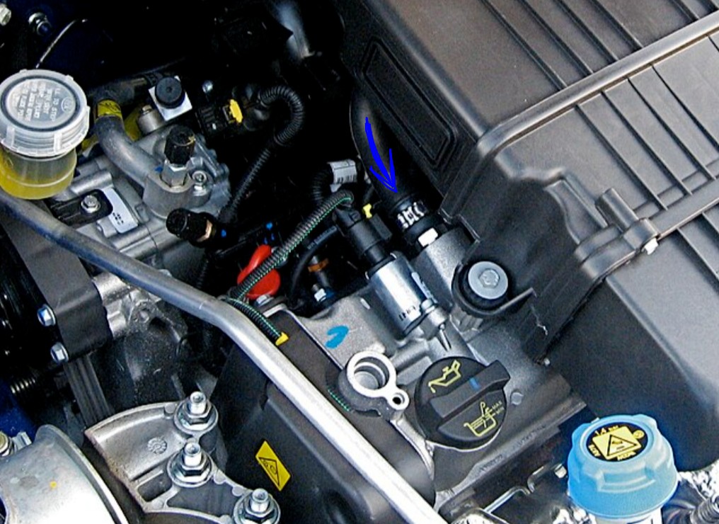

I would undo the bolts holding throttle body and lift it up and clean the pool of oil that "probably underneath
You don't have to remove the wires or anything

Push a rag through to the the Map sensor hole
It fills up
The problem is the blow by gass arent being sucked in an burnt properly
Confirm first just disconnect the pipe and see if the problem disappears
We will sort out the reason later once it's been confirmed

The blowby gasses are sucked back into the engine to be burnt off
It controlled by vacuum
Depending on throttle opening it is either sucked in under or above the throttle body
It needs to be in good order to work properly
The breather pipe
The grommet under the air box
No leaks or blockages
I had the little pipe completely blocked before now
A quick and dirty test is to remove the pipe so the gasses aren't going back into the intake, if it's fine you know the problem is likely caused by one of the above
Of cause it's not good for the environment to vent into the atmosphere, but to test it's fine

The breather pipe
If cause it's not good for the environment to vent into the atmosphere, but to test it's fine
