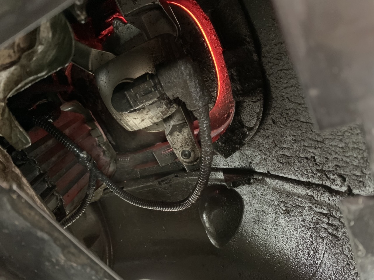

Simpler than that. There’s a plastic ‘door’ in the rear wheel arch which unclips. This lets you see and should let you reach the reversing light just kneeling alongside the car. My manual *does* mention. I’ll add the instruction from that in a mo... where is says ‘adjust the tabs A’ it means ‘release the clips’ - you can do it with your fingers.
Note: the bulb is a push fit - do not twist the bulb to remove it - just pull. Its an odd one – 16 watts type 921 push in (not something you find in most 'sets' of spare bulbs). See here: https://www.eurocarparts.com/p/osram-921-bulb-12v-16w-twin-pack-48177037T

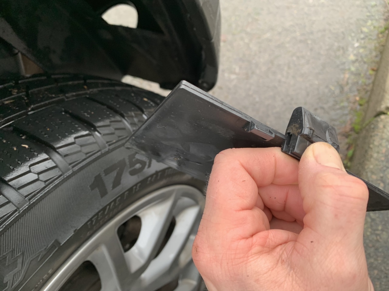

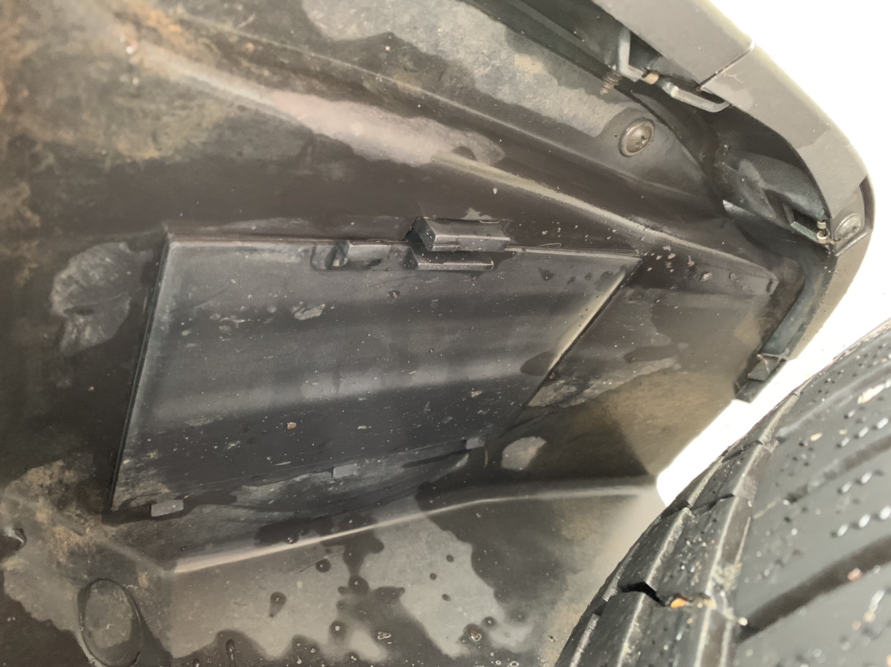

To help further, some photos taken while giving the wee beast a quick wash. The removable door has a catch that you squeeze between finger and thumb, plus a helpful tab alongside which you can use a finger your other hand to pry the door open. Because the wheels throw muck at the door, the catch on mine was hard to move as it was full of sandy mud. Clean that out first then the catch will work. On refitting, there are three angled tabs at the ‘hinge’ end that help guide it back into place. (These stay ‘outside’ the opening). The first photo is sideways on - the catch is nearest the edge of the car.
