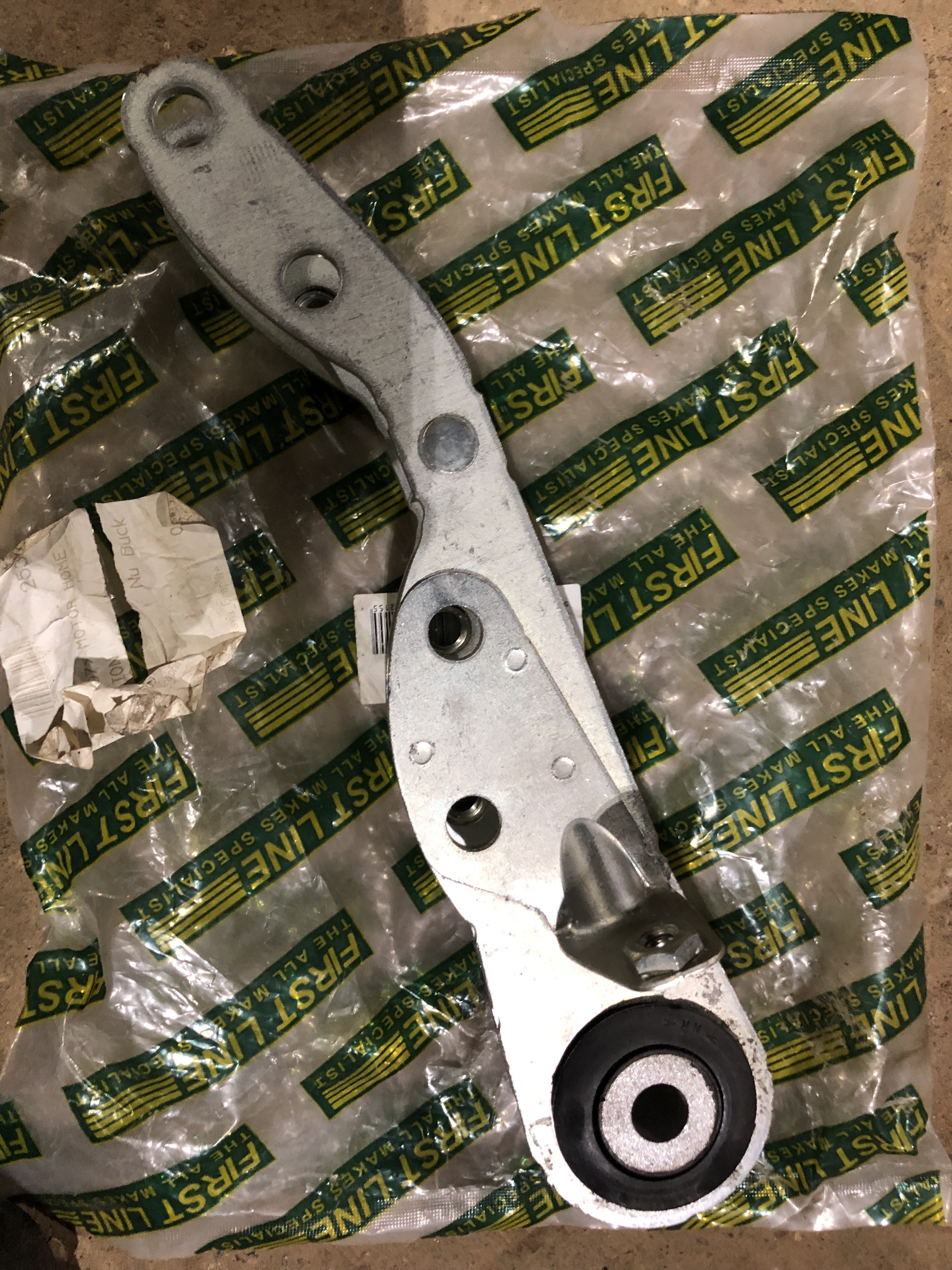

well i’m starting to think that i will just be riding the clutch when reversing which is a bit annoying, So for now i’m concentrating on the 6th gear stick wobble. i found the mystery part that came with the van, i guess it’s not the dog bone but it’s connected to it ( feel a song coming on)
got the old bits off the van and will order up new mounts top and bottom . if this cures the stick wobble then i’ll leave the box alone and just try and find heavy duty clutch unit to fit

So fitted both new bottom mounts today and it has vastly improved the amount of movement on the stick in 6th gear, i haven’t investigated the engine top mounts yet would your thoughts be if i changed these that it would improve it further?
Now i minded to leave the box as is, As fitting a lower reverse gear in this model doesn’t seem possible.
