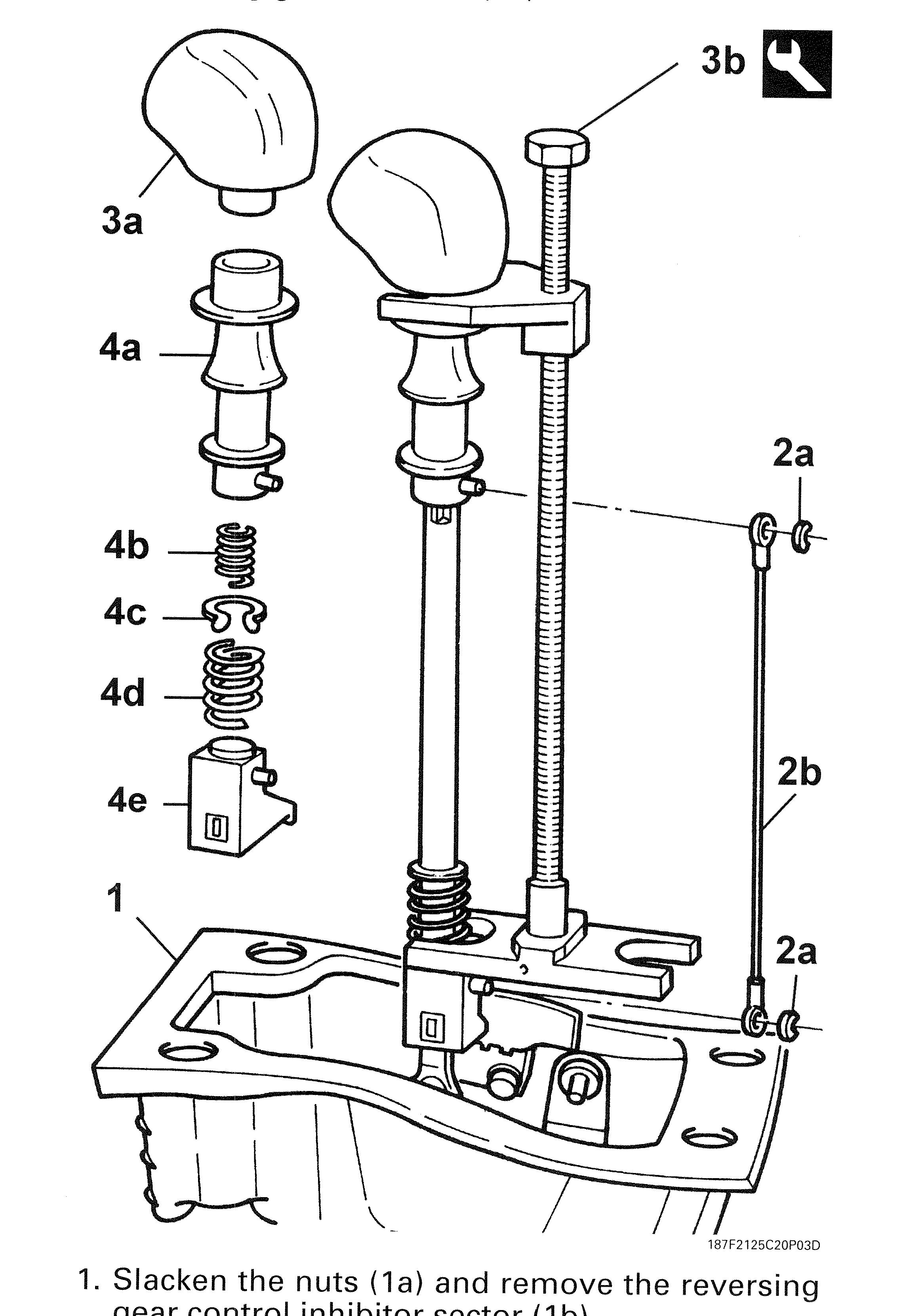

On the Sei Sporting it's like this
(best pic I could find): no physical connection between inhibitor cable and gearbox whatsoever.
Bloody Seis, doncha just hate them?
Its even worse picture when you read the legend and its going on about 1a and 1b, when the picture has 2a and 2B!!
Does that cable not then trigger the same cable to the box as a Cinq? Or is it inside the selector box itself that the detent is?

I recon not. Somewhere in the Porter one it has the full pic and there are only the two main cables.
When I did the Sporting box into S transplant I just used the two Sporting cables and the S lever and remote: no reverse inhibitor at all!
I've yet to try going from 5th to reverse -- methinks you'd have to be very strong or very unlucky to do it!:devil:
