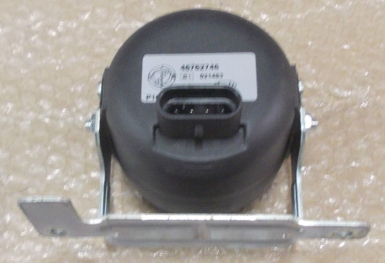

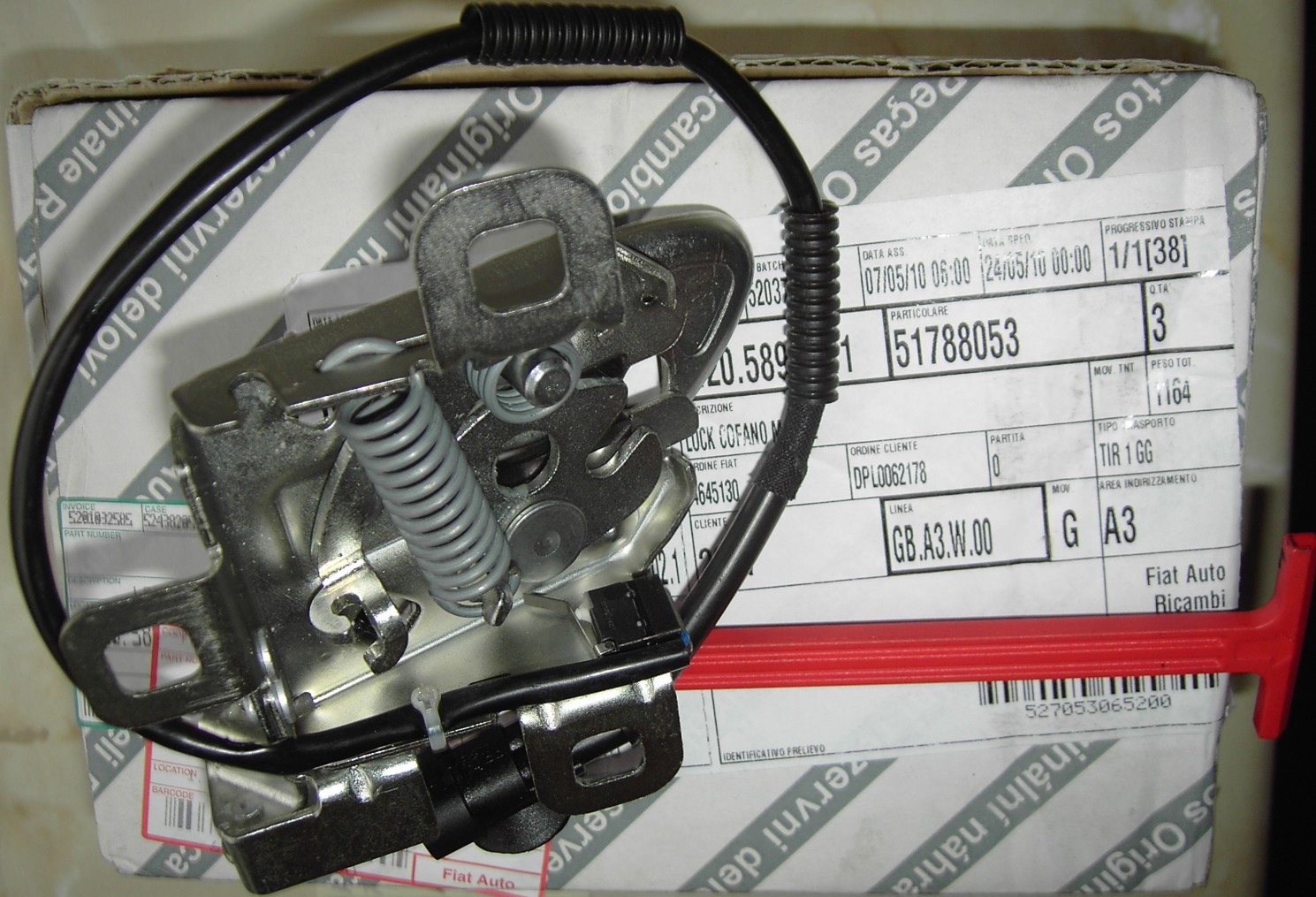

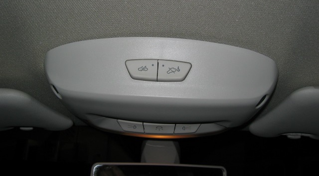

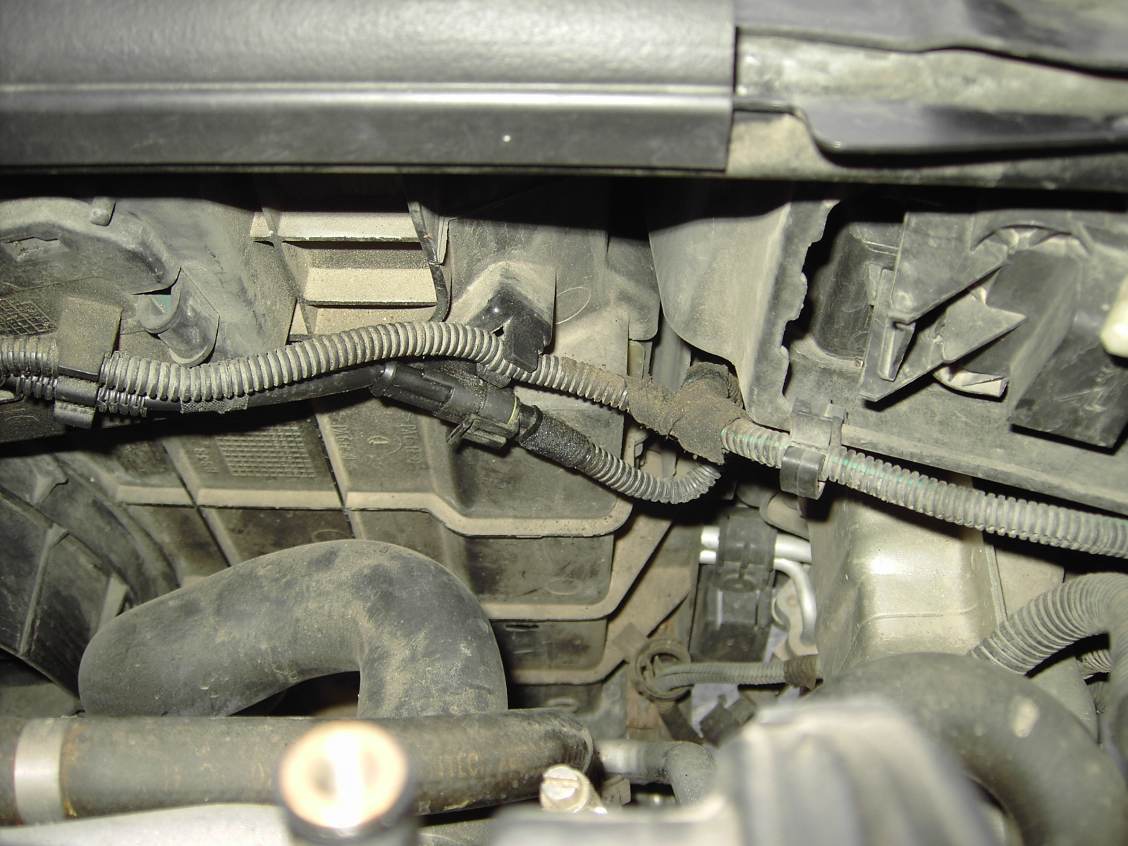

Probably just the alarm siren with built in control unit, front interior light switch with alarm control buttons and the bonnet lock with built in switch. Wiring connector for the bonnet lock switch is probably already hanging from the front wiring loom
Having wired it in, you would need to carry out the proxy alignment procedure to register it with the body computer.

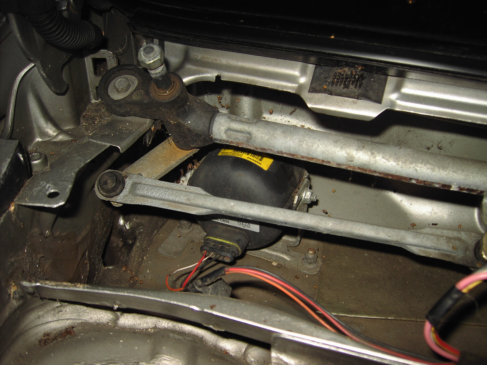

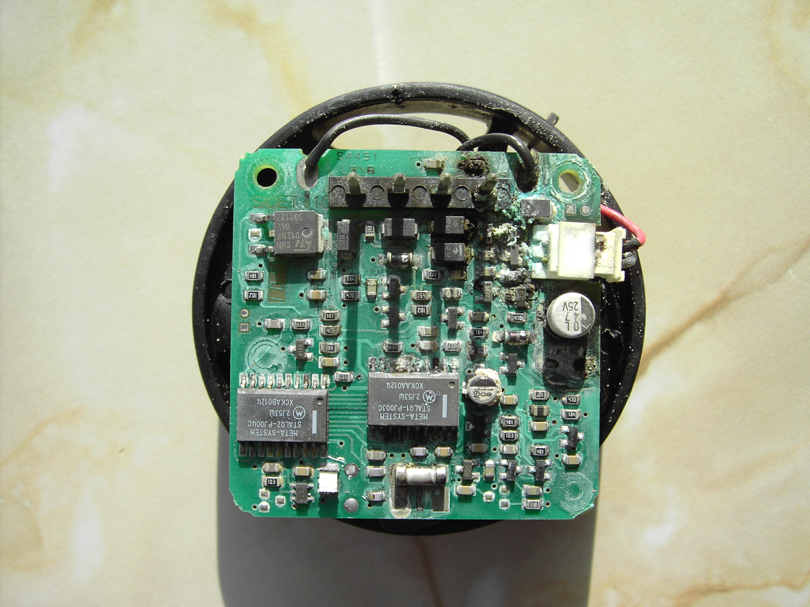

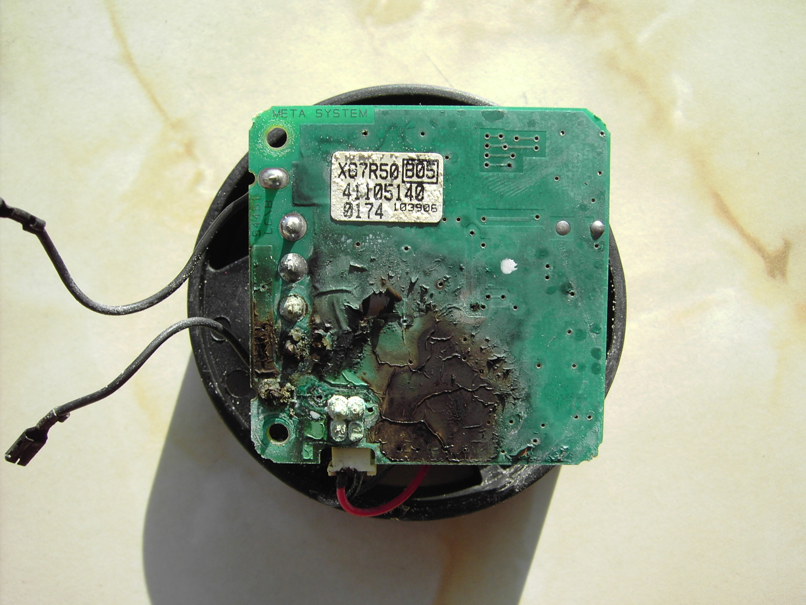

If you plan on buying a second hand alarm siren unit, many of them have water damage.
