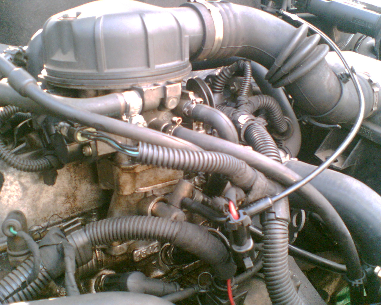

infact is there anyone with a picture or diagram of the tb pipes? i had that thought that they were connected wrongly, but would like a picture before i tinker them around... dont want to do any damage to the engine.
Finally got a link to a picture of my tb. Are my tubes/pipes connected correctly? - also, it was mentioned above that my irratic idle could be due to air being able to get into the engine due to a possible leaky gasket, but why does the engine stop idle'ing irratically when i have the vacuum hose disconnected?

Sooooo can anyone tell me if the pipes on the tb are in the right place, mainly the vaccum pipe. Also would it be dangerous to the engine if i drove around with it disconnected?
If the vac pipe isnt connected it will idle at about 6000rpm, theres no vacuum in the inlet manifold....
Its very dangerous Id think yes as it also means youre operating the brakes with no servo assistance, and that means its harder to stop.
Id check the vac pipe is sealing alright
