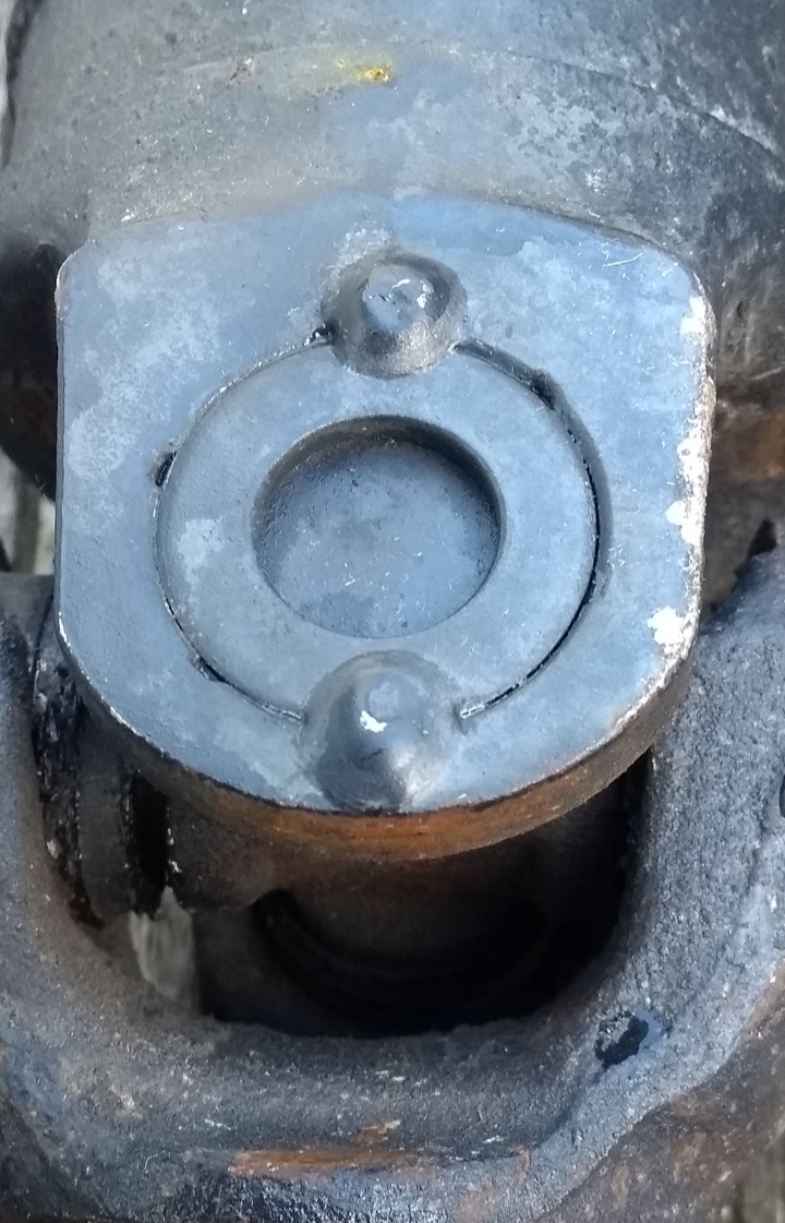

The bearings are peened in place with punch marks, there was no wear in the UJ prior to it being damaged by the aforementioned mechanic so I think just the bearings being changed will be fine , I just need to know what size they are.
I've already searched for propshaft services and the cost is prohibitive so I want to change the bearings, I've done it before with this type on a tractor but previously I knew the sizes to order.

No it is not designed to be rebuilt, this is why I asked if anyone has done it.
The one you have shown would be easy to rebuild by simply grinding away the welds and tacking the new bearings in place but I still need to know the bearing sizes.
Peening the joints, or 'staking' them, was first seen on Fords in the seventies. They can be unpeened, replaced, and re-peened, but without circlip grooves, care needs to be taken to ensure the joints are central. That is some of what you pay for when a specialist does the job.
If you are happy to remove and refit them yourself, then you will need to remove the needle rollers and measure them with a micrometer, or at least carefully with a vernier caliper. However, if any needle rollers are damaged, the bearing surfaces of the spider and caps are likely damaged too, so they will wear quickly.

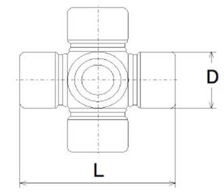

If you Google something like this
And search the images
Each image links to more
This is just one of the the first one that came up on a Google search, I know nothing about the company
That mention the correct propshaft 55222107, just be careful there not all for the 169
Must be a generic part, no panda 169 were ever fitted with circlips, as in the pictures

I suspect, if you take the old one out and measure
You will be able to find one much cheaper
Probably under £20 including shipping
There only appears to be a few different sizes and a few manufactures

Thanks I'll try that, hopefully a Vernier will be accurate enough 🤞
