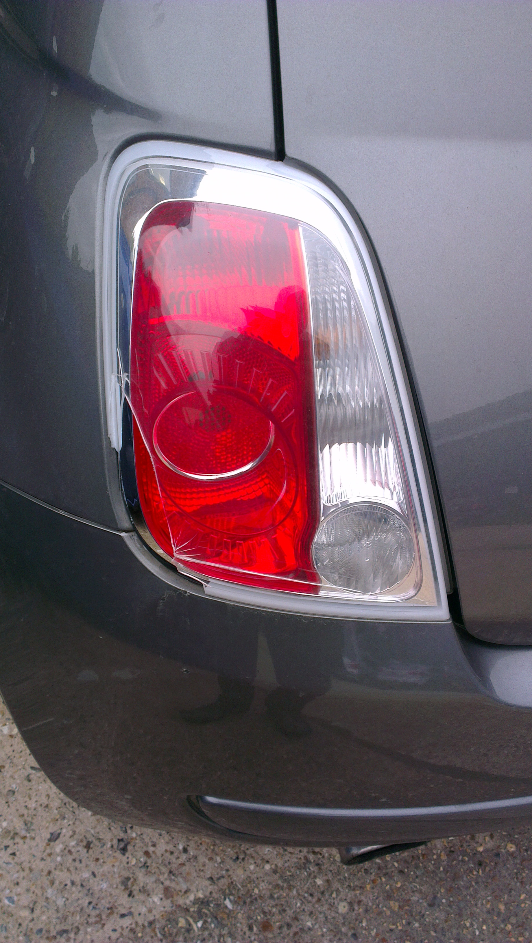

How do I replace the lens of the passenger side rear light? Some toe rag broke the rear light lens when I was parked in a retail park. I can get the whole assembly (which I don't think I will need) for about £46.00 delivered. Fiat charge £73.00 for this!!
If it just the lens, then it will cost about £15.00.
Has anyone replaced this before? I am not sure how to go about it as I do not want to break something else in the process.
Any suggestions would be most appreciated.
cheers.

The rear lens is a very quick job to do. Open boot and you will see tow 10mm nuts, undo these. There are no bolts on the outer edge, the unit has two plastic lugs that fit into rubber sleeves. Keep the light staright and give it a couple of tugs and they will just pull out, if they are sticking try to squirt a bit of wd40 and this will help them slide out. Disconnect the wiring multi plug wich is held on by a little tab. Unclip bulb holder. Fitting the new one is reverse of this. You should have this job done in 10mins.(y)

Fitting the whole cluster took less than 10 minutes and was as described by cbdubs. :) The unit is a Taiwanese clone and I was not able to tell the difference in quality or fit other than the original had Fiat markings on the casing. I saved £27.00 which can't be bad in such economic climes.
