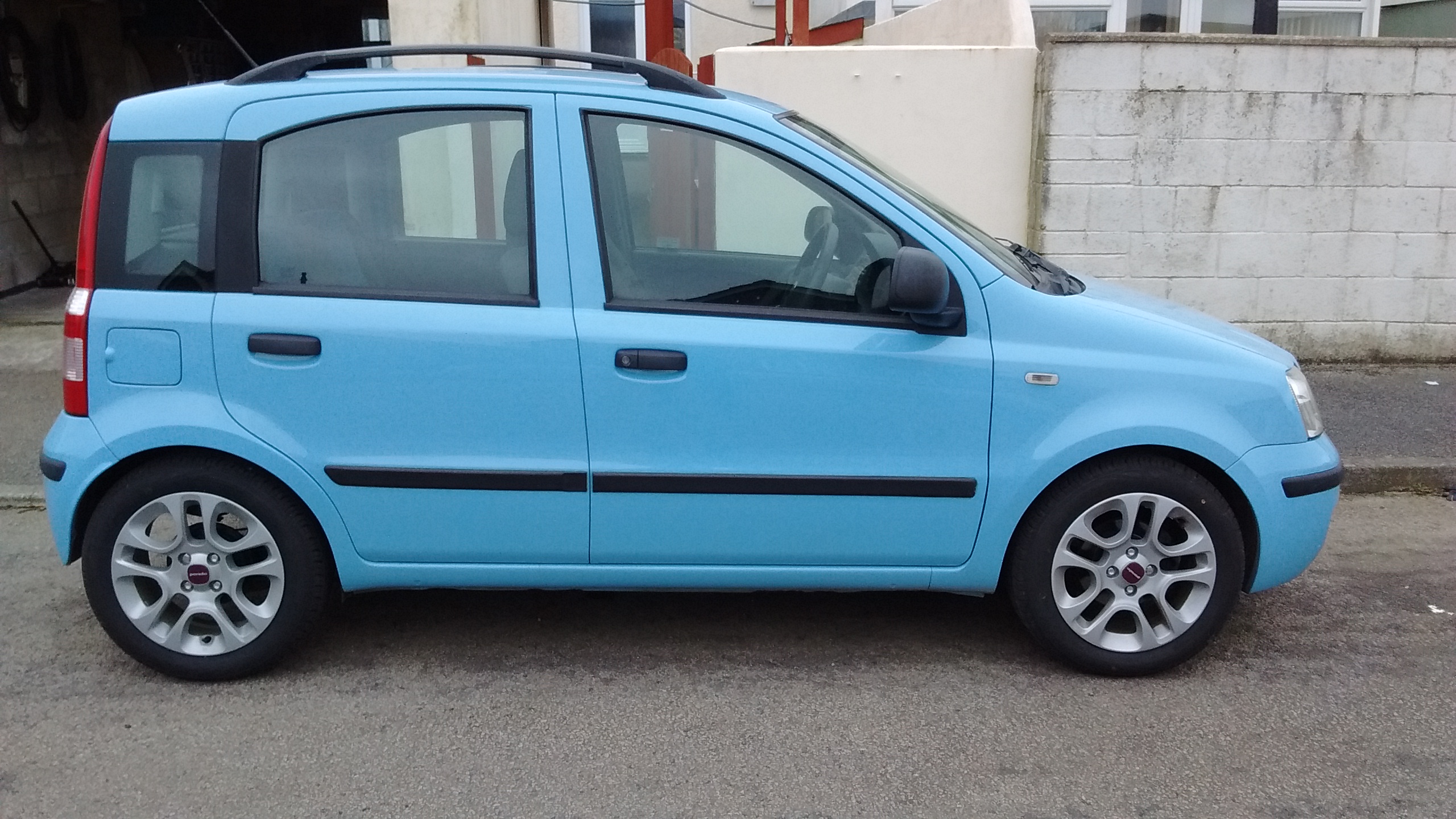

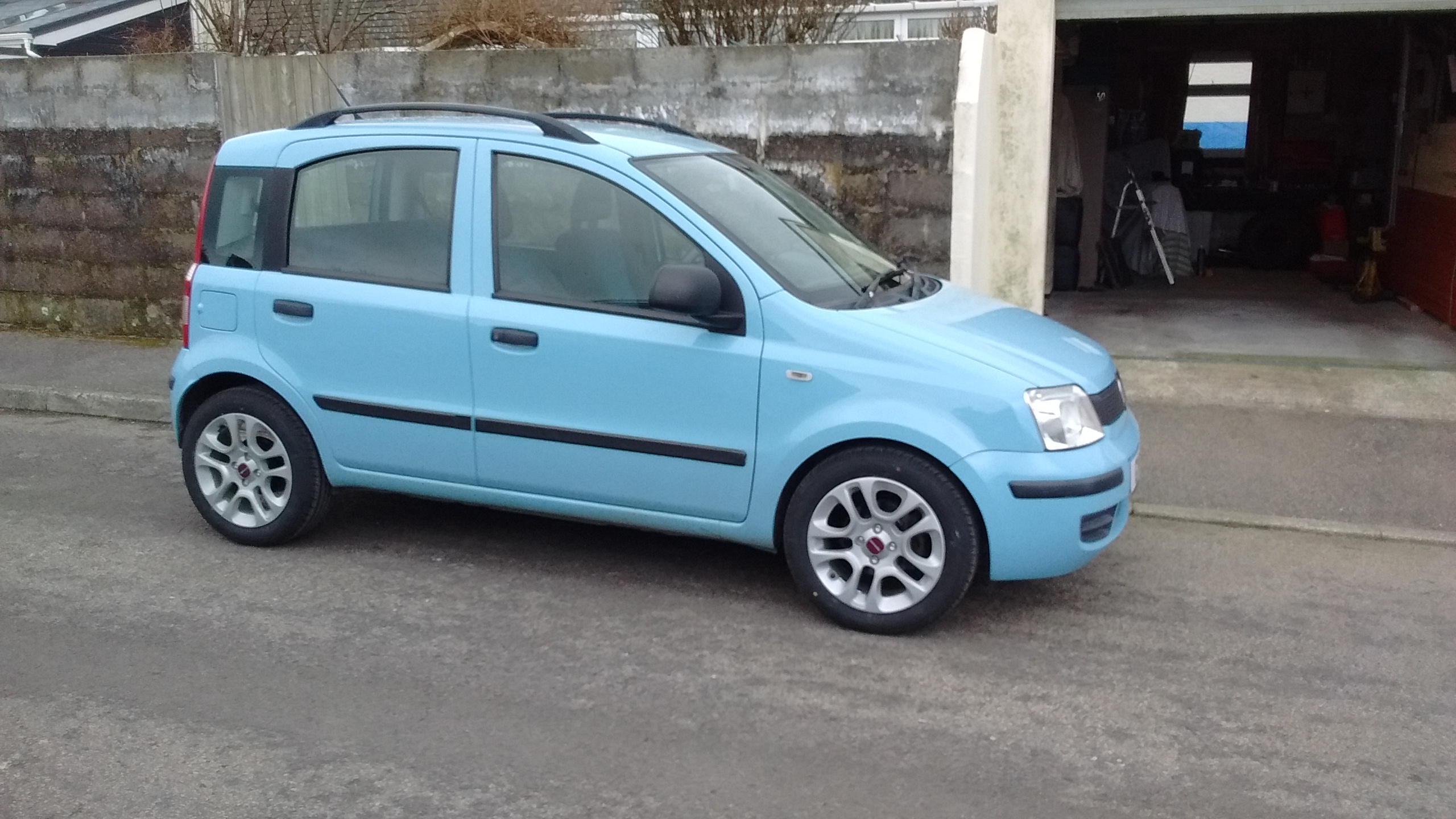

That's a very pretty car. Wheels looks lovely.
Thank you for your comments (y). Yes I'm delighted with it I purchased it with just 40,000 genuine miles on the clock. Besides the wheels I fitted the aftermarket roof bars which in my opinion enhances the little car, o.k. there's extra wind noise but isn't excessive, and I like anything that enhances the aesthetics.

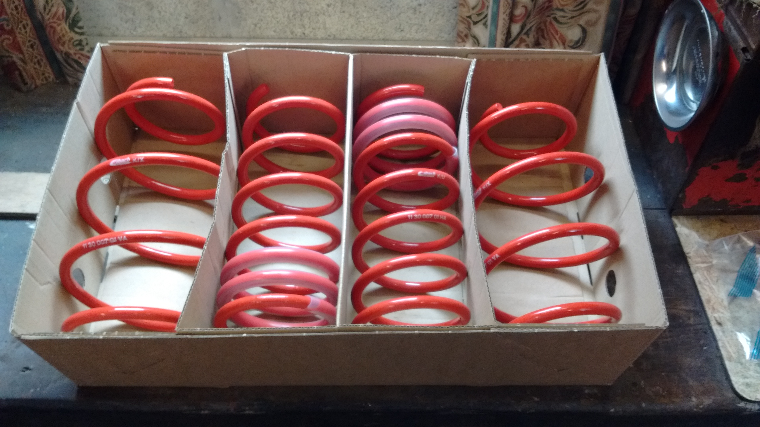

So today I removed original springs shocks & bump stops. Cleaned up and painted lower spring seats making sure drain holes were all clear, everything in excellent condition just a bit of surface rust. Fitted new Fiat Coupe, (shorter) bump stops not an easy task but with the aid of some WD-40 a long wooden lever and a rubber mallet they eventually went in, oh and also with the obligatory expletives :censored:. Next the new 30mm lower Eibach rear springs after replacing the original rubber cushions on the top of the springs, followed by the new shorter Stance shock absorbers, copper slipped all the 4x bolts before bolting everything up, re-fitted rear wheels and went for a test drive definitely a firmer ride which is exactly what I was expecting but gone is all the original banging and crashing from the rear.....delighted...:D Once I've purchased a pair of new shocks/legs for the front I will be fitting them along with new top mounts of course.....(y)
