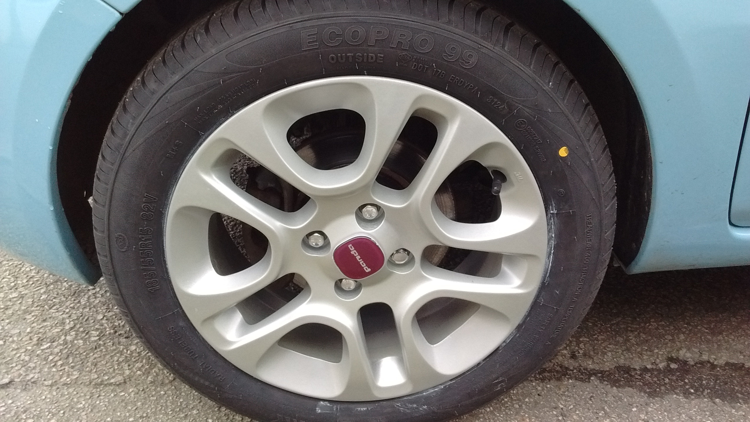

Hi I recently saw a set of 6J x15" Panda alloys with tyres on eBay a few of weeks ago, to be fair the guy did say the tyres were pretty much knackered and the wheels had a few kerb marks here and there some worse than others but all in all they looked pretty good in the pics, and all for £70 quid. So I bought them they only problem was the wheels were way up on the East coast some considerable distance from Cornwall and thus cost me more to get them transported down than what the wheels actually cost me initially.!!!
Anyhow they arrived and after getting the tyres removed I set about cleaning them up and refurbishing them. Once done gave them a couple of coats of primer including the inside of the rims because that's what you see when looking through the spokes + a couple top coats and lacquer. A new set of 185/55 R15 tyres pretty much a perfect match for the 155/80 r13 wheels & tyres, a new set of tapered wheel studs & matching lockers. Now all fitted to the car and IMO looking good. :) (y)

View attachment 460444Hi I recently saw a set of 6J x15" Panda alloys with tyres on eBay a few of weeks ago, to be fair the guy did say the tyres were pretty much knackered and the wheels had a few kerb marks here and there some worse than others but all in all they looked pretty good in the pics, and all for £70 quid. So I bought them they only problem was the wheels were way up on the East coast some considerable distance from Cornwall and thus cost me more to get them transported down than what the wheels actually cost me initially.!!!

You lucky so and so. Im looking for just that but have only found useless damaged wheels at over £100 each so far. I just need one. One pf the prettiest wheels around I think. Was it a private seller?
Actually yes & no he is a garage proprietor but selling on eBay as a private individual I guess not as a business, anyway yes i guess I was lucky to see it at the right time and clicked the buy it now tab.... (y)

Be aware that the tyre fitted is a summer tyre
The cross was normal fitted with 175/65 R15 on the same size rim

I've covered some 50 miles approx today since fitting the wheels with the new tyre's to my car and I have to say I can't detect any difference to the original wheels & tyres, certainly not any harsher ride by any means. The only difference it seems the new ones are a lot quieter despite the original tyre's being Continentals.?

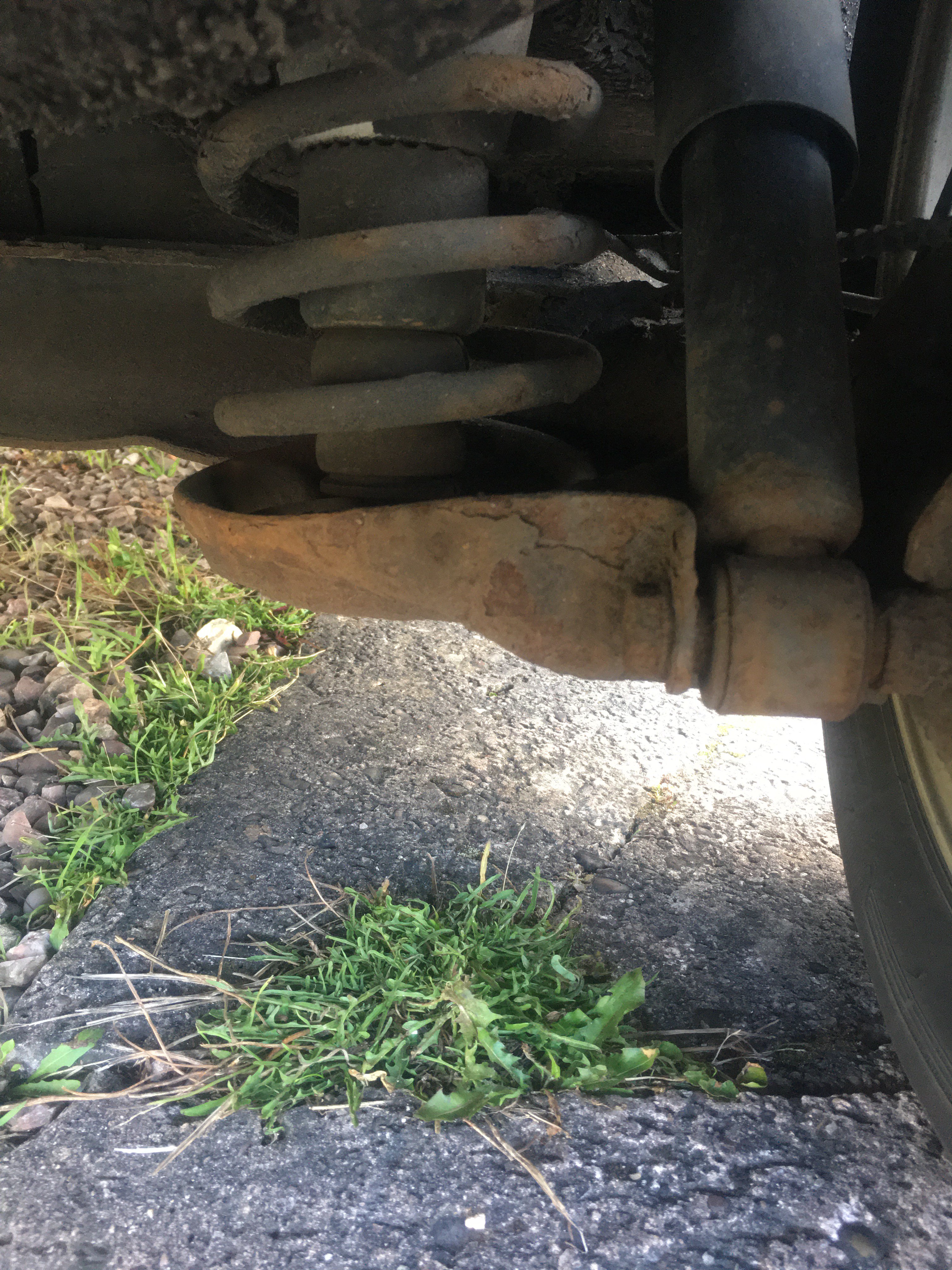

That axle spring pan is failing. You can see how stress is flaking the rust away inboard of the shock absorber bracket. It will even tally crack just there and you'll be stranded.
Mine was not this bad, so I got it grit blasted and zinc metal sprayed. It's not costly but you have to get the axle to the facility for the work to be done. Alternatively fit a replacement axle before this one lets you down.

That's my car, nothing to do with @Kernow 70 car
Used as an example of how ride height changes with weight in the rear, look at the gap to the bump stops in both pictures
Surface rust and paint flaking
Lasted another 2 years, out lasted the car
No it does not need a new axle
Mine was similar but less flaking rust. I had it metal sprayed and it looks today just as it did the day it went back on. Plus some road dirt of course but no rust stain and no flaking.
The wife's axle was extremely thin in that area inboard of the shock bracket and one side was starting to sag. It was repairable but really not worth the effort. I painted the new axle (not cheap stuff either) but that paint has not lasted well. A wire brush and squirt of lanolin will have to do.

Park somewhere flat, If from the ground to the top of the wheel arch measure roughly the the same each side, I wouldn't bother, a bit of surface rust is fine
