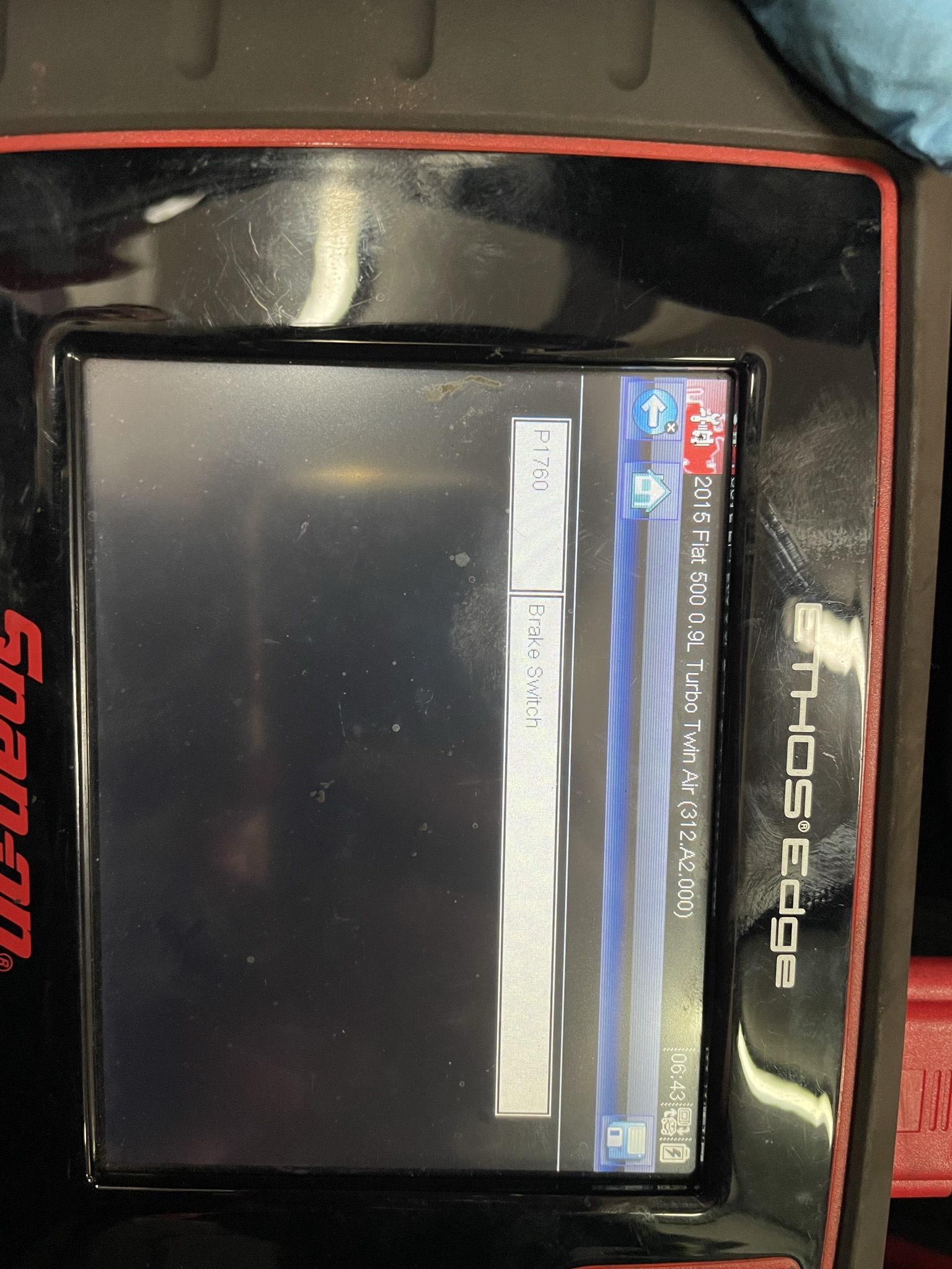

My Fiat500C Semi-Automatic 2015 is still showing P1760 brake switch circuit fault code.
I bought The brake switch 46840510 on Amazon asked my local garage replace it. However, it still showing the transmission Error ( computer shows P1760 brake switch code) .
Garage charge labor cost £54.00 for it but the problem still there. The garage said my part is not original cause the problem.

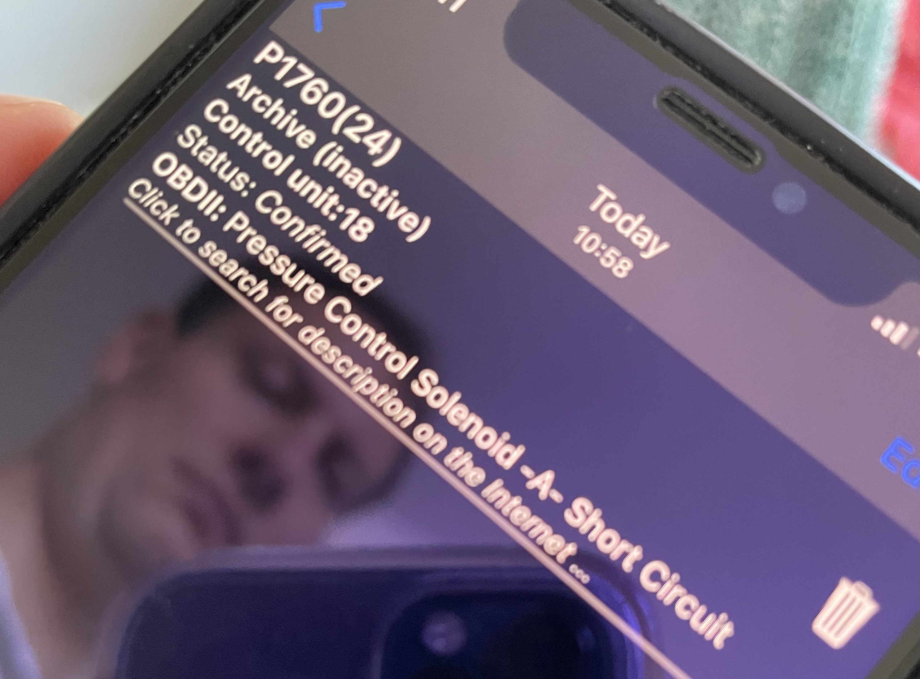

P1760 code showed as attached. I think press pedal up to check is a good idea. Thank you!
