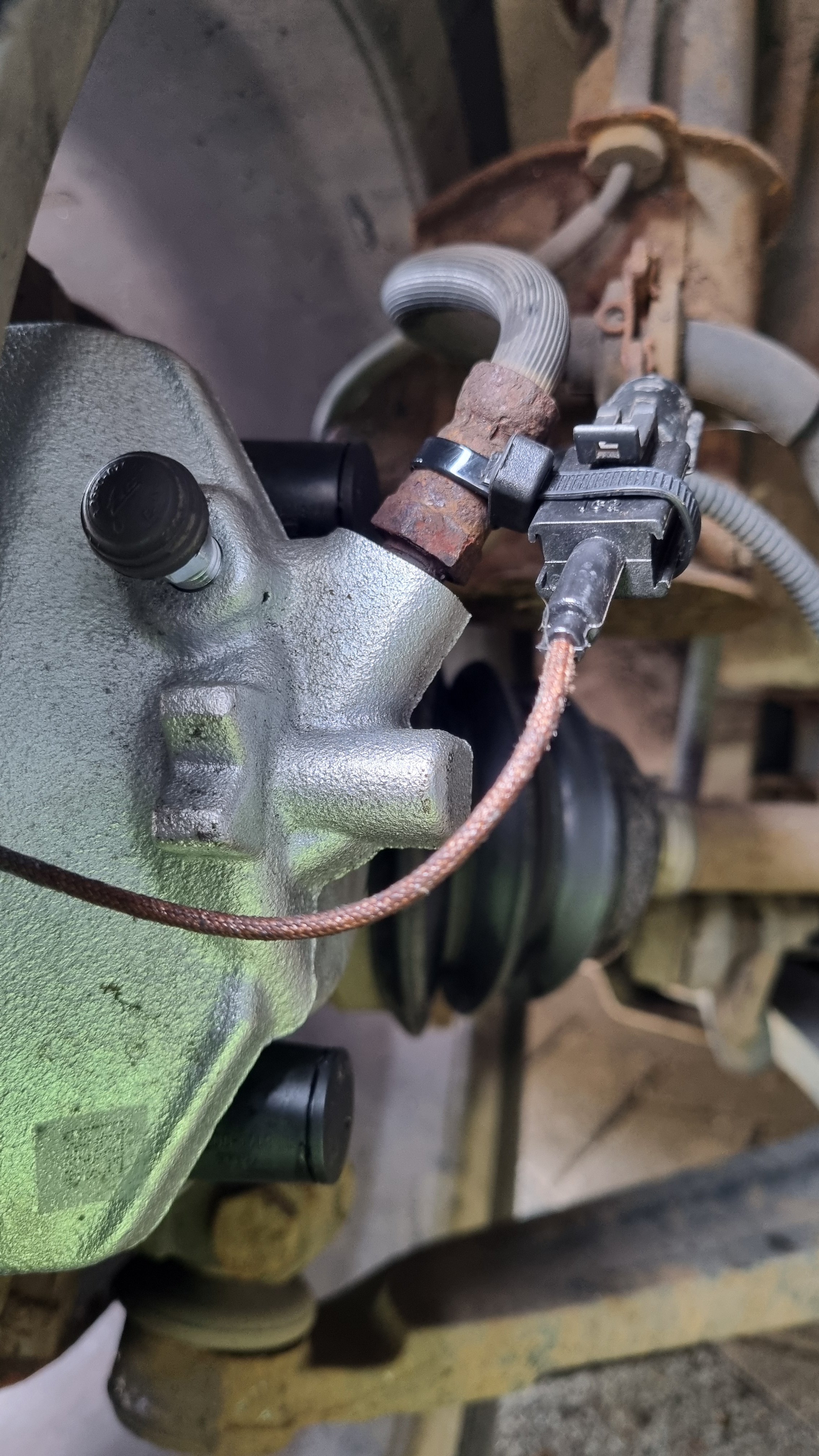

Earlier I replaced the offside caliper on our 2011 500 T/A and the caliper I got didn't have the bracket for the pad wiring plug. Nor was there a threaded hole. So, l got creative with some double cable ties I had...

As long as there is no other more serious differences between the two calipers.
Turns out it was different which I completely missed in my haste to get it sorted.
It was, in fact slightly wider for a vented disc.
Rest assured, the correct one has now been fitted.
And I hang my head in shame.
