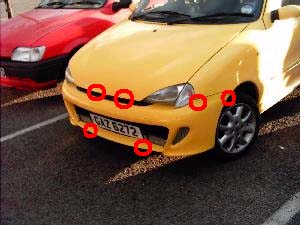

there 8 of them torx screws
you can pull away the arch lining on the sei but if you like hands with skins on dont do it that way

I have a pic of where all the bumper mounts are if that halps you, think thats your car actually innit Gaz. Although i might add i managed to paint mine on the car. Mask carefully round the bottom of the strip, open the bonnet and you can mask up the top edge easy enough, i then used a combination of cling-film, newpaper and masking tape to cover the headlights and then got it painted. Don't forget to put several coats of good strong lacquer on as well or you'll get lots of nasty noticeable chips in it really quickly ;)

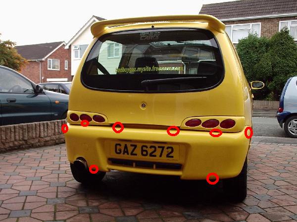

Anyways, bumper mounts are here:
