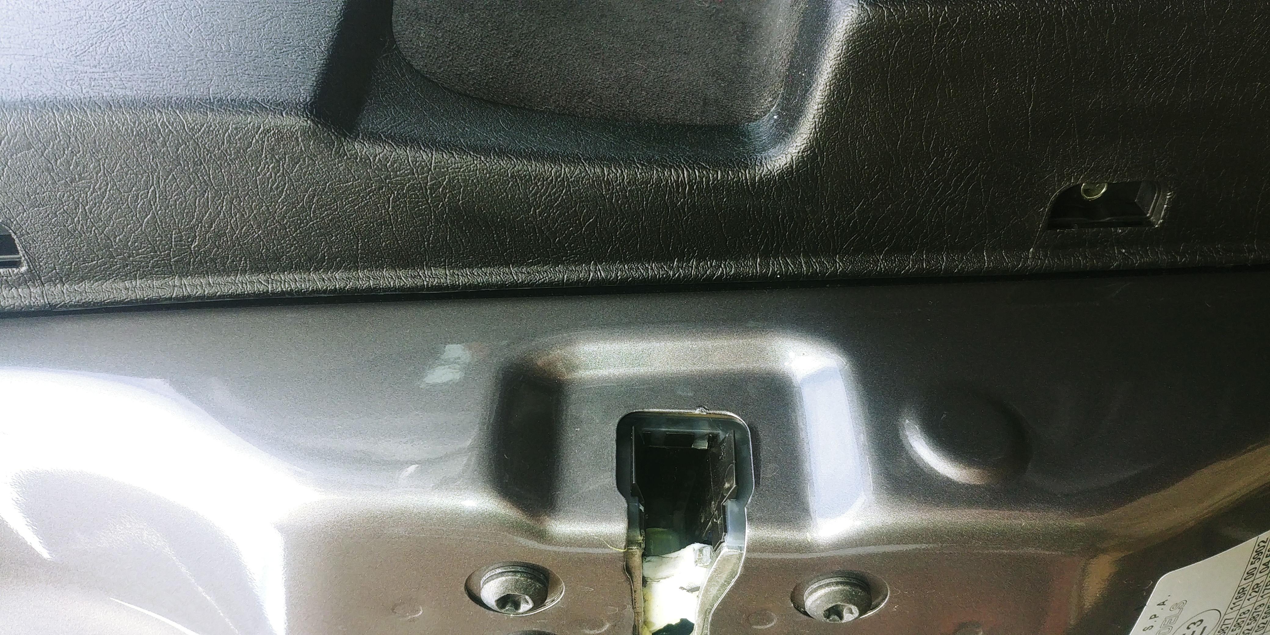

with the fixings out of way there’s just a few plastic press stud type fixing on the bottom half of the door so get you hand underneath the bottom corner and give it a sharp tug then work your way around until they have all been released
forgot to take pic of this part
Finally with the bottom fixing removed give the bottom of the panel a knock upwards to un hook the top from the window area and finally the whole panel should then be able to be lifted up
