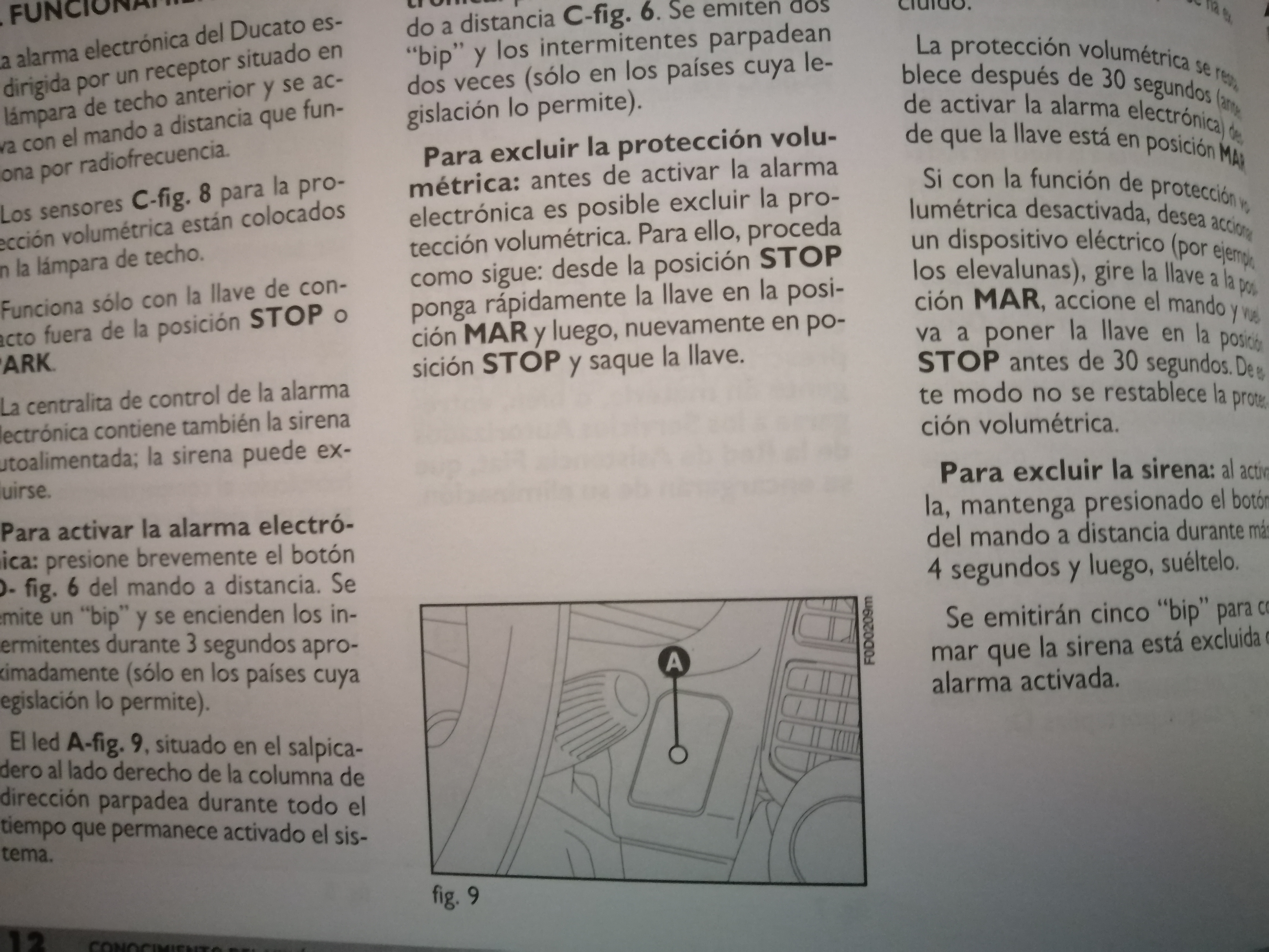

I've acquired a Spanish handbook and lo and behold the light in question is part of the Fiat alarm system!!
