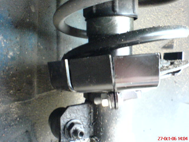

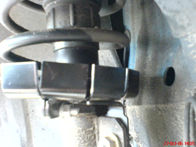

Evening Guys And Gals,
While I Had The Wheels Off Today Thought I'd Take Some Piccys, They Are Attached If You're Interested.

YES I AGREE,
I FITTED MY REAR EIBACHS TODAY, JUST TO GOT TO GET THE FRONT ONES DONE NOW.
I AGREE THOUGHT IT LOOKED BACKWARDS BUT IS THE SAME AS THE PREVIOUS PHOTO POSTED:confused:
Or maybe its the case that the fitting instuctions only come in brail because it would appear its a case of the blind leading the blind :rolleyes:
