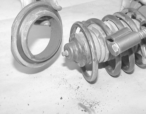

If anyone is interested I had almost exactly the same thing happen to my recently deceased Tipo.
It didn't have the mechano mod so the spring pierced the tyre :bang:
My Eibachs have arrived and I can spot not sign of taper on the springs (i've not seen those on the mine properly as they're still on the car).
"Are you suggesting the springs should be held static within their mounts and that problems occur on some Stilos when the spring slips OR are you suggesting the springs should be free to rotate in their mounts and problem occur when they can’t?"
BOTH!
If the spring was held, unable to rotate at top and bottom then the spring would flex radially when you turn the steering and return to where it was when you straightened up, no problem we would hope
If the spring is allowed to slip (either top or bottom) then it needs to be allowed to slip back again. If it doesn't then you have a wound up spring in need of some rest and relaxation which it takes as soon as it can. That's the creaking noise I reckon when you go over a bump, the spring takes it's chance to straighten back up, often just after the rise when going over a hump as that's when the spring is at least compression
"The notion that creaking suspension could act as an early warning of potential spring failure could certainly prove very useful".
I didn't suggest the amount of creaking is an indication that the spring is imminently going to snap, it isn't the spring itself that's creaking, it's the contact between the spring and the upper support that makes the noise and that's just straightening itself out- so no problem. Some might be noisier than others, it makes no difference. What I'm saying is that I think it's the radial winding up of the spring added to the compression of going over a bump that puts probably twice the extra load on the spring
It's difficult to see what's actually happening on the road when the spring is under compression because if you jack the car up the spring is relaxed. That's why people had trouble finding the source of the creak when the car was raised but they knew that if they prayed the upper mount liberally the creak would go
Either way, the spring can't take the strain, probably due to a combination of fatigue and stress and eventually snaps.

However, due to impending legal action, I cannot post the results of this analysis on the forum, but to confirm or dismiss the many theories on this thread, I can say that the failure of this spring was definitely due to corrosion, however, it is also related to another major factor in the manufacture of these springs.
I am confused now, are you saying Phil that the corrosion was already in the metal during manufacture? Bombay says that corrosion is the cause of the failure, but obviously the cause of the corrosion is due to the manufacturing process itself, or, we wouldnt in Phils words be miles off from the truth. Also from what Phil says the fault is on new springs as well as old, maybe Phil has given more info here than he should.
