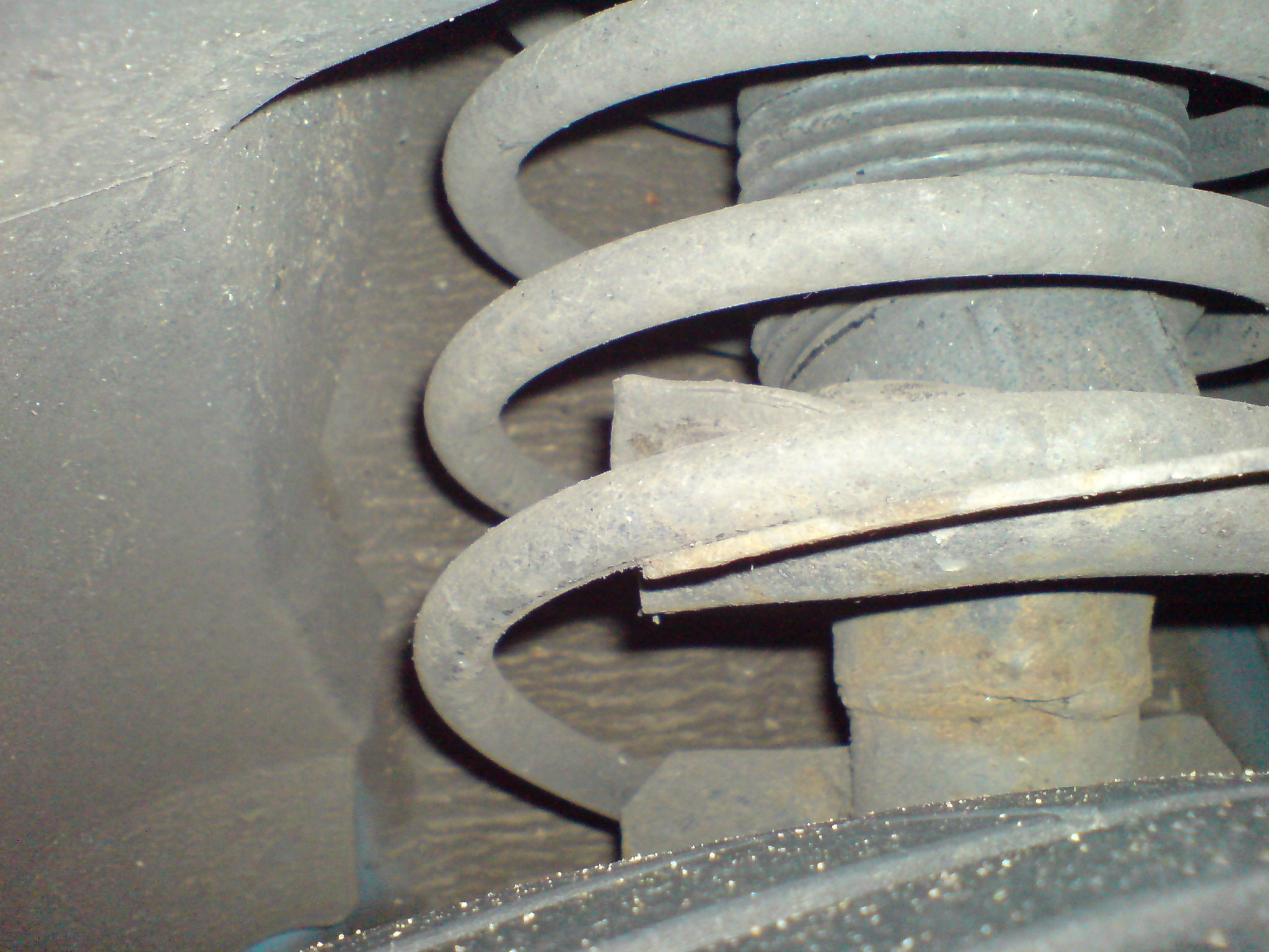

Are you going for the Pro Kit with 30mm drop all round?....I've bitten the bullet and ordered the Eibachs. Hopefully this solve the problem and also improve the body roll in the corners.
I think that would be my choice![]()
Where'd he go?![]()
Where'd you get them Cris?

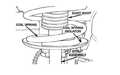

Many very good points made there Decks,Let's not forget that the front suspension has to turn as well as go up and down, of course. Now imagine you have a suspension spring in your hands, twist the spring up by turning the ends of the spring in the same direction as the coils and it's not much problem, now turn in the opposite direction and it doesn't like it at all as you are turning the coil back on itself
Now imagine the spring turned back on itself and it hasn't had chance to straighten back up again because it doesn't turn freely in the spring cup, now you go over a bump, spring extended outwards and compressed at the same time. It really doesn't like that!
