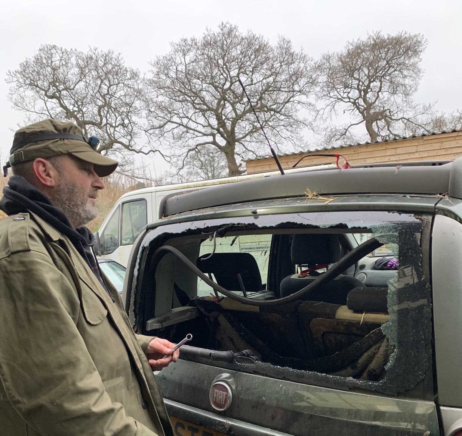

My old 169 panda cross rear wiper only worked as intermittent…unless applying windscreen wash and stayed on continuous as long as you were using the wash…I don’t know if this is an aboration but, wehn I swapped out the rear hatch, for a used standard panda one (the wife reversed into a tree branch and it was a pig of a job) I didn’t notice any change in wiring numbers or colours, which suggests some motors are continuous, some intermittent and not reliant on a separate relay
